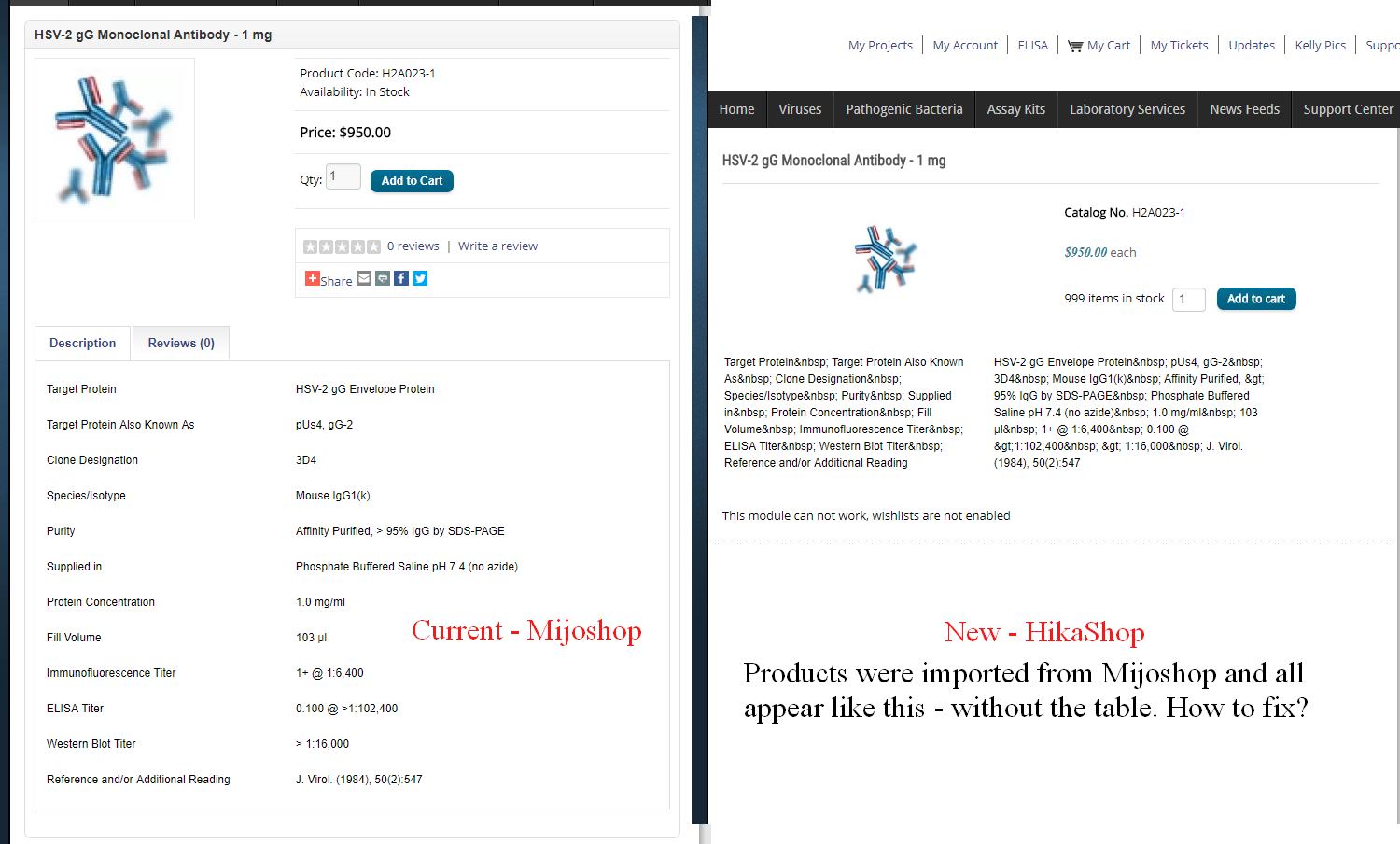

I'm trying to resolve an import problem from MijoShop.
The import script is stripping the <p> tags from the product description and replacing them with " " .
It is messing up the table structure as seen in this side-by-side image. How can I fix this?

I've just checked the code importing the data from MijoShop and the description data is imported "as is" from the MijoShop table during the import. So I don't see why it would do that.
I would recommend to check the data corresponding to that product in the table __mijoshop_product_description in the column "description" via phpmyadmin. Normally, it should be the same as the data in the product_description column of the table hikashop_product after the import is done.
The code doing the import of the main data of the products including the description is :
in the file administrator/components/com_hikashop/helpers/import/mijo.php

I checked the tables and found differences - they aren't the same.
I have found a little bit of a workaround in correcting these things but it still involves editing each product. At this point, it's a necessary evil.
