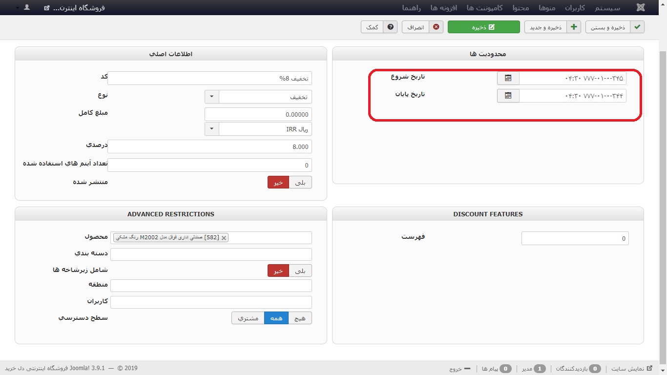

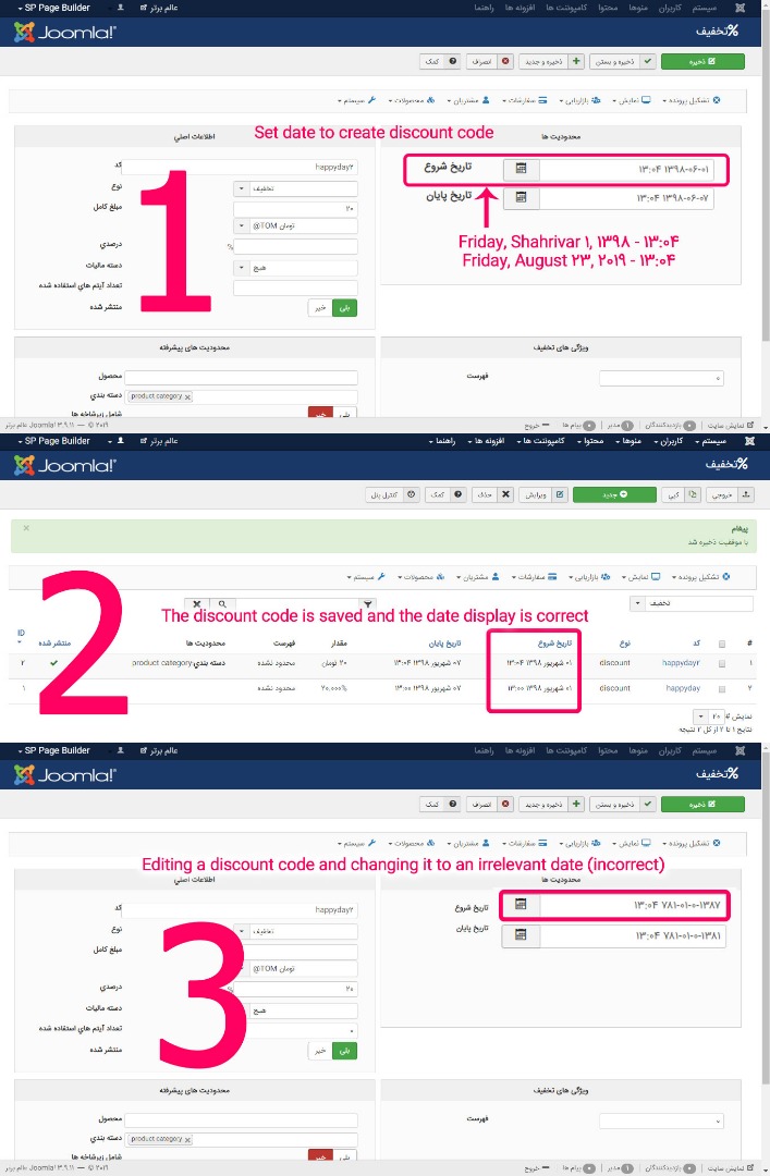

I think about the discount code with the image I have attached and the description on the image so you can see what the problem is.

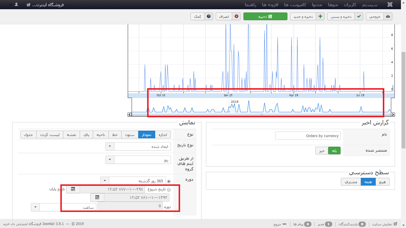

There are two problems with the reporting section.
1- In the charts, the date is displayed in AD. (Not Farsi)
2- In the settings section of the report, there is a Persian date, but it is displayed incorrectly. (Like discount code)
But let's put everything in CSV in the next post.
Yes! Sure.
