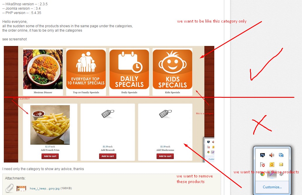

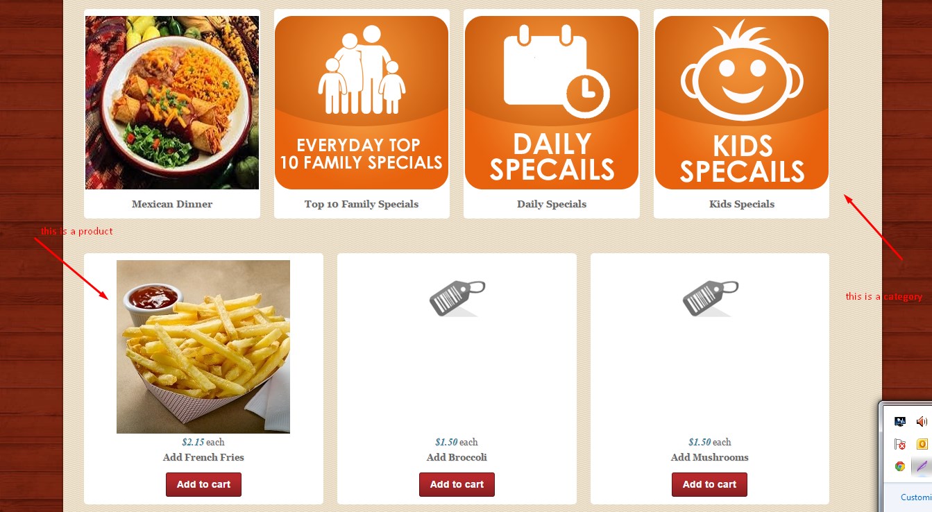

Hello everyone,
all the sudden some of the products shows in the same page under the categories,
the order online, it has to be only all the categories
see screenshot
I need only the category to show any advice, thanks
  • Posts: 2143
  • Thank you received: 747
11 years 5 months ago #193053
Hi again,
In category listing configurations (remember, where you also set number of columns), in the module for the "Associated module" below please set the option "Sub elements filter" to "Direct sub elements".
And please make sure that only (sub)categories are assigned to products (not parent categories).

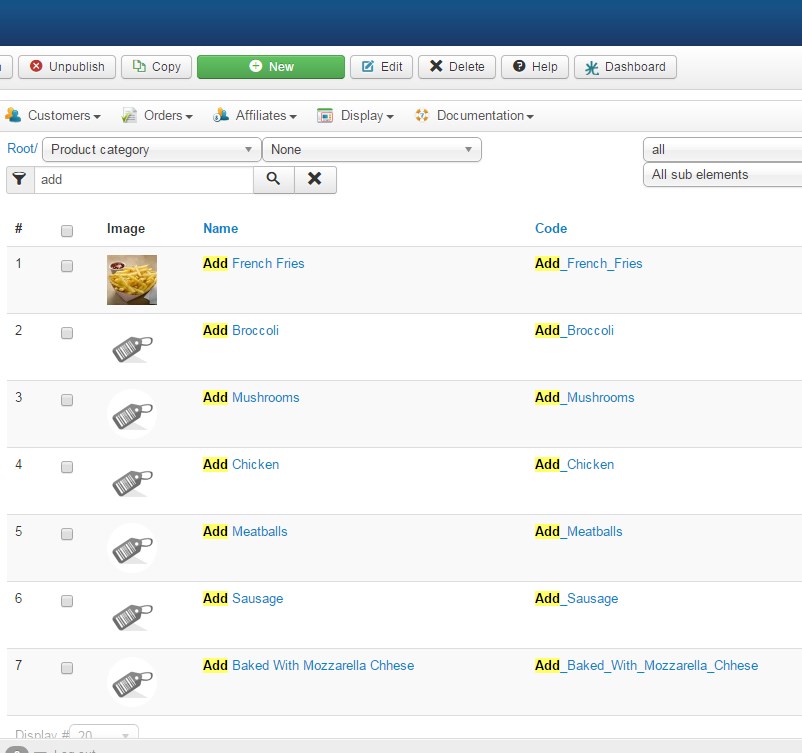

  • Posts: 154
11 years 5 months ago #193162
Hello everyone,
Jerome you don't have to answer this i have your answer already. Thanks!
as i mention in my posting we have some few items was added as a products and used as an option after that, when we did category listing , under the all categories yes products showed up, which is make it looks ODD
here you go the products we added and because we added it as an option to the main product it shows under the category listing even its a product and it shouldn't be there
any help appreciated,
again Jerome you don't have to answer this question

  • Posts: 2143
11 years 5 months ago #193302
In addition to you setting the "Sub elements filter" correctly, let me emphasise the categorisation of products:
Which category is assigned to your "Add" products/options? If it's a parent category - worst case "Product category" - it's a bad idea to put them there... they should rather be in a different (separate?) category.
For as long as they're in a parent category, they will - of course - be displayed below a category listing, even if you set the parameter "Sub elements filter" to "Direct sub elements", because that's exactly what they are: direct sub elements of e.g. "Product category".
Once again (I just copy & paste): please make sure that only (sub)categories are assigned to products (not parent categories).

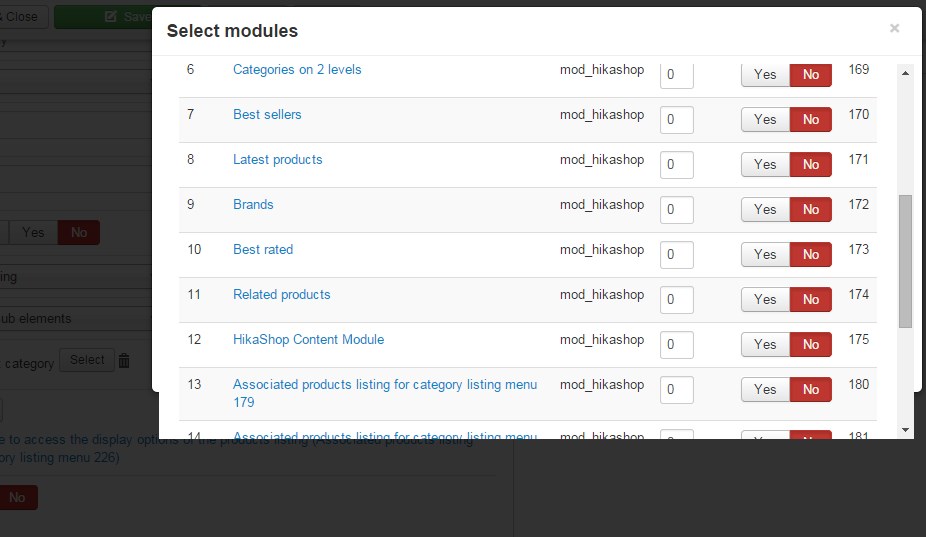

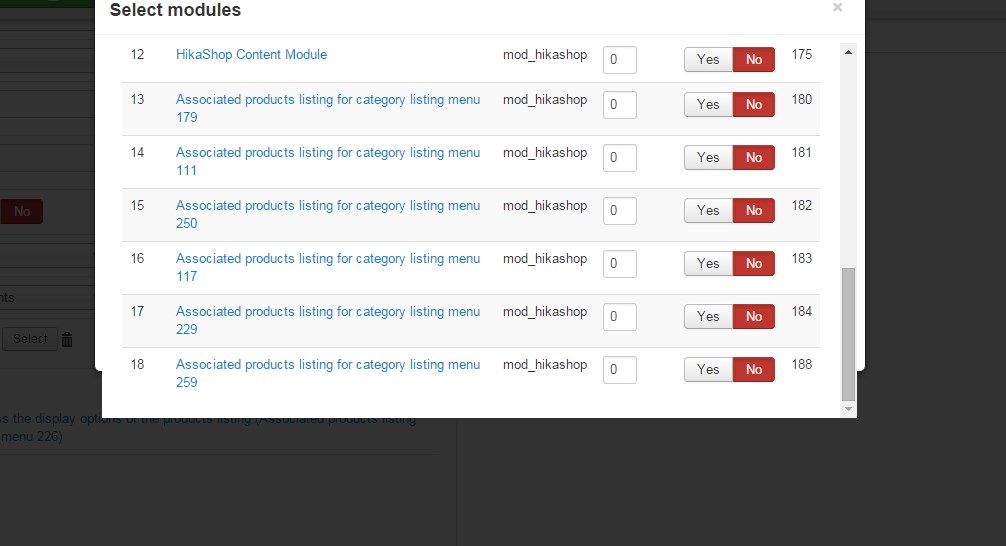

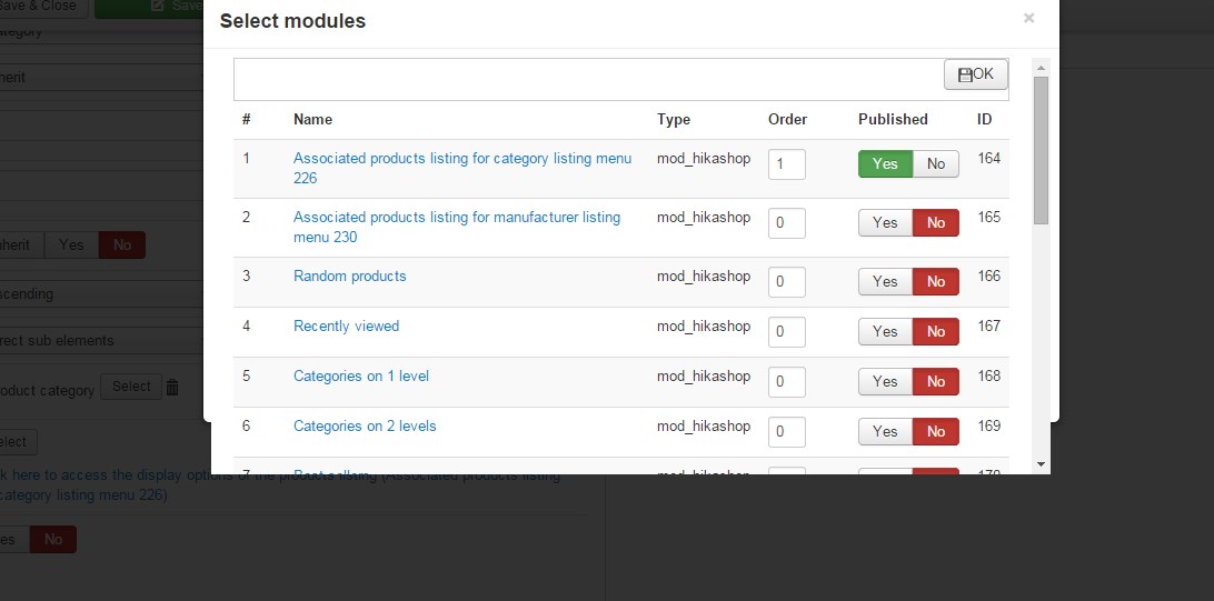

  • Posts: 154
11 years 5 months ago #193356
Hello Sir,
and thanks for the support,
I was not sure what really mean by that i have 3 screenshots, that shows the options that i have take a look and advice please
which on i have to choose, thanks

  • Posts: 2143
11 years 5 months ago #193362
habusam wrote: ... i have 3 screenshots ...
You probably had the correct module associated already, so that's not relevant here, plus the numbers of listing menus don't tell anyone but you anything, anyway.
It's the configuration of category listing and the associated module itself. So, to avoid going further in circles and us repeating ourselves, or you drifting off into a completely wrong direction, please go back to the beginning of this thread, follow suggestions and study: www.hikashop.com/support/support/documen...html#categories_menu
