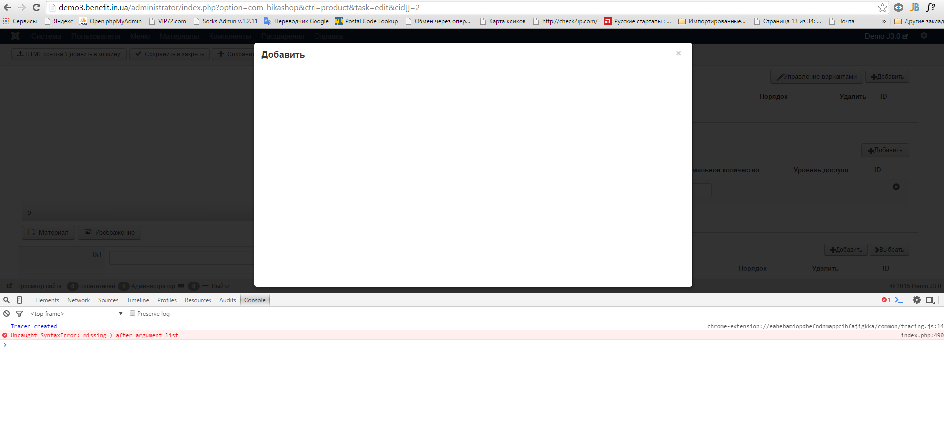

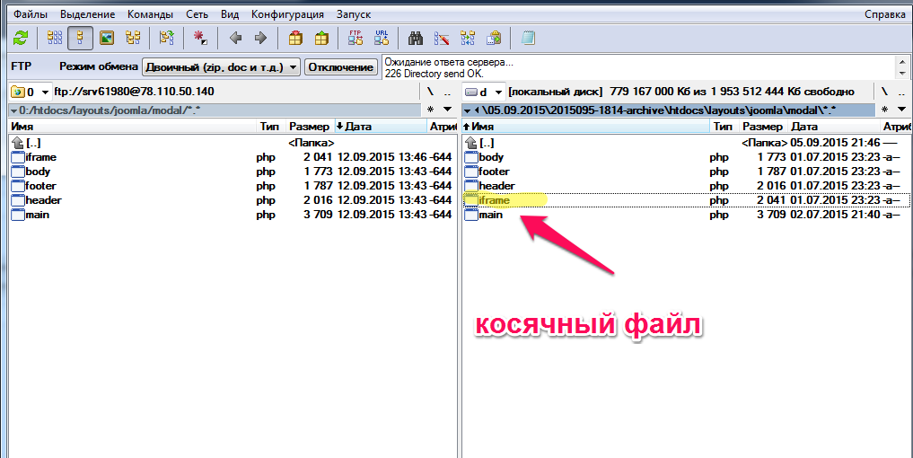

If I upgrading from 3.4.3 Joomla to 3.4.4 I have a bug in the "IMAGES AND FILES".
I can't delete images
the problem with iframe.php file
If I restore it from backup - it is ok.

10 years 11 months ago #214144
We don't have that problem on our end.
This indicates that there is a javascript error on the page. Open your browser's error console and look for the javascript error which appears for that page.
That should give more information in order to identify the problem.

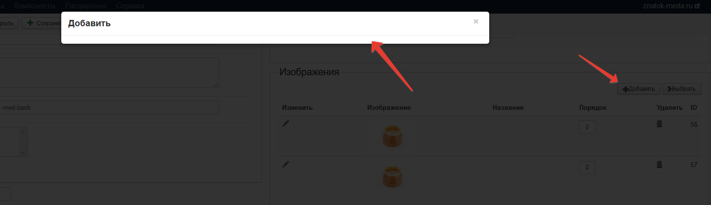

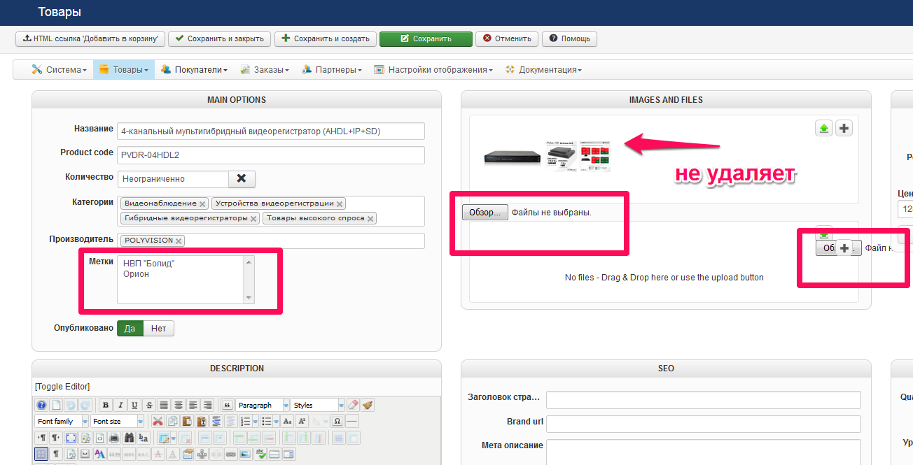

I have tested many sites and see that the problem with all versions of hikashop - 2.4.3 and 2.5.0 - all versions have problem after upgrading Joomla from 3.4.3 to 3.4.4
I have feedback from 4 customers that have the same problems.
Try to install hikashop on 3.4.3 Joomla and after that upgrade to 3.4.4
Here is screenshots:
Я здесь добровольно!
Last edit: 10 years 11 months ago by progreccor.

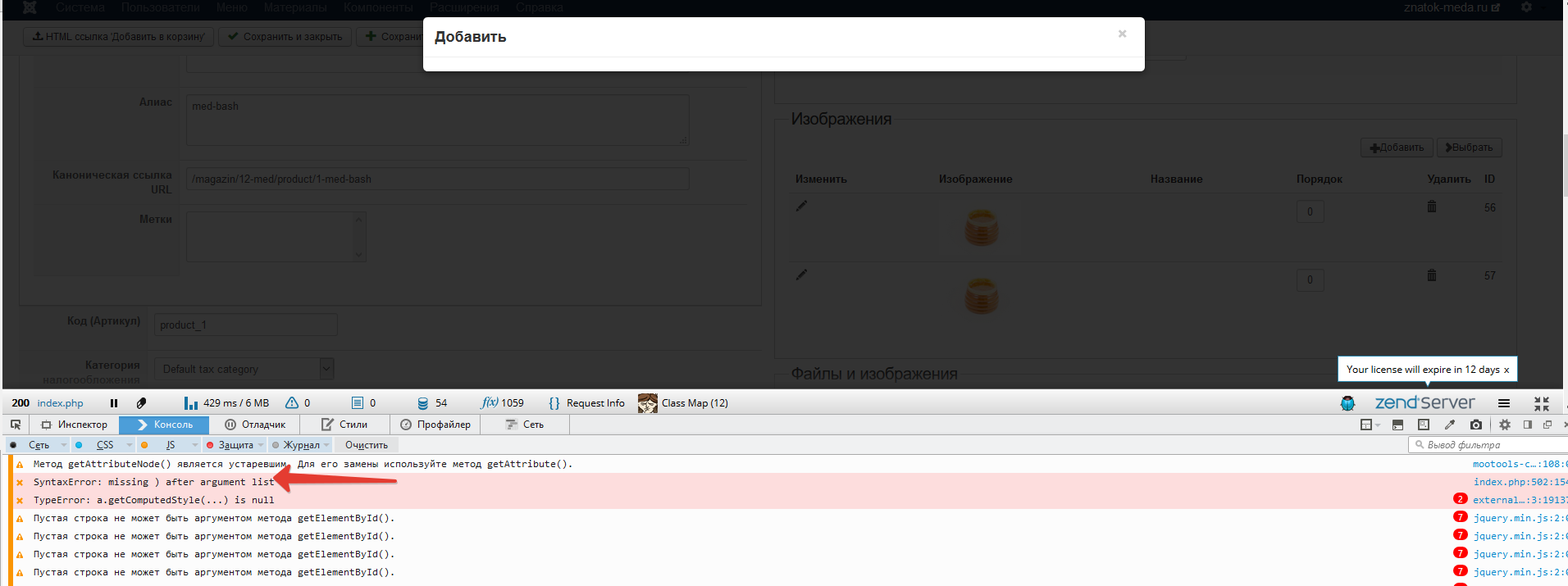

10 years 11 months ago #214211
here is from another site
  • Posts: 2293
  • Thank you received: 315
10 years 11 months ago #214212
this is really big problem. On all sites appears this problem

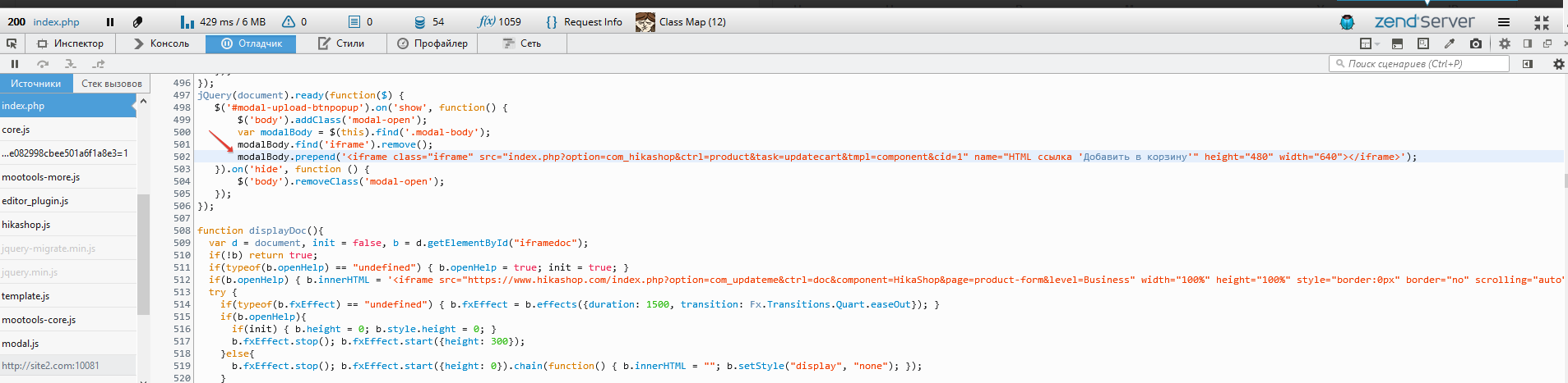

10 years 11 months ago #214218
I found the problem
Here is the trouble string:
Before:
ADD_TO_CART_HTML_CODE="HTML ссылка 'Добавить в корзину'"
After:
ADD_TO_CART_HTML_CODE="HTML ссылка - Добавить в корзину"
I think that problem was with apostrophe (') symbol.
So please change this line in Russian translation and it will fix the problem

10 years 11 months ago #214269
File "layouts/joomla/modal/main.php", replace:
$script[] = "       modalBody.prepend('" . trim($iframeHtml) . "');";
By
$script[] = "       modalBody.prepend('" . str_replace("'", "\'", trim($iframeHtml)) . "');";
The patch from the previous post avoid the javascript error but display a backslash in the button content.... Which is not very nice.
Edit
Instead of that patch, please apply the official patch (which won't have side effect on dynamic URL).
github.com/joomla/joomla-cms/pull/7845/files
Last edit: 10 years 10 months ago by nicolas.
