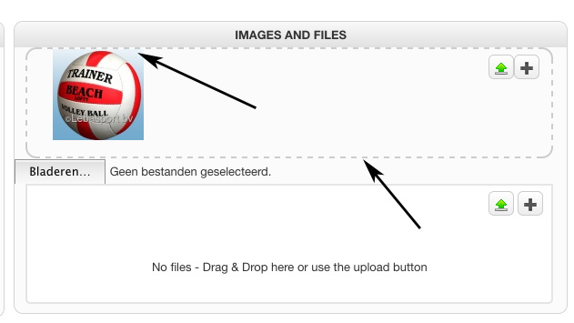

9 years 6 months ago #267726 by mariussport
-- Joomla version -- : 3.6.5
-- PHP version -- : 7.1
-- Error-message(debug-mod must be tuned on) -- : no

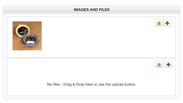

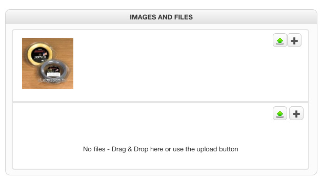

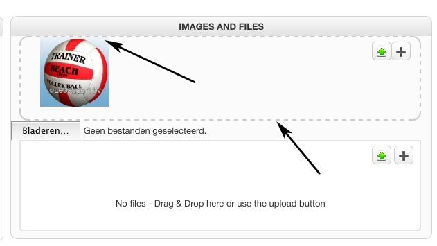

After a update on to v3.0.1_2017_04_18_18_18_29_44.zip The image div looks different with a stippled line around. Problem is that I can't remove the picture in the div.
see image of Hikashop v 3.01. before and update (every month) like is advised!
imag after update with piles.
best regards, Marius

9 years 6 months ago #267727 by Jerome
Please re-download HikaShop 3.0.1 in order to have the full patch.
During a small period, an uncompleted patch was present in the packages.
More
9 years 6 months ago #267730 by mariussport
Yes that works perfect!
thank you Jerome

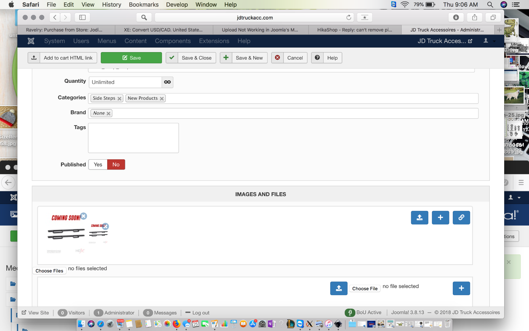

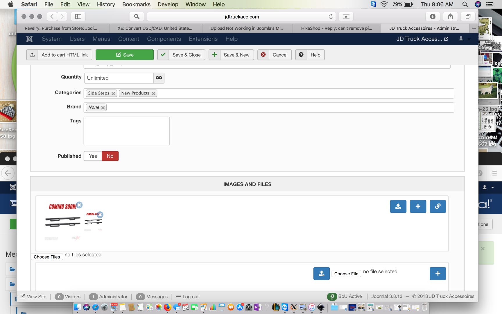

8 years 2 days ago #299557 by sarahshaw
Hi I am having the same issue I cannot delete or add new photos. I have followed the above instructions and still unable to do anything with the photos.

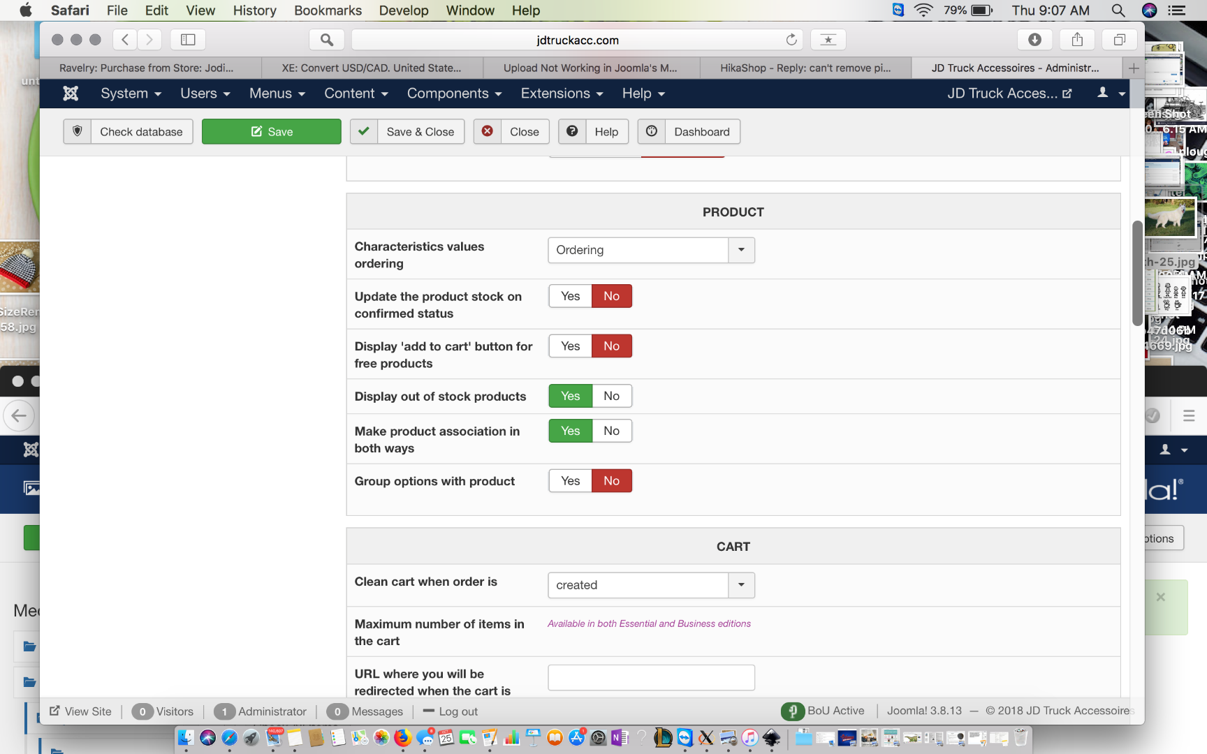

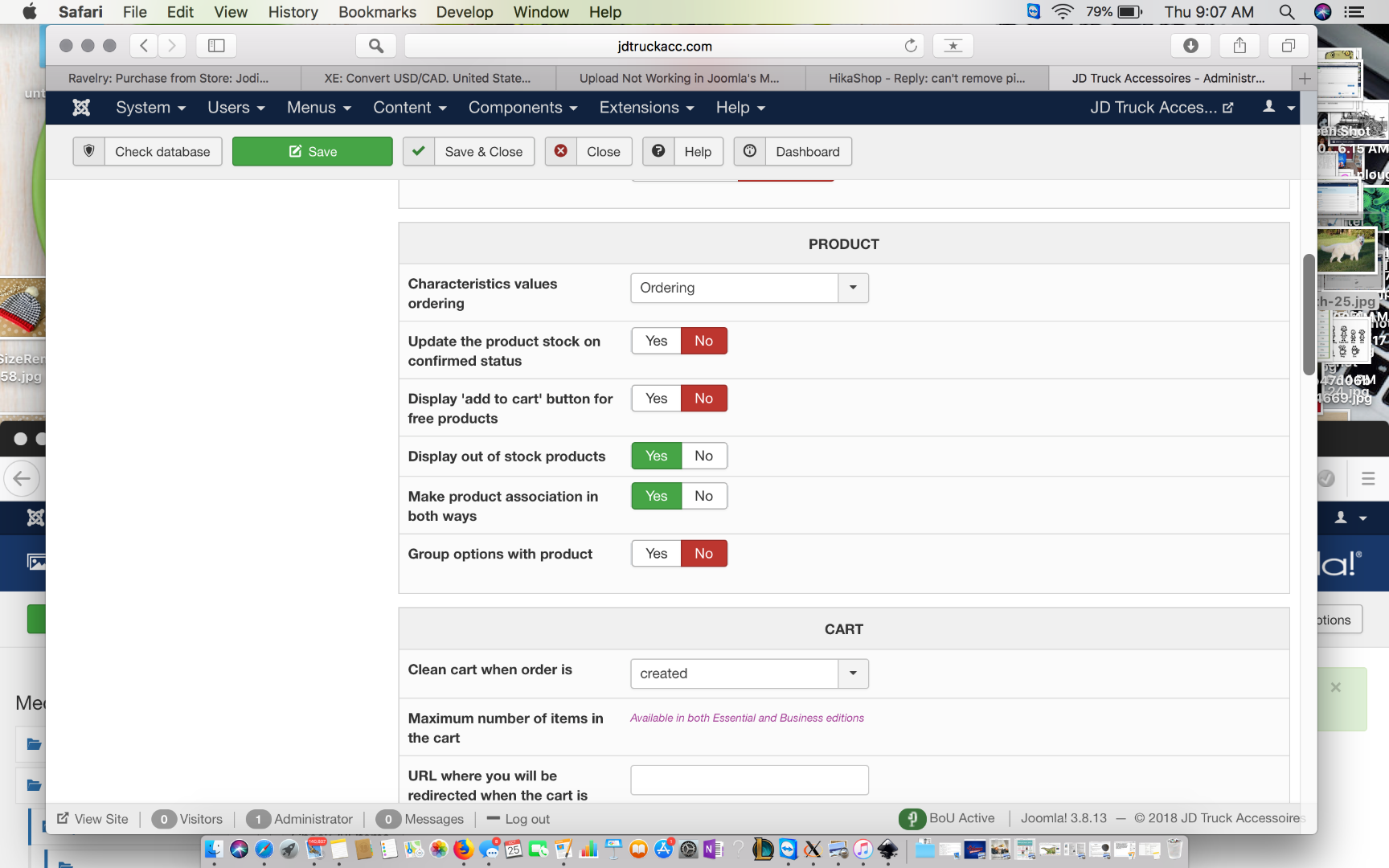

8 years 1 day ago #299559 by Mohamed Thelji
We'll need more information about your current version number that you can find through the "Version" option via "Hikashop->System->Configuration->Main", but also screenshots of :
- Your product configuration page
- Potential JavaScript error that you may also have through your product configuration page.
Thank you.
Kind regards,
Mohamed Thelji.

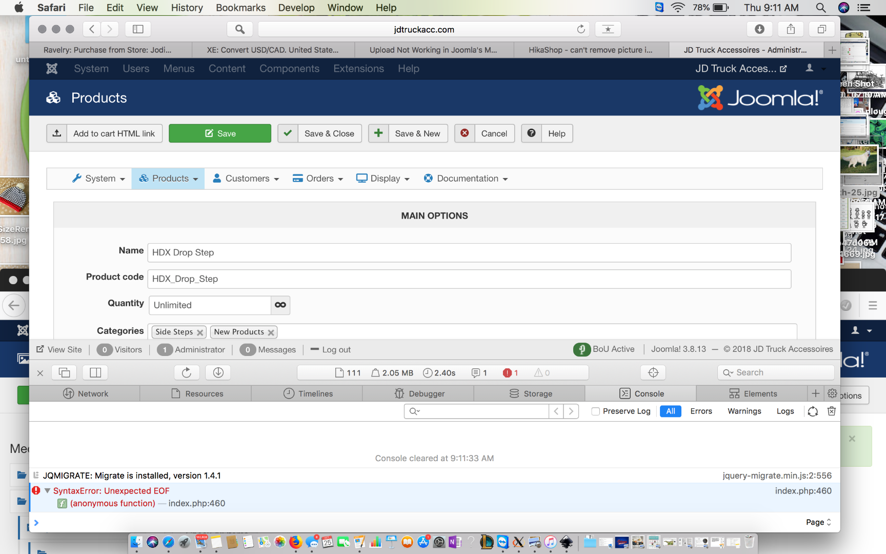

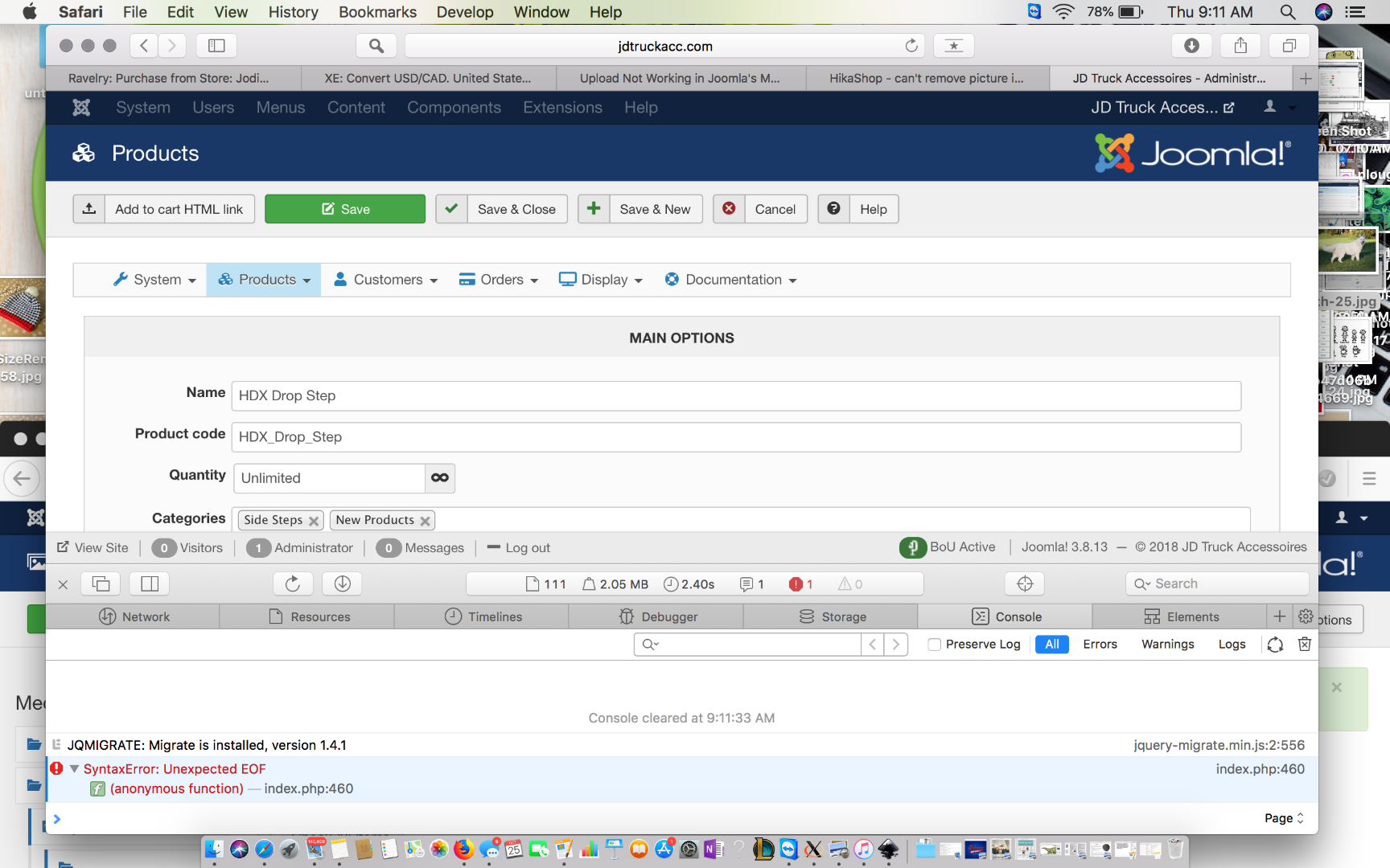

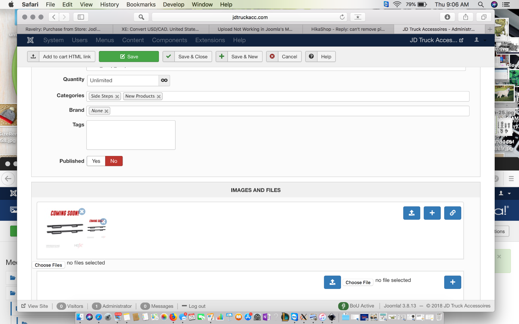

8 years 1 day ago - 8 years 1 day ago #299632 by sarahshaw
HikaShop Starter 4.0.0 [1810241141] and latest version of joomla
there is no response when I click on the x for the photos or any of the buttons to add new photos, I've checked for errors and found the one below
not sure what could be missing or if I have a setting wrong.
Thanks for any help you can give
Last edit: 8 years 1 day ago by sarahshaw. Reason: to add error
More

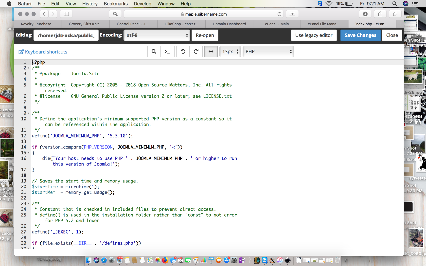

8 years 16 hours ago #299634 by Mohamed Thelji
Your issue is probably coming from your JavaScript error, so can you show us the code that you have through the "index.php" file near the line 460.

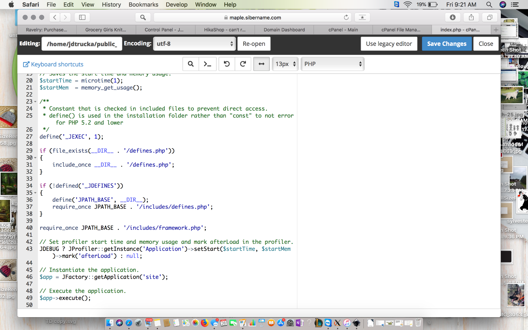

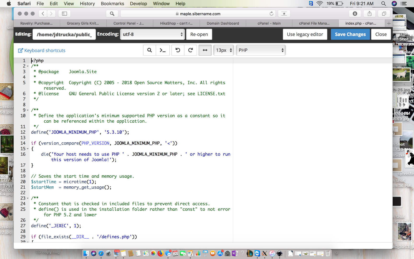

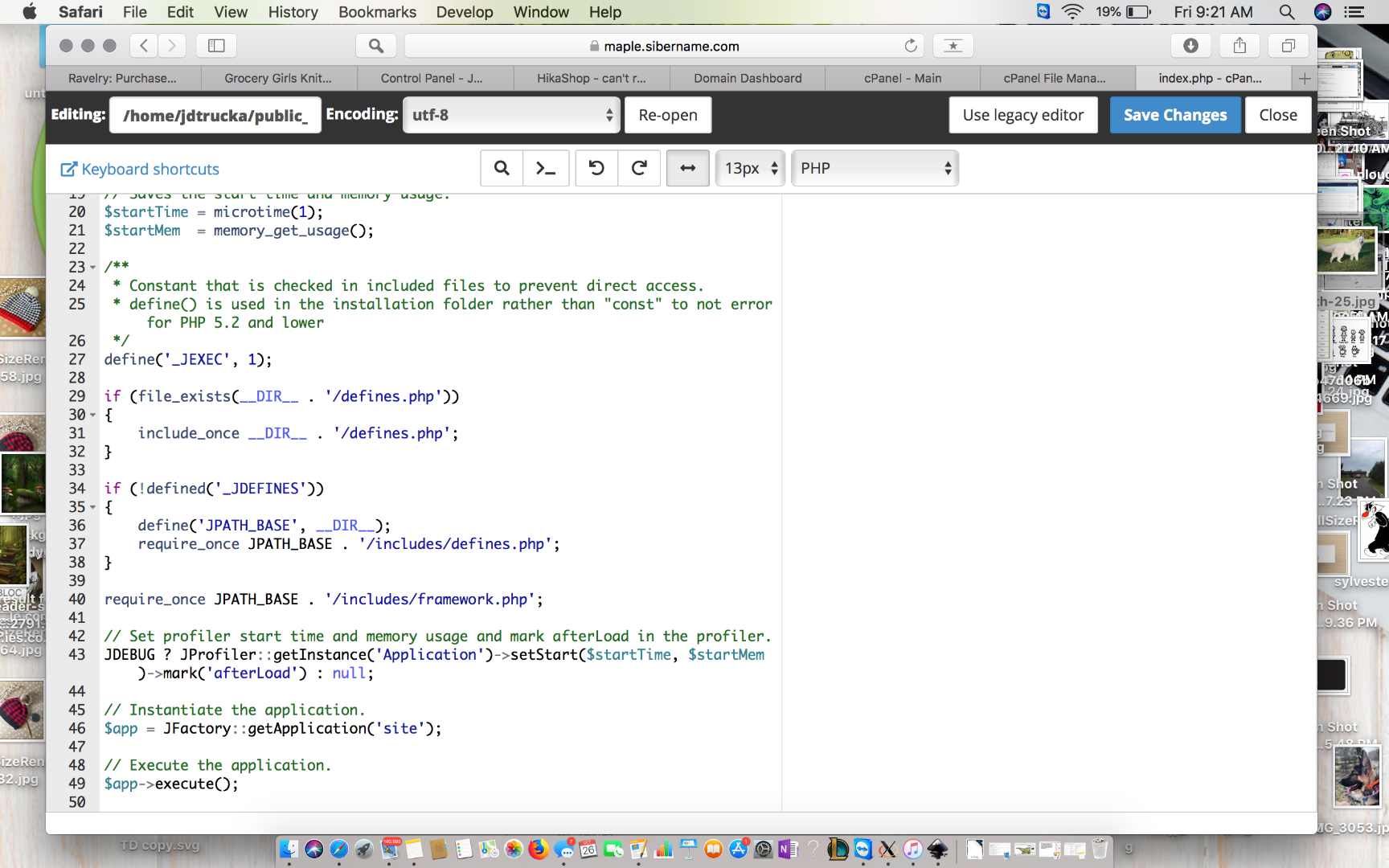

8 years 4 hours ago #299692 by sarahshaw
Thank you. I cannot locate line 460 in my index file here is a screen shot of my index file code

7 years 11 months ago #299694 by nicolas
No, you need to look at the HTML code of the page with your browser :
www.lifewire.com/view-html-source-in-safari-3469315
More

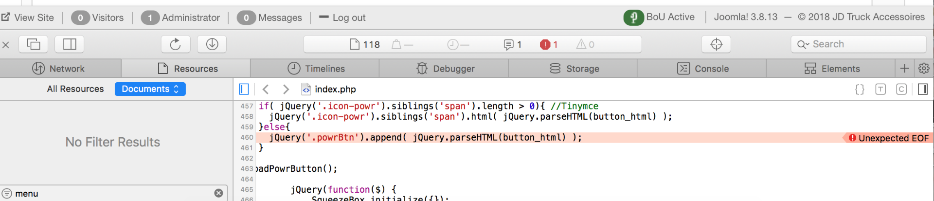

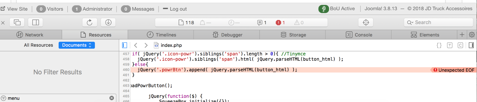

7 years 11 months ago #300074 by sarahshaw
Thank you. Here is what I found.
More
7 years 11 months ago #300079 by nicolas
Could you provide the full code of the index.php ? Because the error says that it was expecting the end of the javascript but there is new javascript after that line. So it indicates an error in the javascript before. Without the full code it's difficult to say which code in particular is the problem and thus provide a solution.

7 years 11 months ago #300341 by nicolas
From what I can see, the problem is with the POWr icon plugin which adds stuff to the tinyMCE editor and the javascript of that plugin creates the javascript error which prevents HikaShop's javascript from being initialized.
If I disable that plugin on your website it then works fine.
So if you can do without it, I would recommend disabling it. You can still manually add the tags of the POWr content plugin in your content as the processing of the tags on the frontend is handled by another plugin.

7 years 11 months ago #300421 by sarahshaw
thank you so much that works perfectly!
