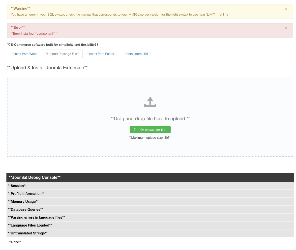

Hello Jerome,
Trying updating HS again, no more blank admin page this time, just the following page (see picture). Debug was enabled, but that doesn’t teach me anything special. The tab DB Queries shows some duplicates (but I've seen those with other sites and components too too)
To test the instalment process itself, I installed Breezingforms Acymailing and some other plugins, no error message there.
I checqued the DB in Joomla, optimized it with Admin Tools, checked file permissions, nothing to report.
Testing with an new Joomla installation on the same (local) stack and installing HS version 3.0.1, then updating to 3.2.0 went without a hinge.
Then I reinstalled a BU copy of the problematic site using a new DB. Problem persisted.
The only thing that is different is that HS on the « problematic » site is heavily customized, view and css fles are adapted to my liking, all the rest like payment methods, shipping, taxes, products and weights and so on is also already configured. Everything seems to work as intended. Could all these cosmetic changes (views, css, be the origin of the problem?

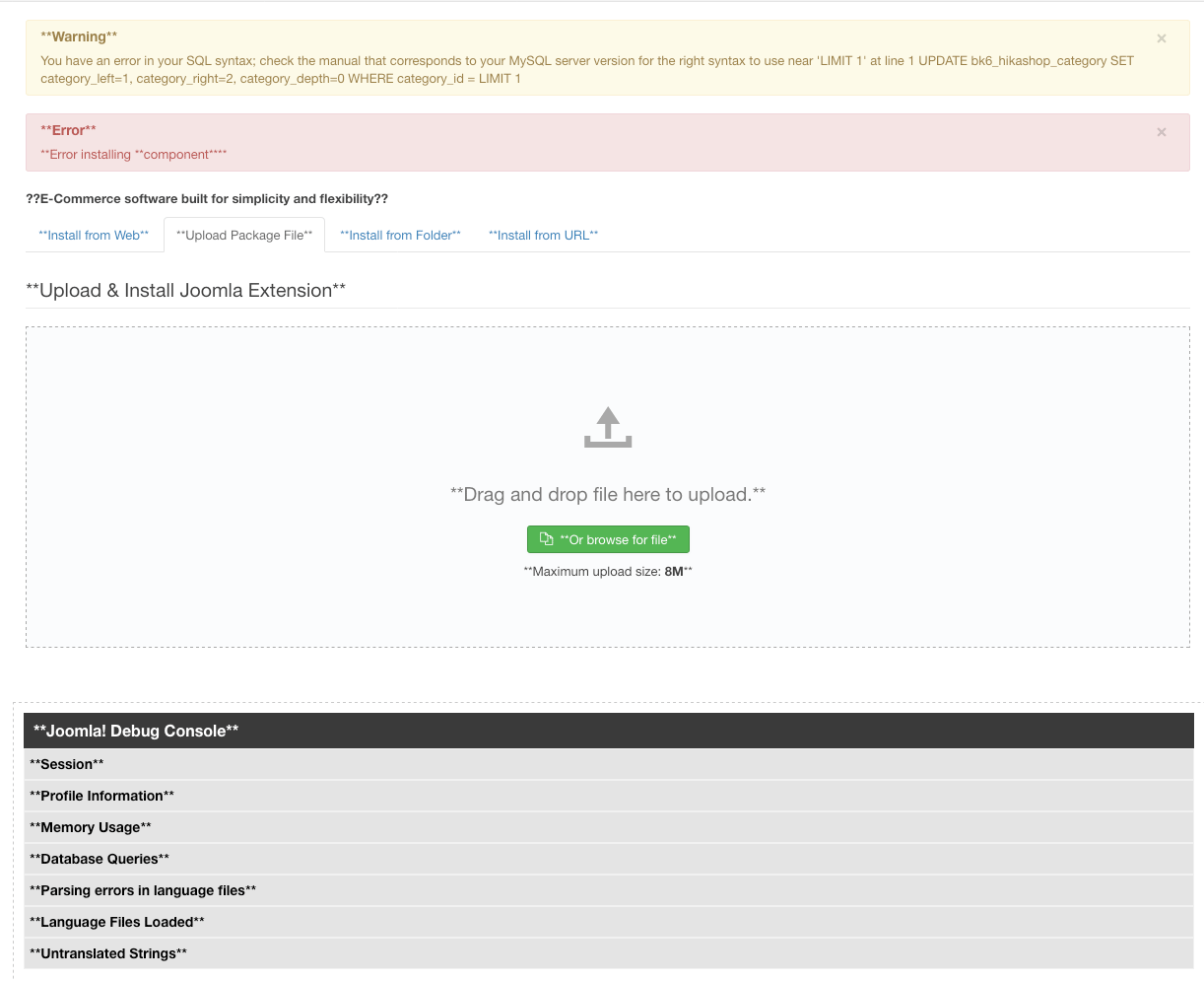

Hello again Jérôme,
This time the Warning message is a bit longer, see picture. Since there is a reference to "category" (bk6_ is my Database Table Prefix) a thought comes in my mind that maybe there is something with the categories, so I join a picture of those as well. Joined a dump of the table mentioned in ERROR-installing-component-(2).png as well (zipped).
It assures me that you have not mentioned customising views or adding / changing css as a reason for the problem. Good.
I hope this new information helps a bit.
Thanks so far,
Jan

by Jerome
Replied by Jerome on topic Confusing info about Hikashop version
Okay, that's much more useful message !
You have issues with your categories and you have some corrupted data.
I'll prepare a patch for the "rebuild tree" function in order to avoid such SQL error but in your side, you have to check your table "hikashop_category" which might have a category with an ID 0 (which should not be possible unless you do not have the "automatic increment" anymore ; which is also an issue).
But seeing your category tree, I'm afraid that you have several errors to fix in your categories...

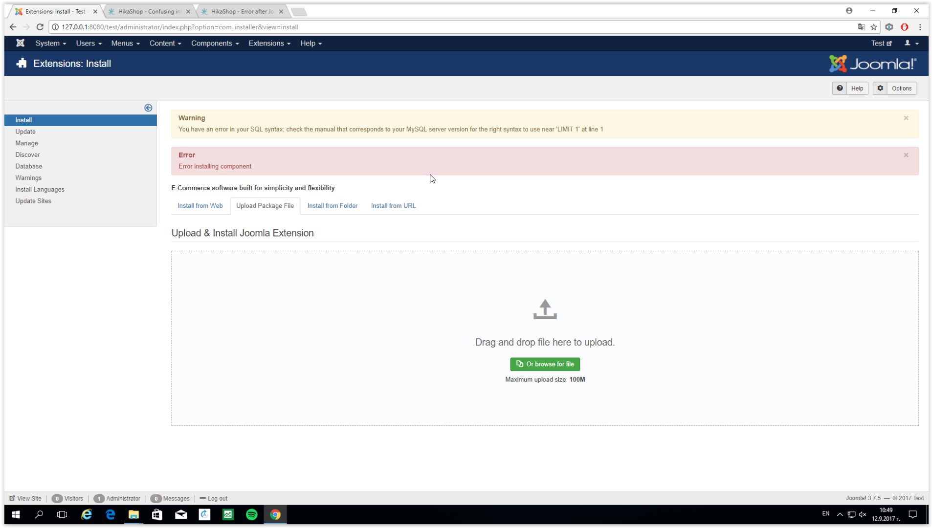

9 years 2 months ago #278203
by Jerome
Try to re-download HikaShop 3.2.0 package.
