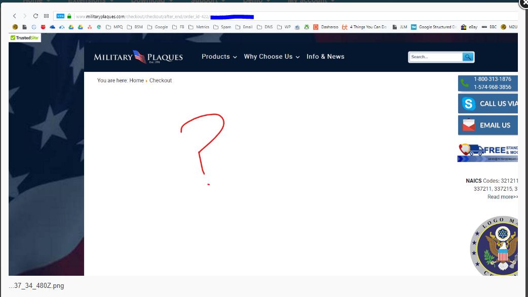

-- HikaShop version -- : 4.0.2
-- Joomla version -- : 3.9.4
-- PHP version -- : 7.2
I'm having a problem with the check out using Authorize.net on our site after successfully check out, the thank you page is blank. Please see below screenshot. Thanks

I'm using two different types of payment method onto the site, one has "Thank you page" and the other one does not have (blank page).
Authorize.net gives me a blank after_end message.
Purchase Order gives me a thank you message.
Any help. Thank you in advance.

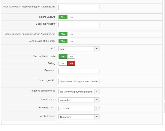

Also, please provide a screenshot of the settings of your authorize.net payment method (you can blur/hide the private information).

We are using HikaShop Authorize.net payment plugin. Please see attached settings for the payment plugin.

Since the "return URL" setting of your payment method is empty, what you should see on that thank you page is the content of the file plugins/hikashoppayment/authorize/authorize_thankyou.php
That's basically just the text "Thank you for your purchase".
So there are several possibilities:
- You have a translation override on that text and thus it doesn't display.
- You have some CSS which hides that area.
- You might have an override on that thank you page which change the display of the thank you page.
To be able to say more precisely, we would need a backend access and precise instructions to reproduce the issue on your website without having to make a payment (for example, with a 100% coupon, do you still have the problem ?).
