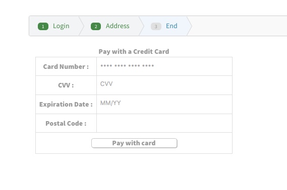

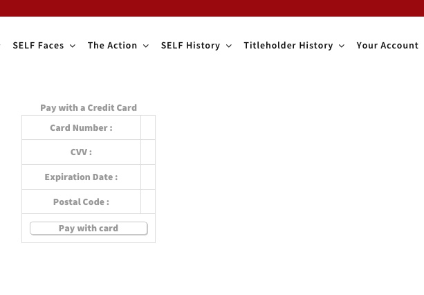

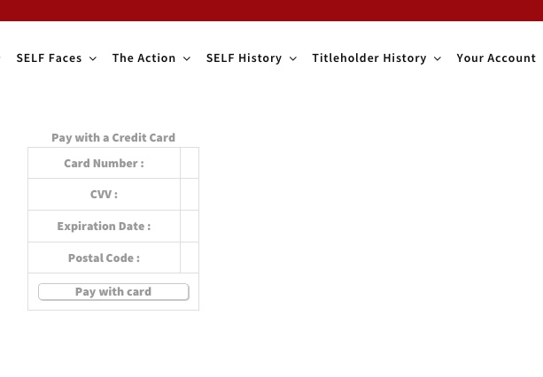

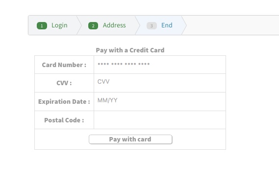

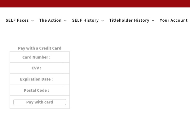

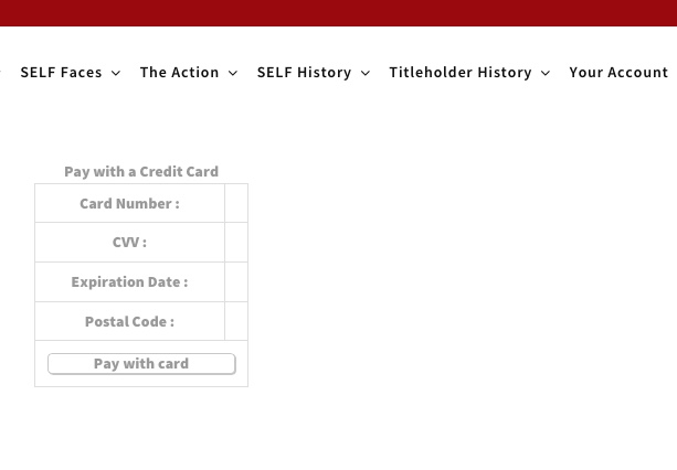

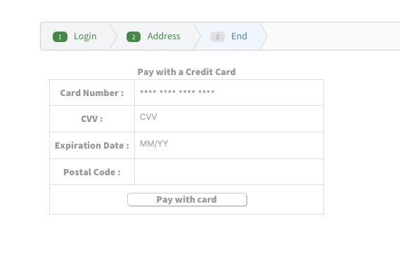

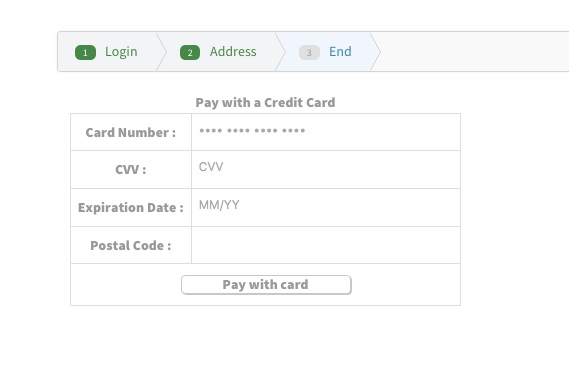

Please see the attached picture. This should render boxes in a second column where all credit card information is placed. I have placed the url and a screen shot. The second column should have space that you can plug in the numbers and be done. It's nor working. Help please and thank you.
There are two pictutes one when it's working and the one when it's not. I'm not sure why it stopped working. We had not changed settings at that time. Thank you.

I thought I posted this yesterday what I did to try to change and test. I also sent you credentials to have a look at what is going on. I'm attaching a bunch of screenshots so you can see what is happening all along. I am unable to take payments at the moment and I can't figure out what is going on.

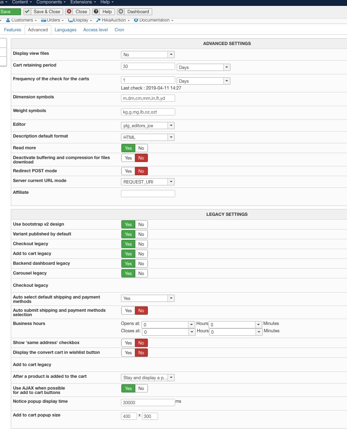

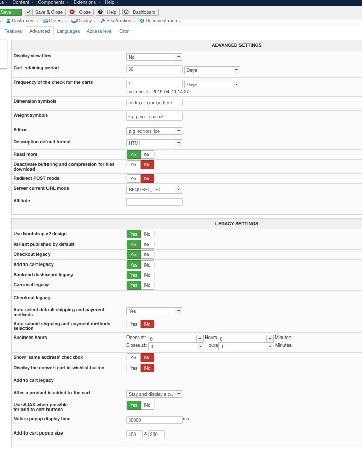

1. With the screen shots, you'll see what each checkout process looks like when the Legacy Settings are on and when they are off. Please see the settings pictures. When it's off the only thing that is different is half the options disappear and the settings then are yes, yes, no, no, no and no.
2. Both setups render "paytable2019.jpg" and I need it to be "paytableright.jog"

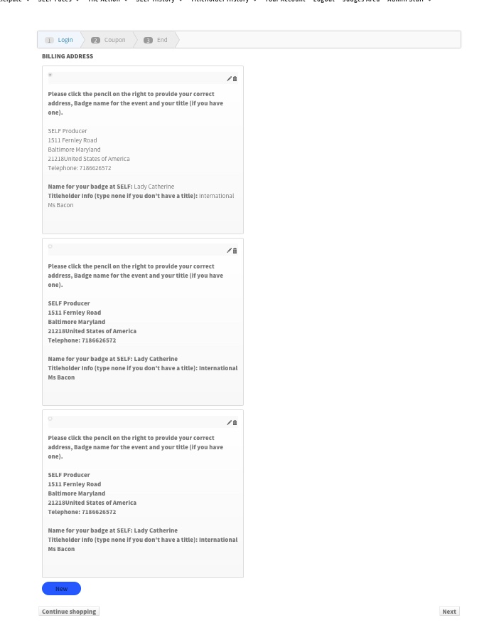

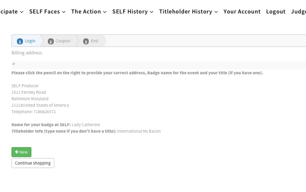

4.With legacy off, first checkout screen shows one billing address formatted correctly via "Address Format" in configuration. With Legacy, 3 addresses show up on the page and I semi-fixed that by placing the setting in address and shipping on dropdown list. Not ideal.

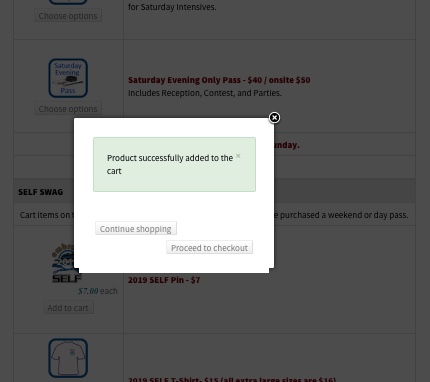

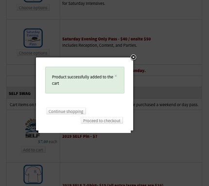

5. With legacy off, no popup box appears when client places item in cart. I check the plug and it is enabled. Popup box for legacy is spaced weirdly, please see "LegacyPopup.jpg"
6. Attached also a screenshot of the settings for the square payment settings.

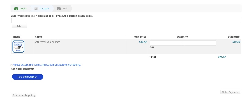

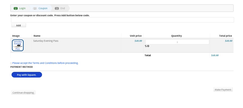

7. When Legacy is on, Please look at screenshot LegacyOnStep2. See that blue square square button? What the heck is that? It's the name of the payment plug. It isn't a link but when you hover over it, it changes to the color white. It acts like a button. My clients think that's how you pay for something and keep trying to click it. How do we get that to not look like a button or act like a button????

4. I want one billing address to show.

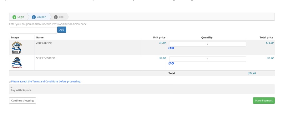

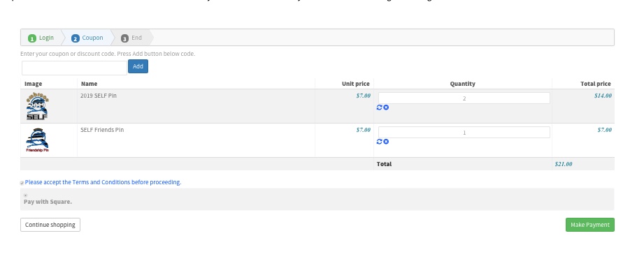

7 years 5 months ago #305760 by notnilla
more screen shots... of Legacy not on which is what I want to work. Please and thank you.

I tried that again. That's the fourth time. It doesn't work. It will has the same outcome.
SO here I am. I literally switched provided. I put together 10 screen shoots. You asked me to give you access to the site, I did via private message here 3 days ago. I think you have that as I confirmed that you created an order. You are saying that this is the zipcode issue but that doesn't matter regardless of how that option is set. Also, if zipcode is the probem, Square will not process and will decline all orders without a zipcode. A zipcode is required to process a payment in the US. The only items that process are ones with a discount code where no one has to pay for anything.

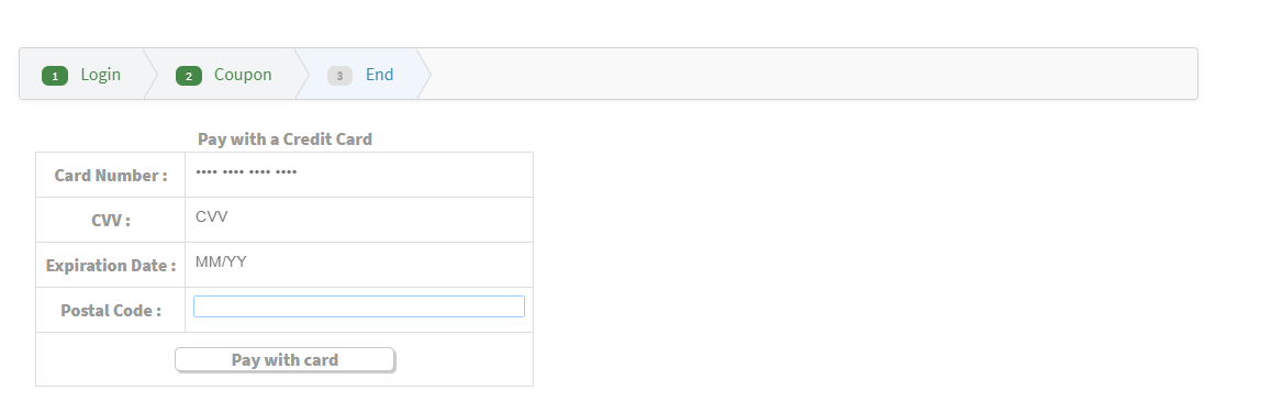

7 years 5 months ago - 7 years 5 months ago #305808 by Tsuki Dev
I actually tried it and was facing the following error message when I tried to access to the back end of your website :
You do not have access to the Administrator section of this site.

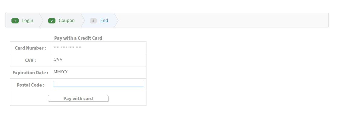

When I tested it on your website, I wasn't able to use any field of the Square credit card payment form and I had the following JS error message through the payment page :
Uncaught MissingInputTypeError: The SqPaymentForm 'postalCode' option is required.
Which means that the "Disable postal code requirement" option was set to YES.
Also, I just tested it now and it seemed to be working fine as you can see through the attached screenshot.
