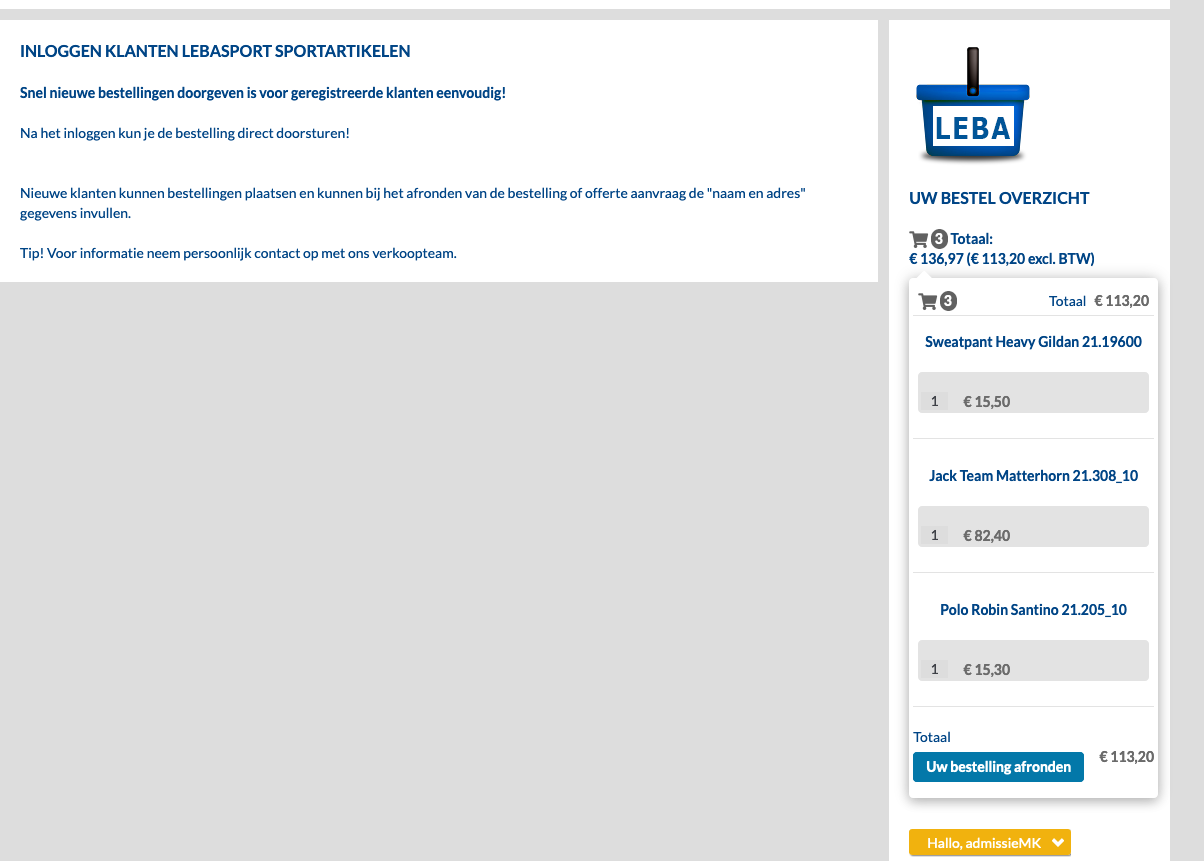

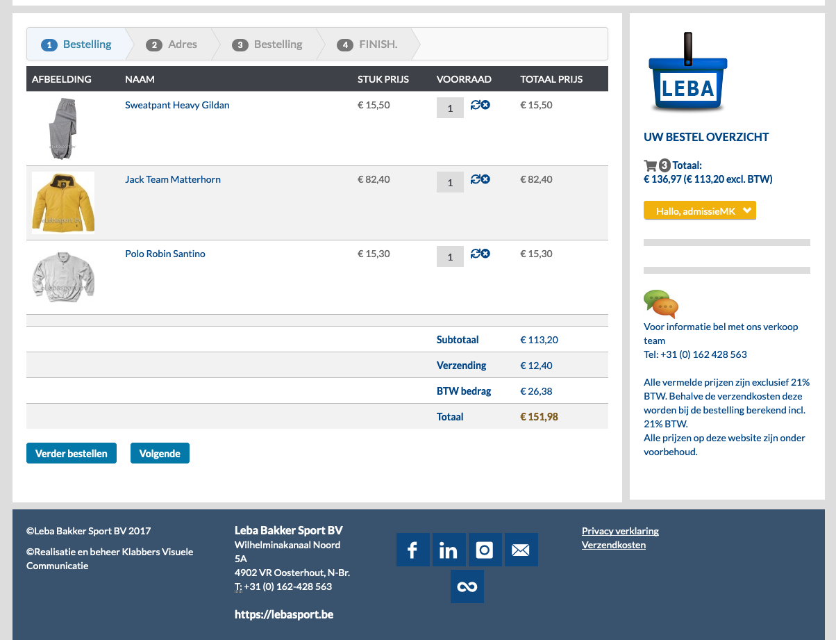

7 years 4 months ago - 7 years 4 months ago #307564
by mariussport
Replied by mariussport on topic After Update on 4.1 checkout is not working anymore
On 2 test sites the checkout doesn't move to the second step at all. Before the update Hikashop 4.1.0 ZIP from today 12 june 14:00 and 18:00 hour, both sites worked perfect in de checkout. We had never this problem. (1 local and 1 online) lebasport.be
The official site is not updated yet because we want receive orders.
see the attachments with the cart and shop cart step 1. We use the "cart design"
best regards,
Marius Klabers (Joomla comm. Breda NL)
best regards,

@mariussport :
Similarily, on lebasport.nl your "force menu on checkout" setting is set to the "Bestelling en Login" menu item which isn't either a hikashop type menu item but a Joomla article. Please try to use a HikaShop checkout menu item type for that "force a menu on checkout" setting. Now, I wasn't able to reproduce the issue on your website as you still have the 4.0.3, but I highly suspect that this is the problem.
In fact, with your feedbacks, I've noted on my end to add some warning in the HikaShop configuration for such situation.

- mariussport
- Offline
- Test fase
7 years 4 months ago #307641
by mariussport
Perfect now I set the "force menu to" None. The cart is working perfect till the end!
I was thinking already that way, but i was looking to "continue shopping URL" but that was nearly!
Thank you for the quick answer.
best regards, Marius
You can close this topic.
