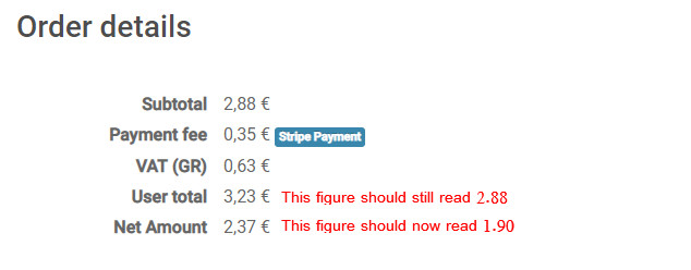

7 years 2 months ago #309548
by lesk
Stripe Payment Fee added to order was created by lesk
I've setup Stripe (V.2) to calculate the fee per order at 0.30 + 2.9% and this works fine except it ADDS the amount to the customer's order total when I need it not to do that. Is there a setting that I can alter?
I actually want the fee to be deducted from the amount that I use to calculate the vendor fee from. see image below. Instead it's adding it the net amount. does this work differently in Stripe (V 3.0)?

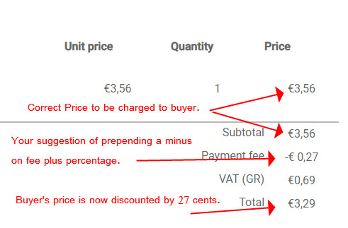

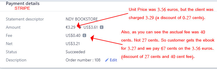

7 years 2 months ago #309609
by lesk
Replied by lesk on topic Stripe Payment Fee added to order
Hi Nicolas, No, it doesn't work like that at all. See attached images.
The first is the sales order in Hikashop, the second is the sales receipt in Stripe.
This second one shows the facts.
As you can see the order value is incorrect. The customer either pays extra on top of the order price, OR they get a discount on the order price.
What actually needs to happen is that it is calculated in the same way as the VAT and deducted before the net figure but after the customer has paid the full price for the item. Then the amount left for the Vendor fee to be calculated is going to be 2.60 euros (net of the VAT and CC Fee).
I can't see any other way to do it. It MUST be treated in the same way as the VAT whichever way you work it.
