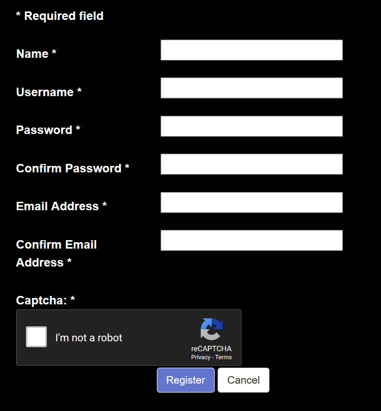

I know this has been raised before and various answers supplied including switching off the global captcha or redirecting to the Hikshop Registration page.
I redirected to the Hika Registration page and the captcha will not work correctly, it just keeps refreshing. If I turn off the Hikashop Captcha then the captcha works on the rest of the site, contact form, standard registration page etc. So for me the issue appears at least to be with the Hika plugin. If you are saying it can't be I would appreciate a step by step solution on how this can be rectified? Turning off the global captcha doesn't seem to be a solution to me as other forms are not covered.

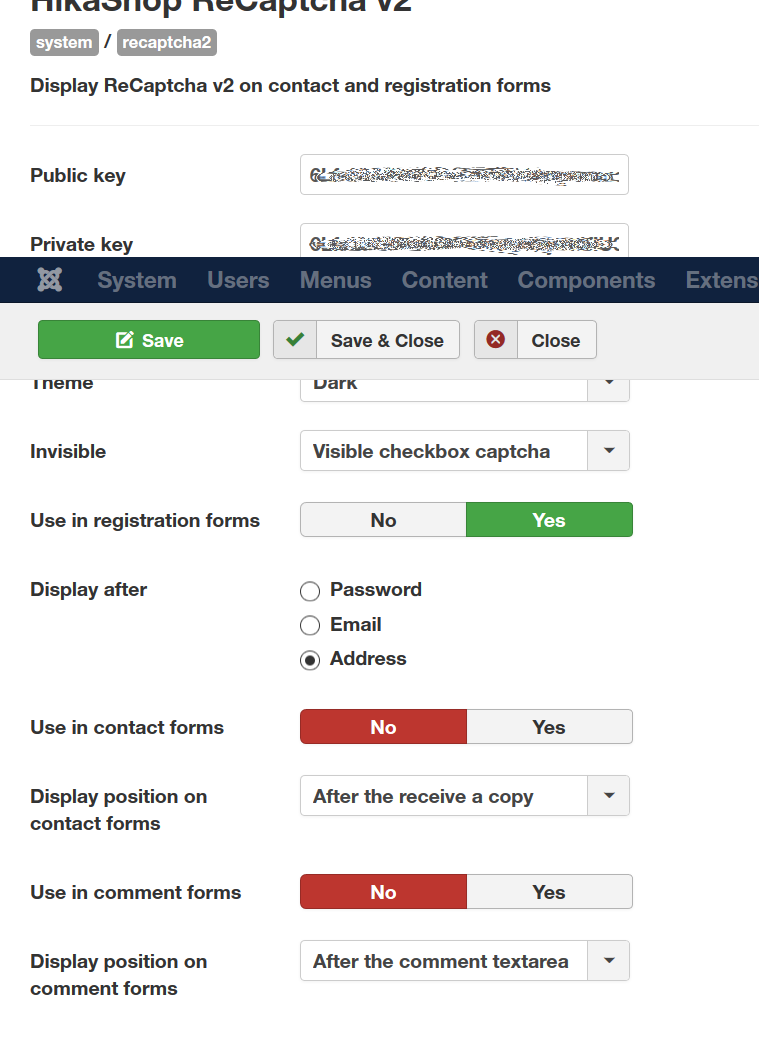

I have attached a screenshot of the setting for the Hika Captcha plugin. On all forms I require the captcha to prevent the usual fake accounts etc.

This error indicates that HikaShop's recaptcha plugin is trying to validate the registration but it doesn't find its captcha answer in the form and thus displays that error.
If I look at the link you gave, I can see that it's the Joomla registration form and Joomla's recaptcha is displayed there. HikaShop's recaptcha is not displayed. So that's why you get the error.
That's because you've configured the captcha plugin to display after the address, but as you're using the Joomla user registration form, the address fields are not displayed and thus it doesn't find the location where to add itself.
So changing that setting of the plugin to password or email would allow it to work, but then you would get two captcha to fill on the page, one from Joomla and one from the HikaShop plugin.
So that's not good either.
I would recommend to change that and then also deactivate Joomla's captcha. That way, you'll have only HikaShop's recaptcha.

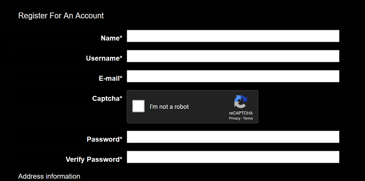

It appears most of it is now resolved. However on the registration form if the Captcha is set to be placed after email that looks fine but on the checkout registration it is between the email an password fields which doesn't look very good to me. I assume I will now need to go into views and change the views file? Having said that it looks a bit out of place as most people are used to seeing a Captcha box at the end of a form.

Well, since you're using HikaShop's recaptcha and not Joomla's, you could activate the Redirect Joomla registration to HikaShop plugin via the Joomla plugins manager to use HikaShop's registration page only. That way, you'll be able to use the "after the address" mode of the plugin.
Alternatively, you could also activate the "invisible" setting of the plugin. That way, the captcha actually won't appear on the form unless Google thinks you're not a human (based on your behavior on the pages, where you click, etc). That would even help for your conversion rate since it's one less thing to do for your customers.
