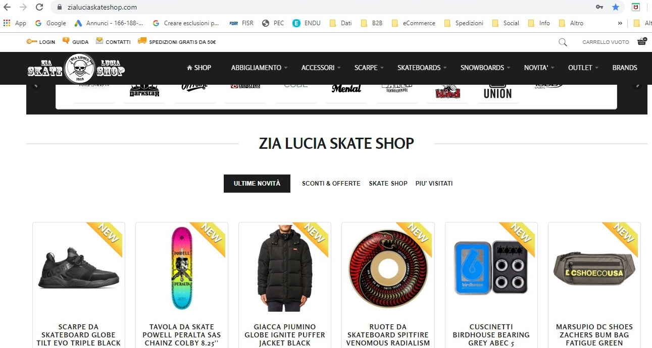

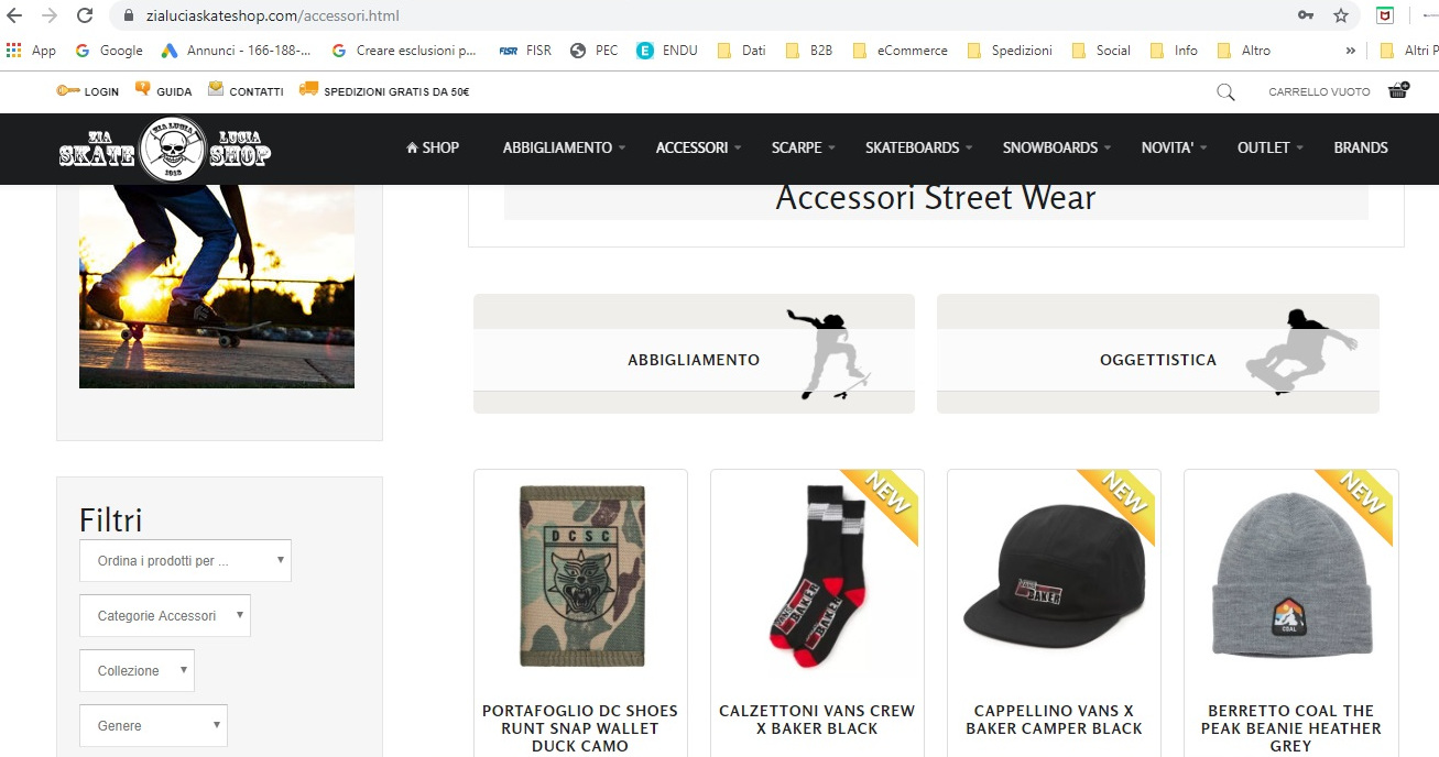

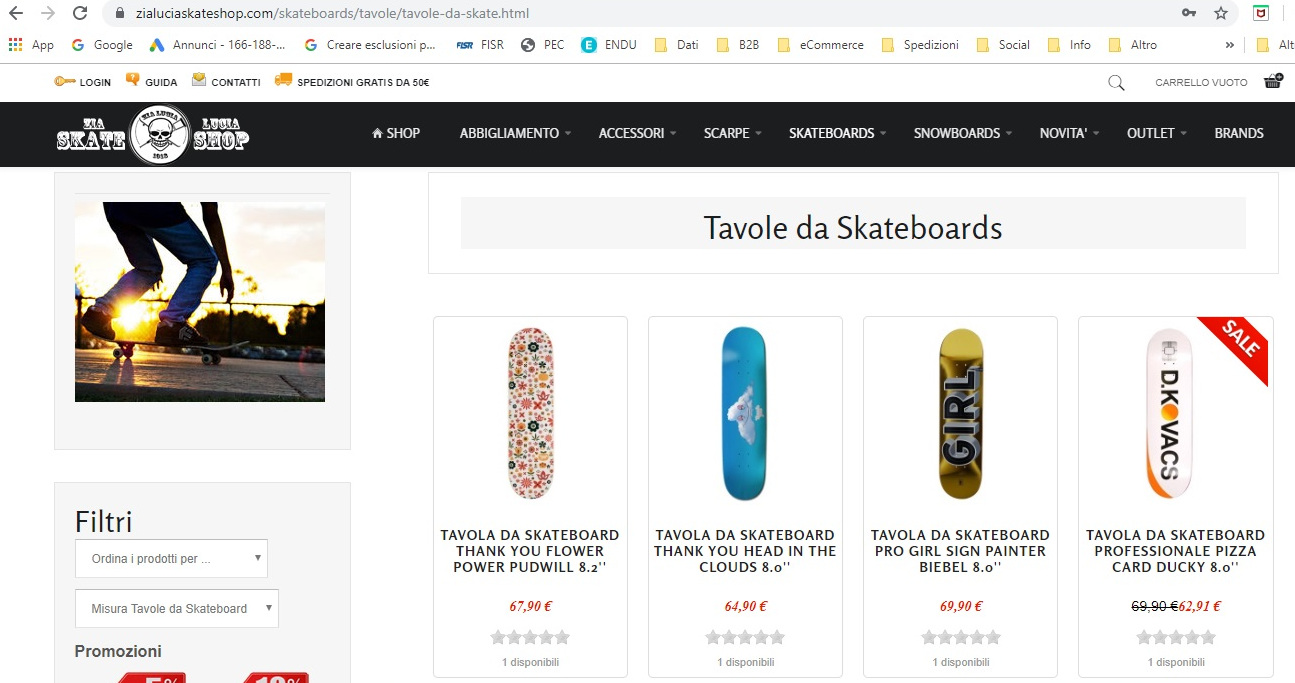

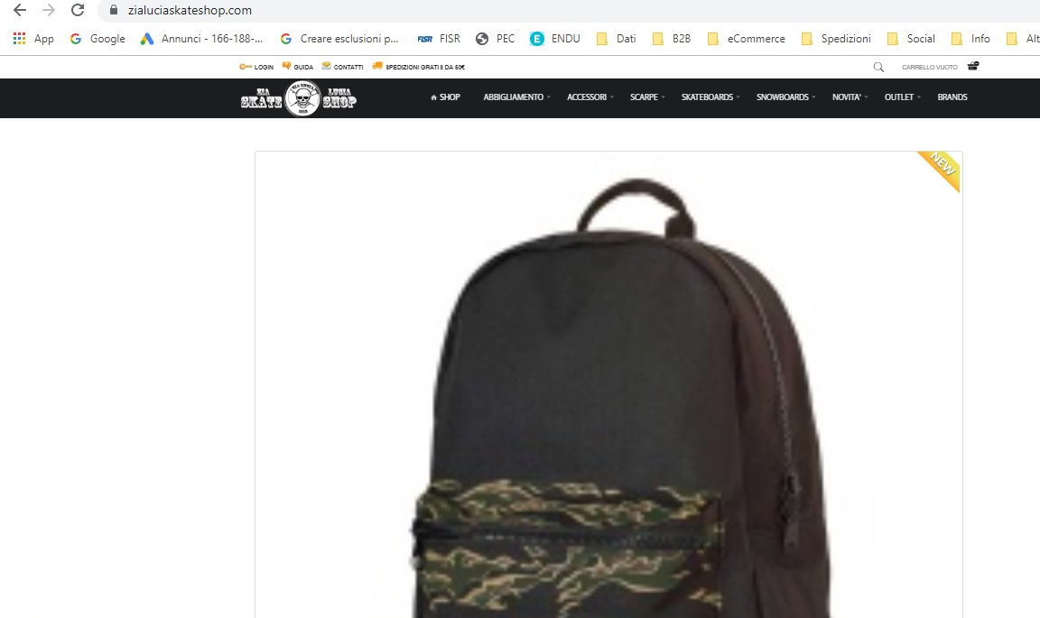

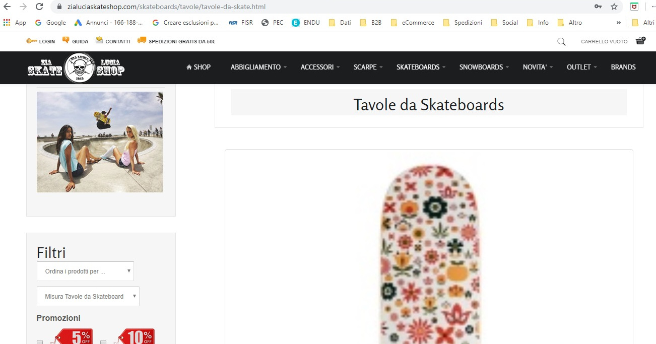

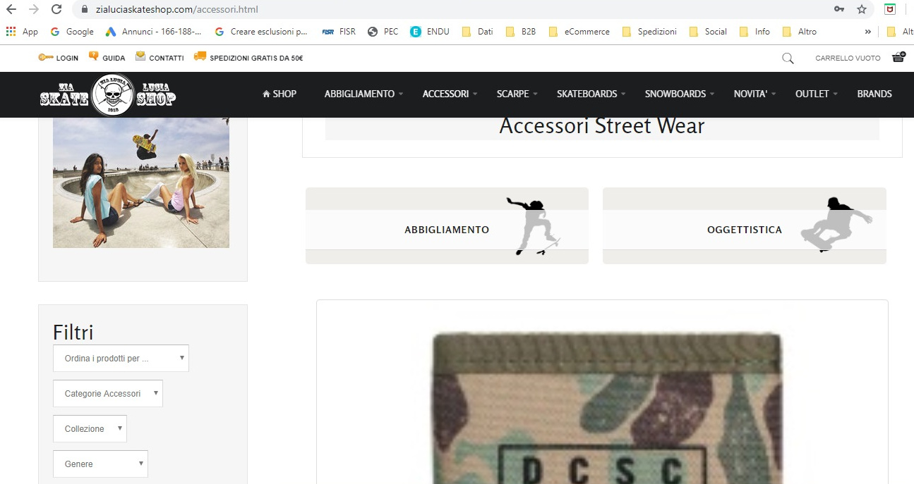

the site is operational, so we cannot leave it in problematic conditions for users. So I send you screenshots of what happens on the site when we disable the listing_div.css file and modify the code HikaShop frontend CSS to line 42.
The Infinite scroll works, but everything becomes a column and we also lose the settings on the home page.
