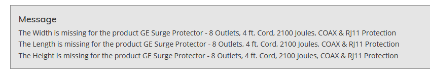

Sorry! I set it to NOT use dimensions, because I want it to only be weight based, and I am still getting an error about missing weights.
Is this another setting I need to change somewhere?

Well, when I test the shipping plugin on the front end, with it set to weight base and dimensions set to no, it tells me no shipping method is found.
Since I don't know the inner workings of your plugin, I was kind of hoping you'd be able to tell ME why that was happening?

Also, regarding the error message you are having, did you actually tried to set temporary dimensions like 1x1x1 to that product to prevent that issue from happening ? If the "Use dimension" option is set to NO, that shouldn't be a problem.
