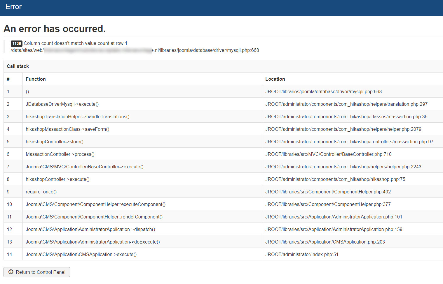

Mass Action Error 1136 Column count doesn't match value count at row 1
5 years 7 months ago #332067
by Lumiga
Kind regards,
Lumiga
-- HikaShop version -- : 4.4.2.
-- PHP version -- : 7.4.16
Hi supprotteam,
After the latest update a Mass Action give problems.
We get this error: 1136 Column count doesn't match value count at row 1

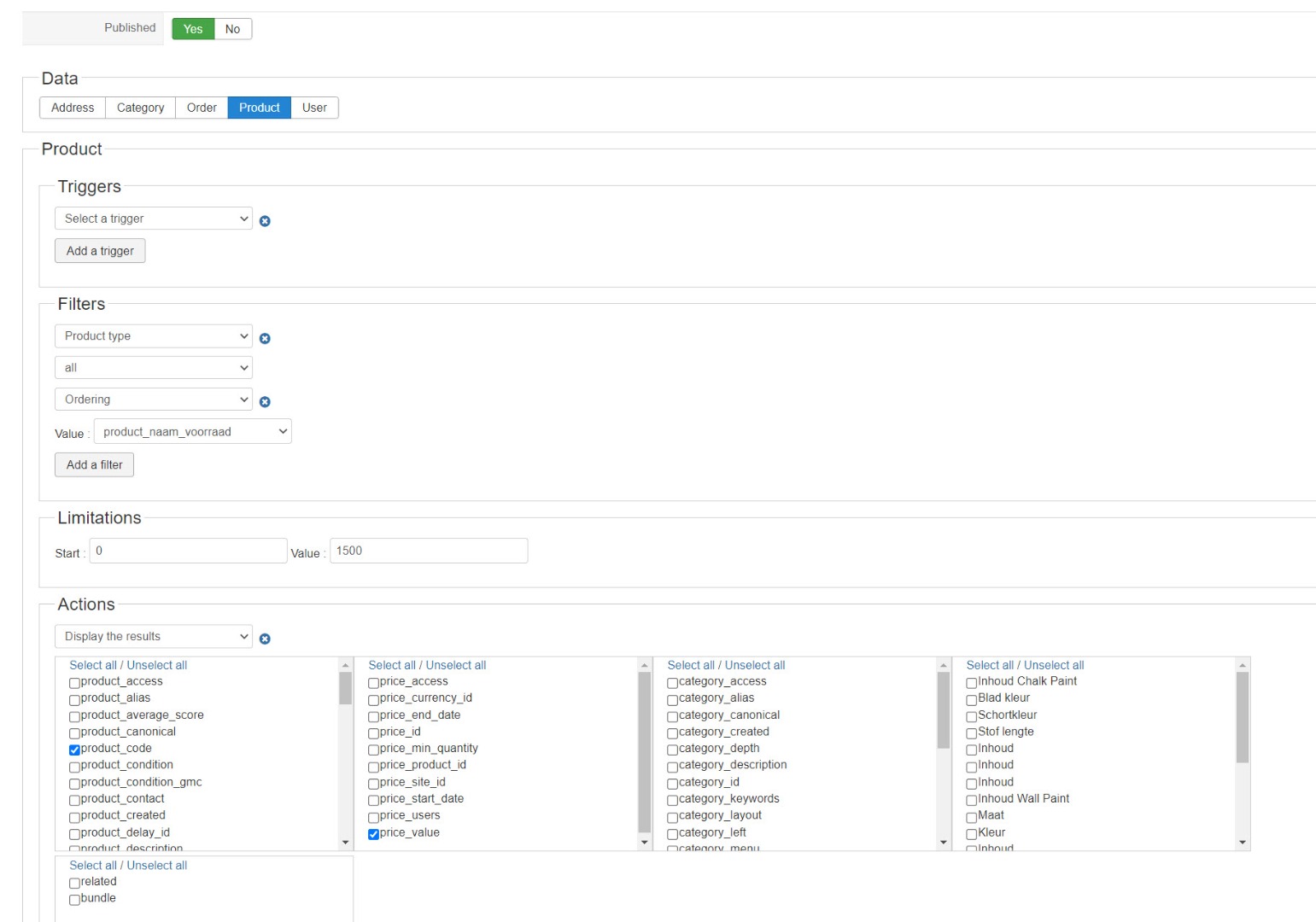

The Mass Action look like this.
Hope you can fix this issue.

5 years 7 months ago #332075
by nicolas
Replied by nicolas on topic Mass Action Error 1136 Column count doesn't match value count at row 1
I'm not able to reproduce.
Could you activate the error reporting and debug mode of the Joomla configuration and try again?
The error message should hopefully display more information.

5 years 6 months ago #332099
by nicolas
Thanks. I've made a patch for it. Download again the install package of the 4.4.2 on our website and install it on yours and it should work properly.
