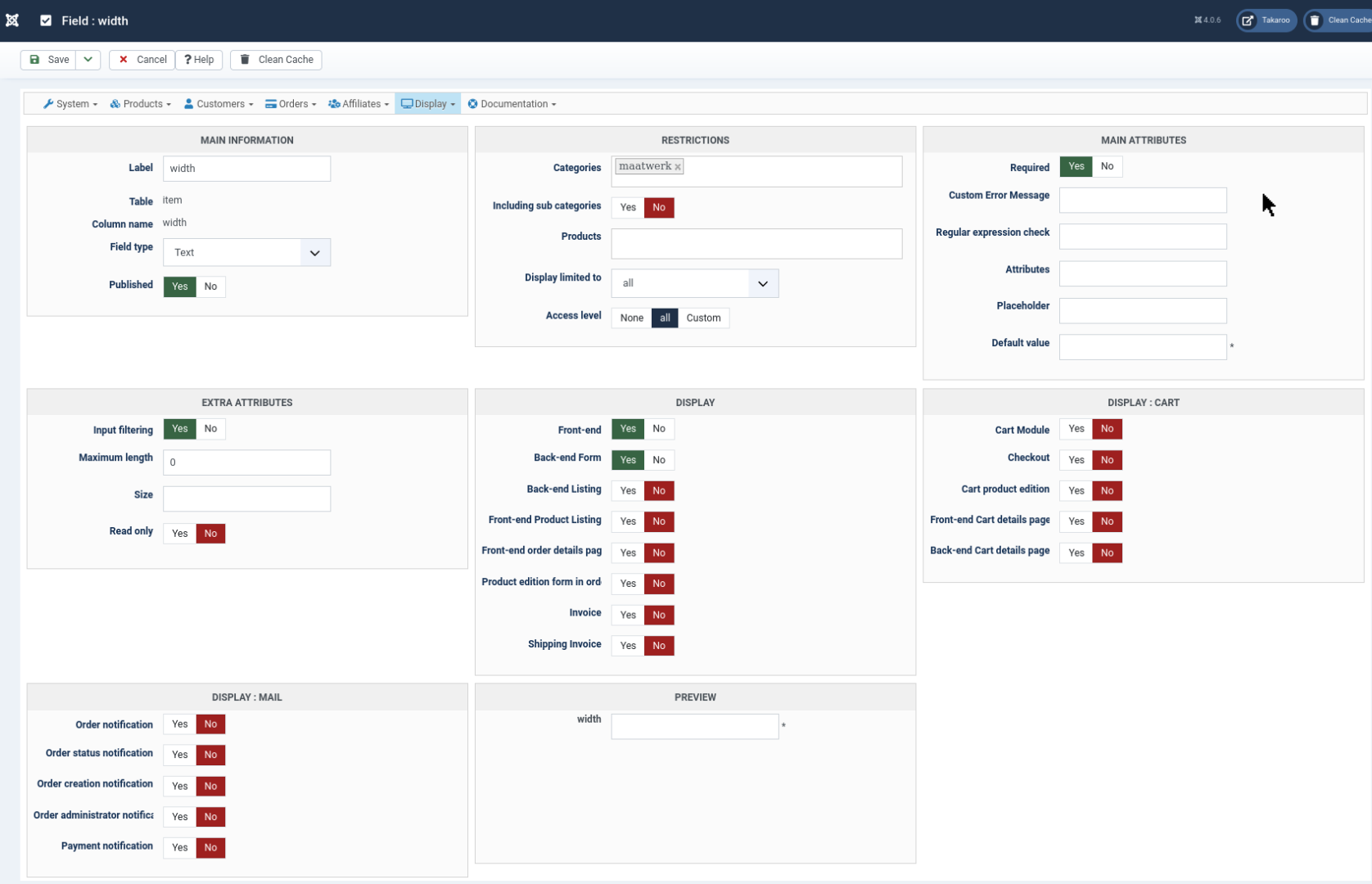

Could you provide a screenshot of the settings of the custom field ?
I provided a screenshot, but currently no real attention has been payed to specific settings yet. I hope you can provide me with general, conceptual information on how to approach this, so I can use it for future custom fields as well, not bound to specific settings :)

Ok, so it is a custom field of the table "item", which is displayed on the product details page on the frontend.
For that kind of custom field, the simplest is to do the check only in javascript. In that case, you can just create a view override of show_default via the menu Display>Views and add a bit of javascript to the page like so:
