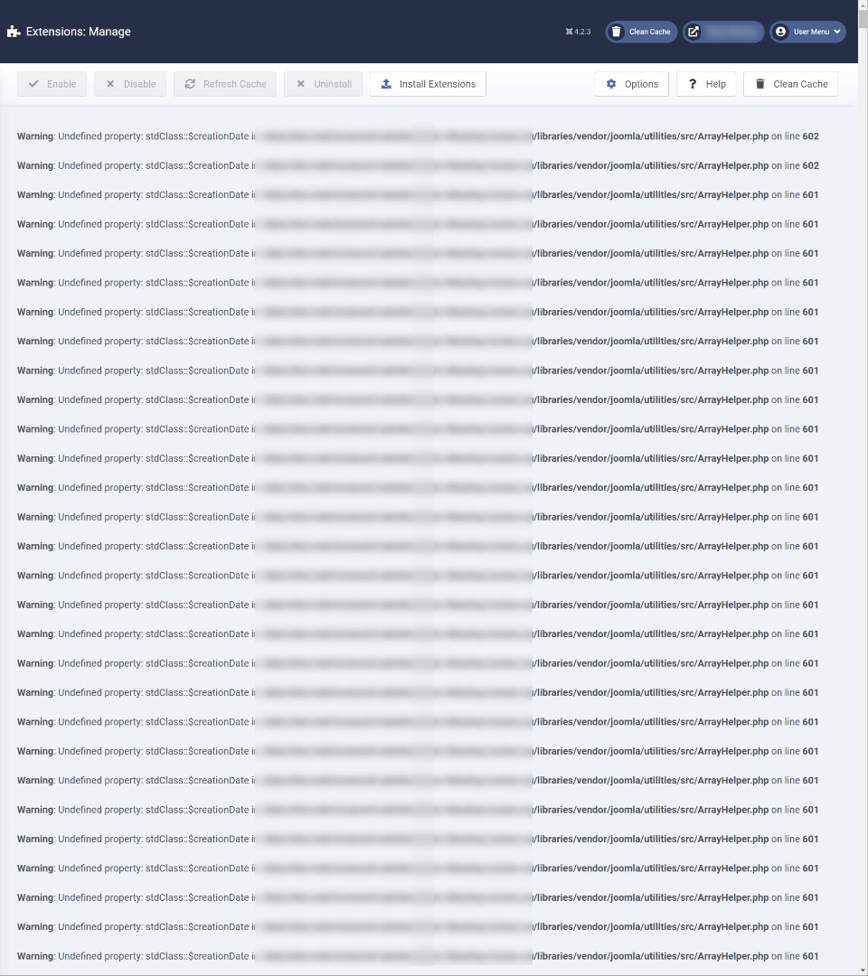

-- HikaShop version -- : 4.6.2
-- Joomla version -- : 4.2.3
-- PHP version -- : 8.0
Steps to reproduce the issue
Set Server error reporting to maximum at global configuration, then:
system->extension manager-> click on date arrow
Expected result
sorts date
Actual result
While the date is sorted this error below occurs numerous times
Warning: Undefined property: stdClass::$creationDate in ../libraries/vendor/joomla/utilities/src/ArrayHelper.php on line 602
Warning: Undefined property: stdClass::$creationDate in .../libraries/vendor/joomla/utilities/src/ArrayHelper.php on line 601
See also: issues.joomla.org/tracker/joomla-cms/38970

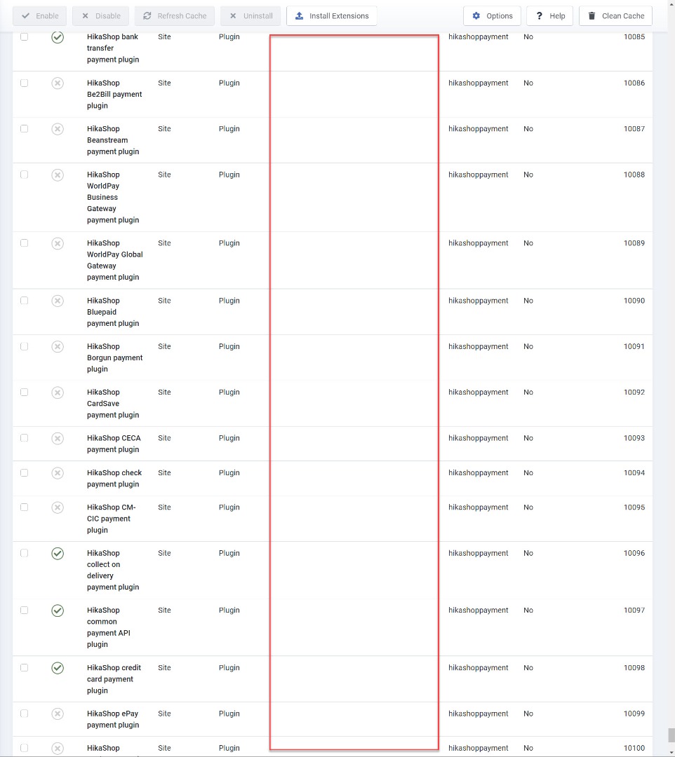

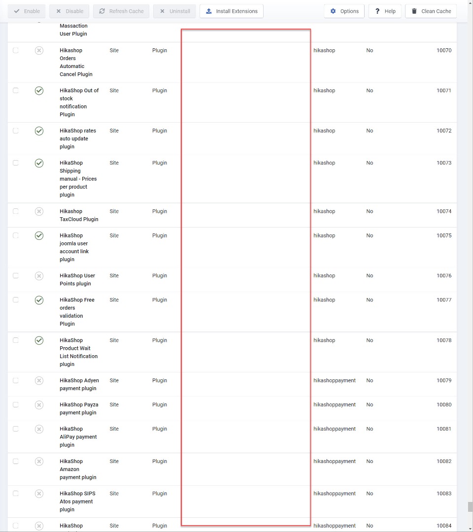

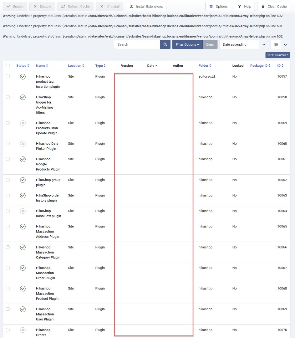

Replied by Lumiga on topic Extension sort-by-date causes Undefined property
I discovered that these warnings are caused by Hikashop!
I used a test website without these warnings and without Hikashop.
And after installing Hikashop we do indeed see these warnings.
