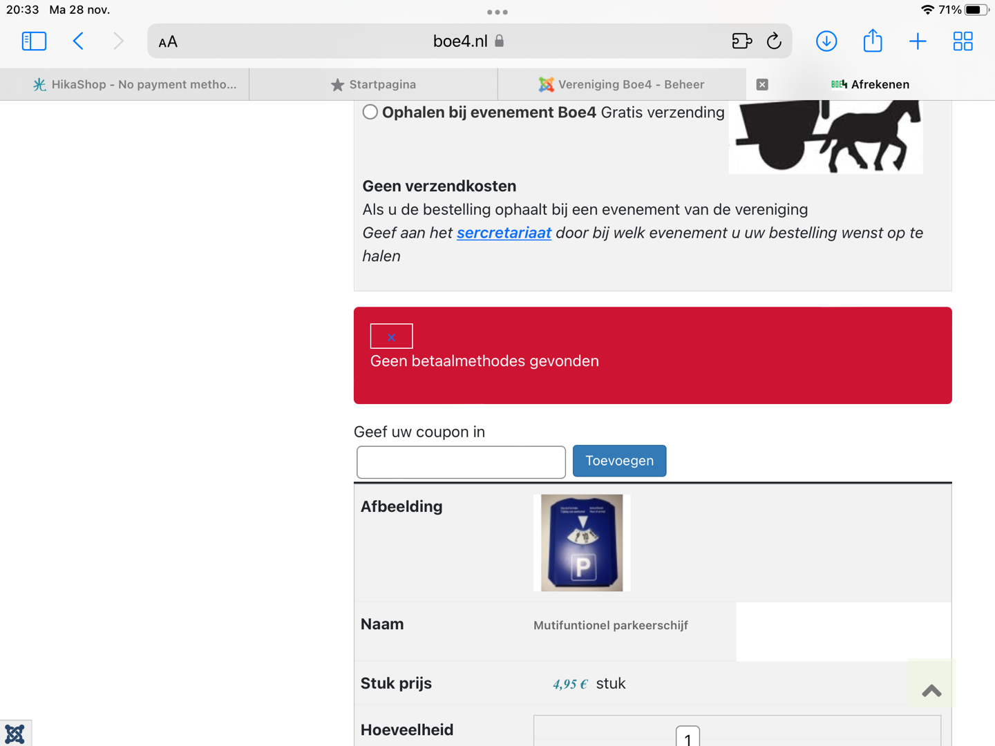

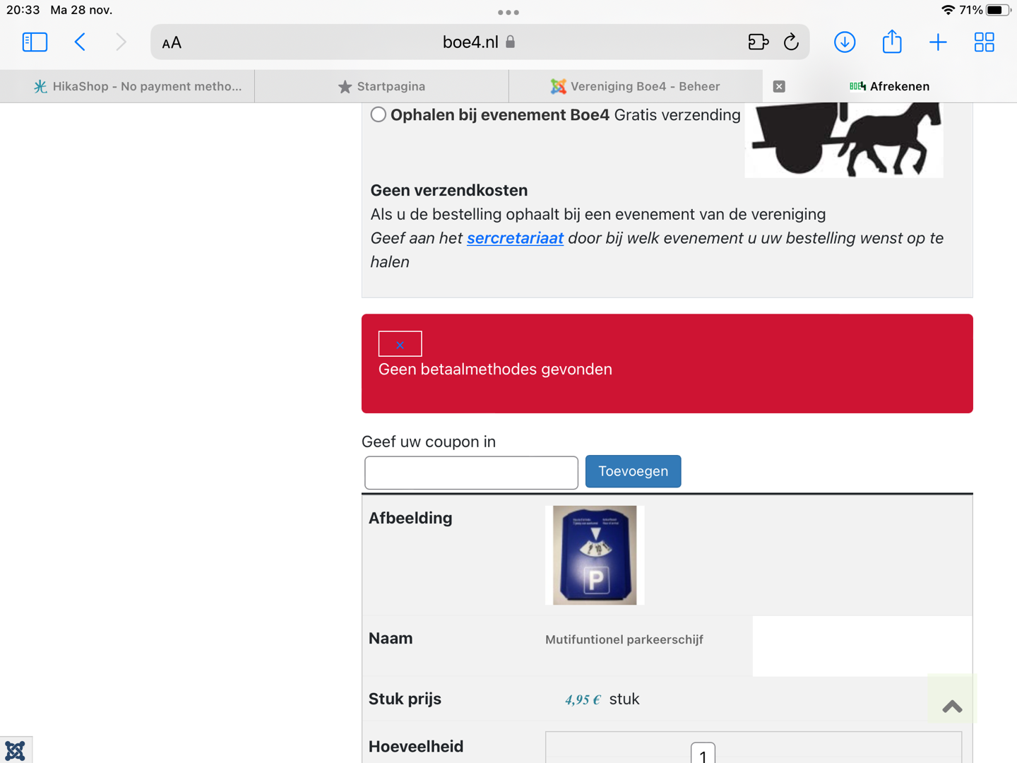

Everything finally works fine after the migration to Joomla version 4. Still 1 problem.
At checkout I get the message:
No payment methods found
I have activated Ideal plugin, but no result.
Any idea how I can activate the payment in the checkout screen

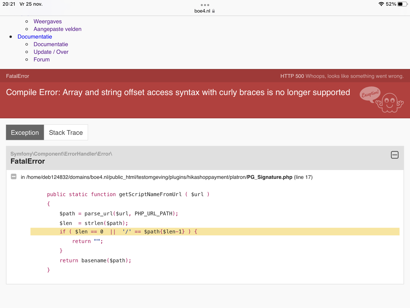

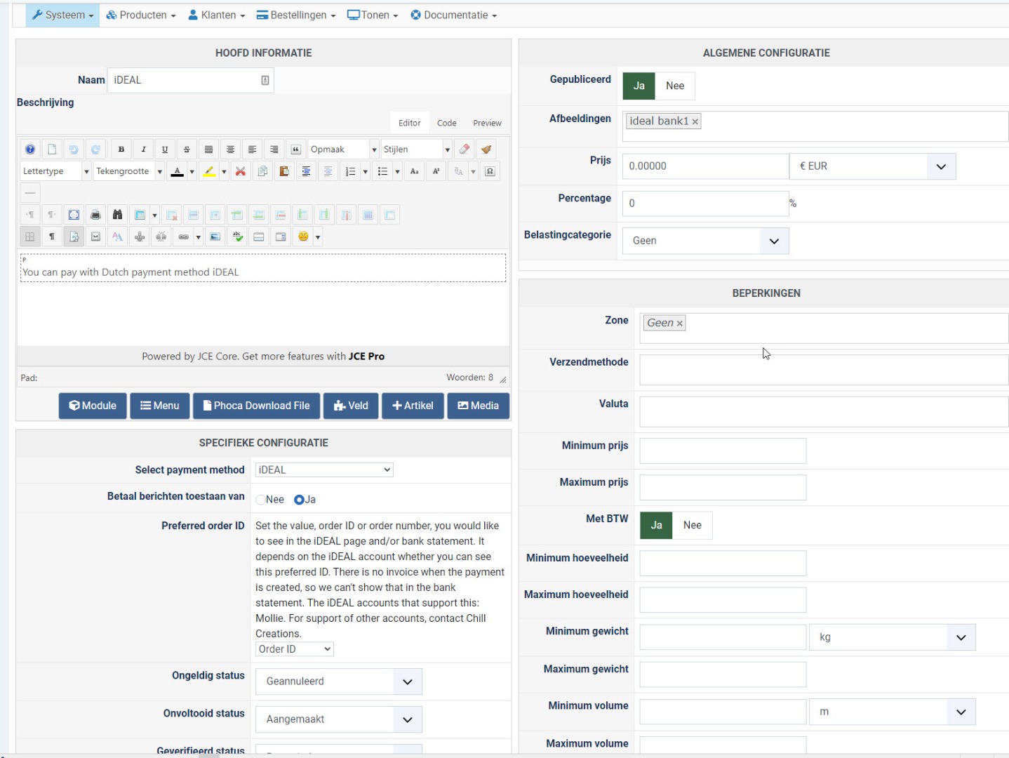

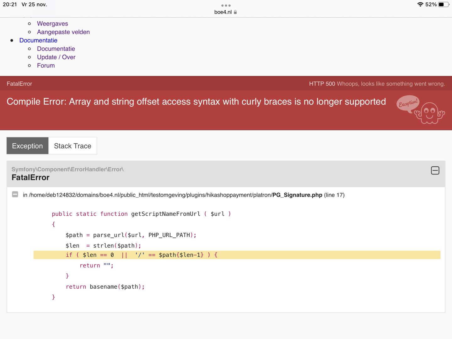

3 years 9 months ago #346929
I have read the page and have change settings for Ideal
But get error
See attachment

  • Posts: 86080
  • Thank you received: 14188
3 years 9 months ago #346932
You have the an old version "platron" payment plugin. Uninstall it via the Extensions manager if you're not using it and you won't get that error.
  • Posts: 9
  • Hikashop Essential
3 years 9 months ago #346936
thank you the error has disappeared.

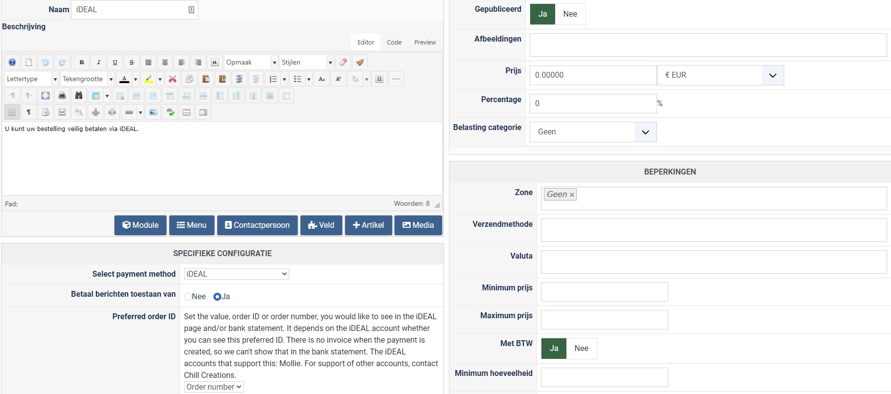

  • Posts: 86080
3 years 9 months ago #346948

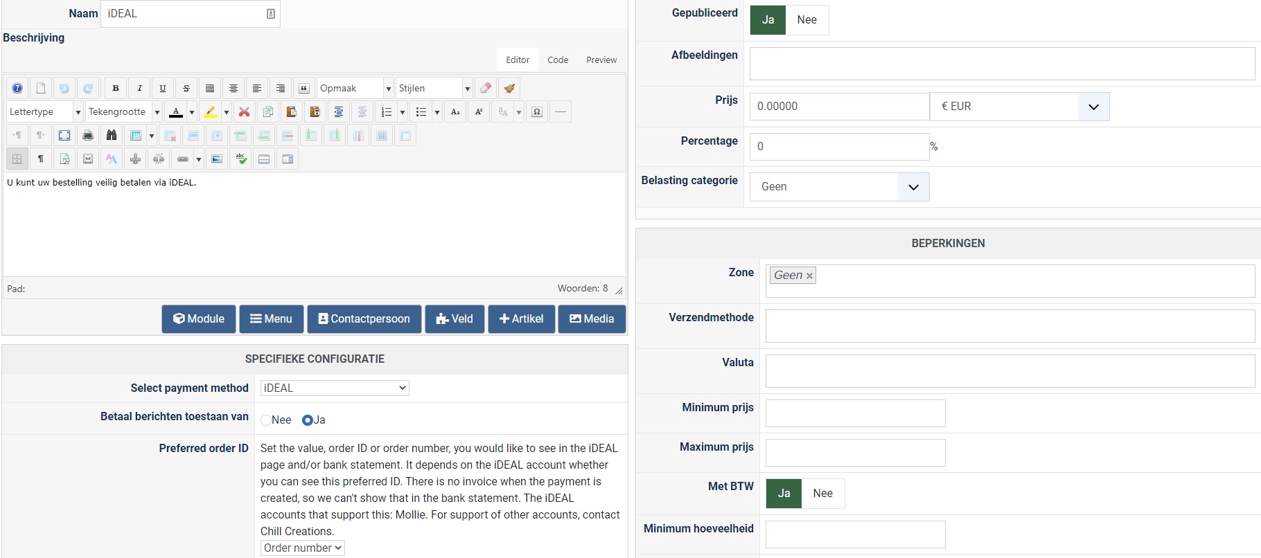

Can you provide here a screenshot of the payment method so that we can check the situation ? Maybe we can figure out something out of it.

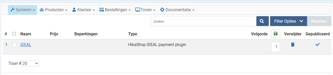

  • Posts: 9
3 years 9 months ago #346992
Ofcourse, see below

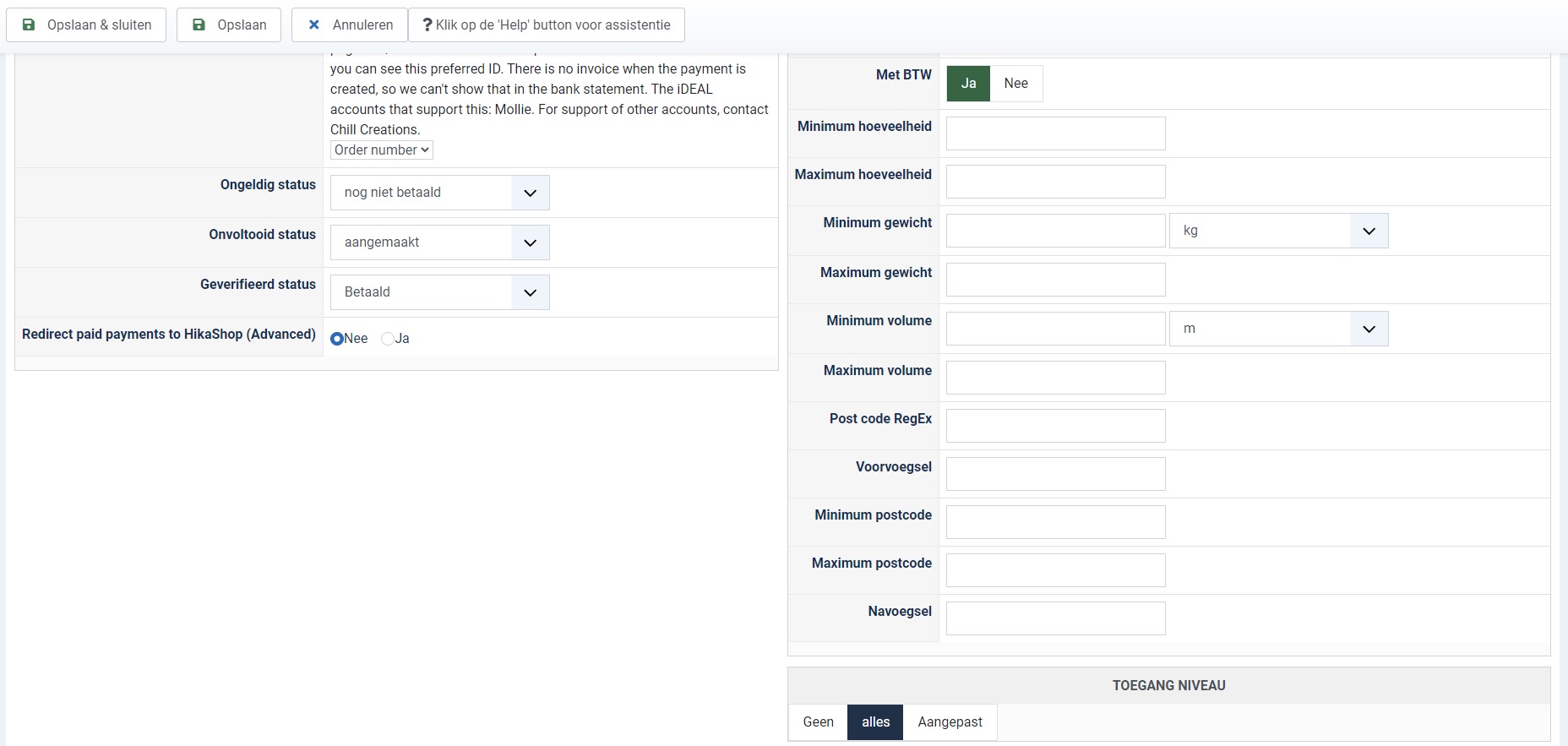

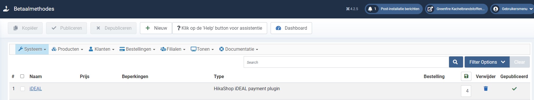

  • Posts: 86080
3 years 9 months ago #346997
No, I mean a screenshot of the settings of the payment method. Please go in the menu System>Payment methods in your backend, and open the settings of your payment method. It's these settings I would like to see.

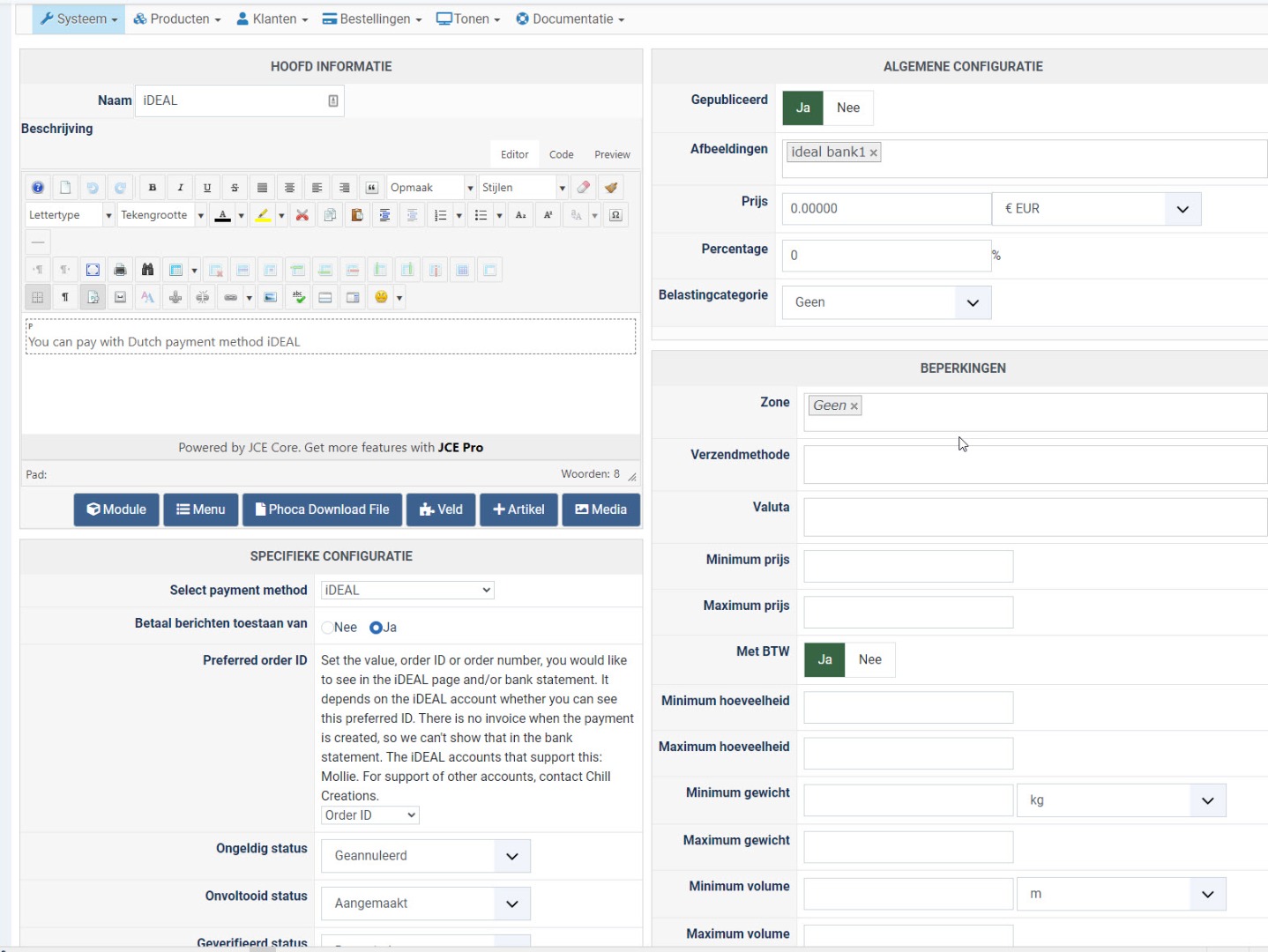

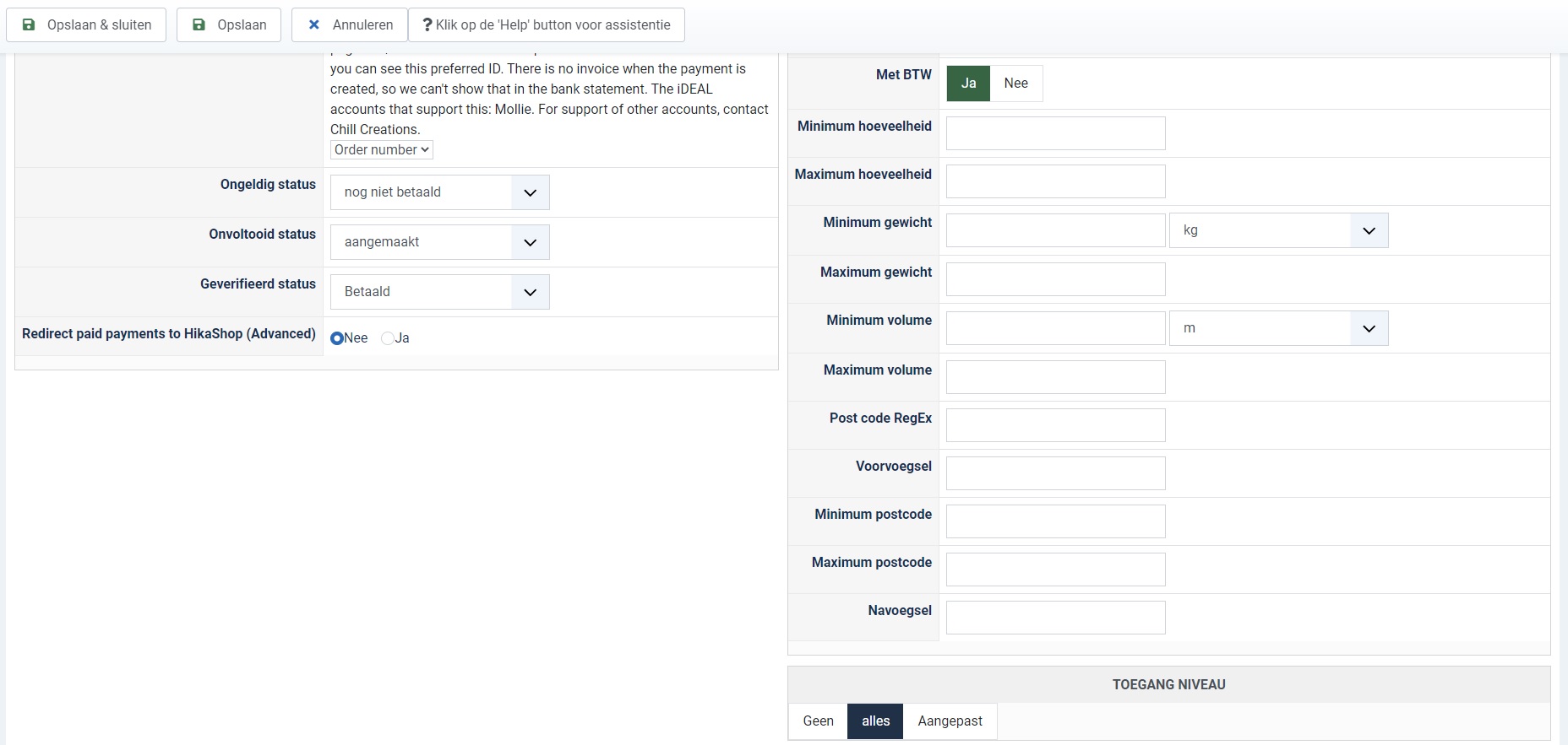

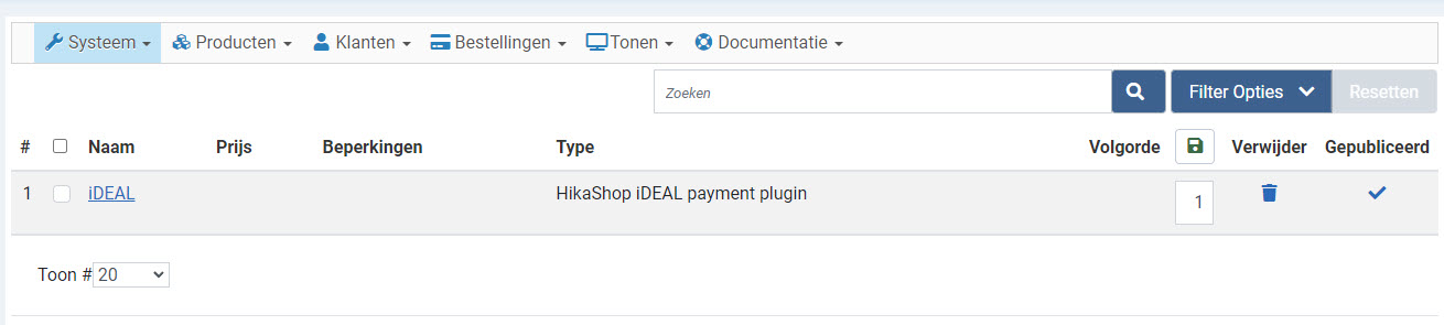

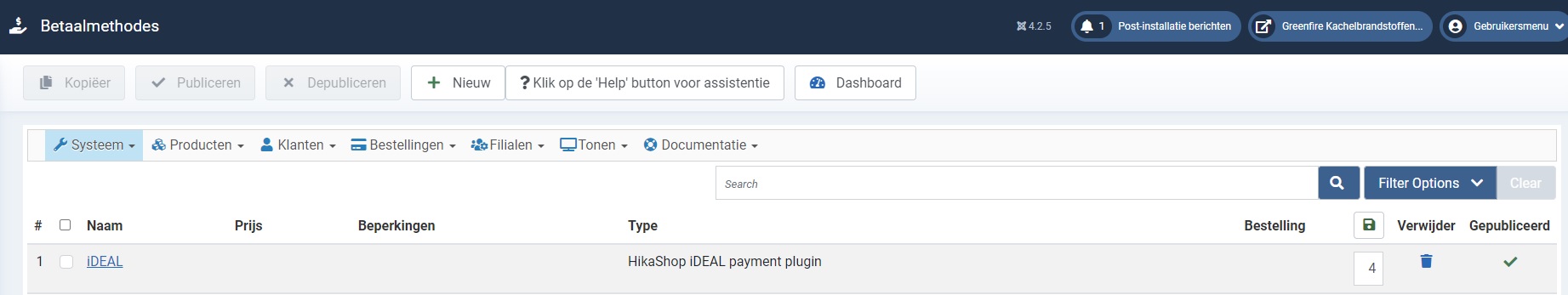

  • Posts: 9
3 years 8 months ago #347020
I also use the plugin from Chill Creations and also the last version.
for clarity.
On the live site everything still works with Joomla 3 and without any problems.
The Joomla 4 test environment I'm working on now has problems with the payment method.
Also included is a screenshot of the payment method in the Hikashop control panel as requested
Last edit: 3 years 8 months ago by aberg.
  • Posts: 9
3 years 8 months ago #347027
Latest update.
Just bought the mollie plugin on the Hikashop marketplace.
Installed it and it's all working fine now.
It is therefore 100% sure that the fault is with the Chill Creations plugin.
