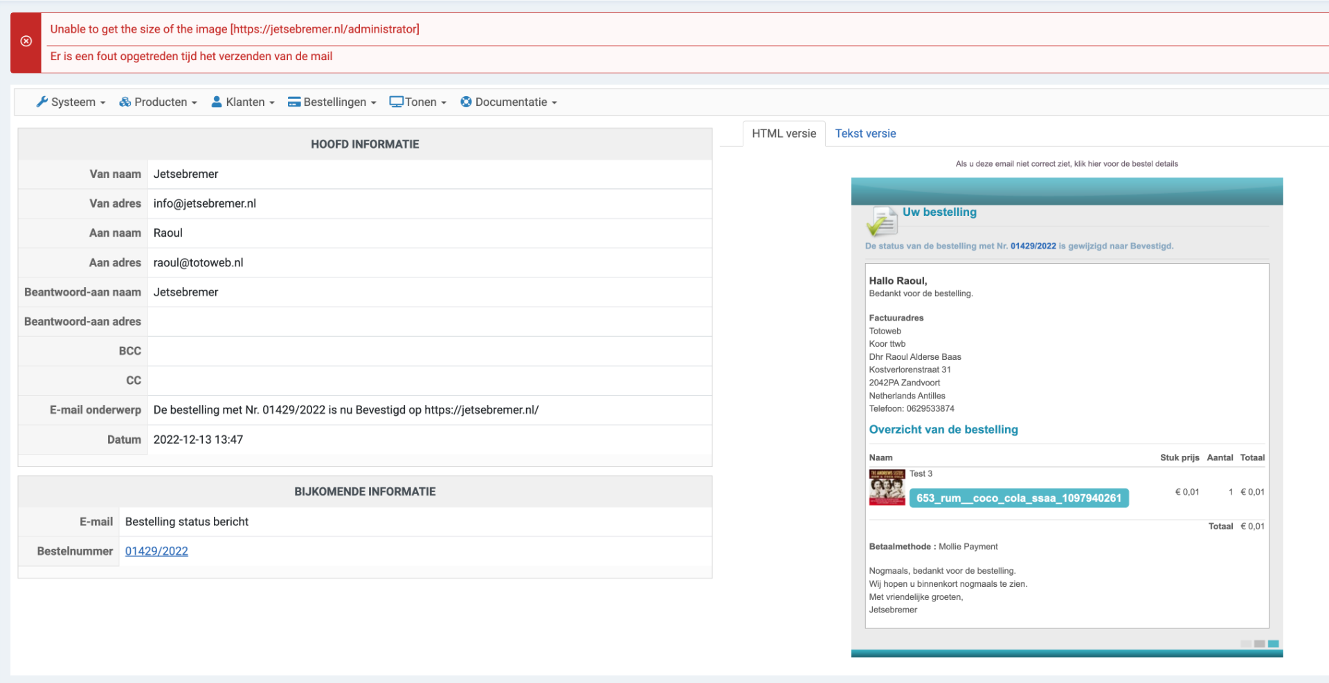

Hi, After update to Joomla 4 we get no invoice and succes mail after payment. Only the email that the order has been created. We are also using the latest attach pdf plugin. How can we solve this?
I see now that the mail is created but if I want to resend it I see this error > Unable to get the size of the image [ jetsebremer.nl/administrator ]
Er is een fout opgetreden tijd het verzenden van de mail

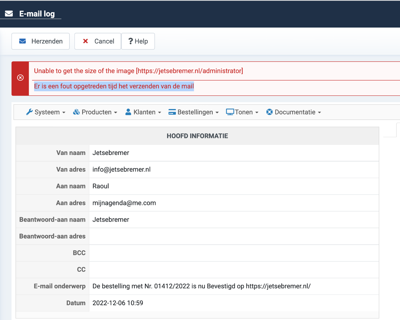

Hi, We still run in the same error after the patch. See screenshot if I try to resend the email.
Kind regards,
Raoul
Kind regards,
Raoul
