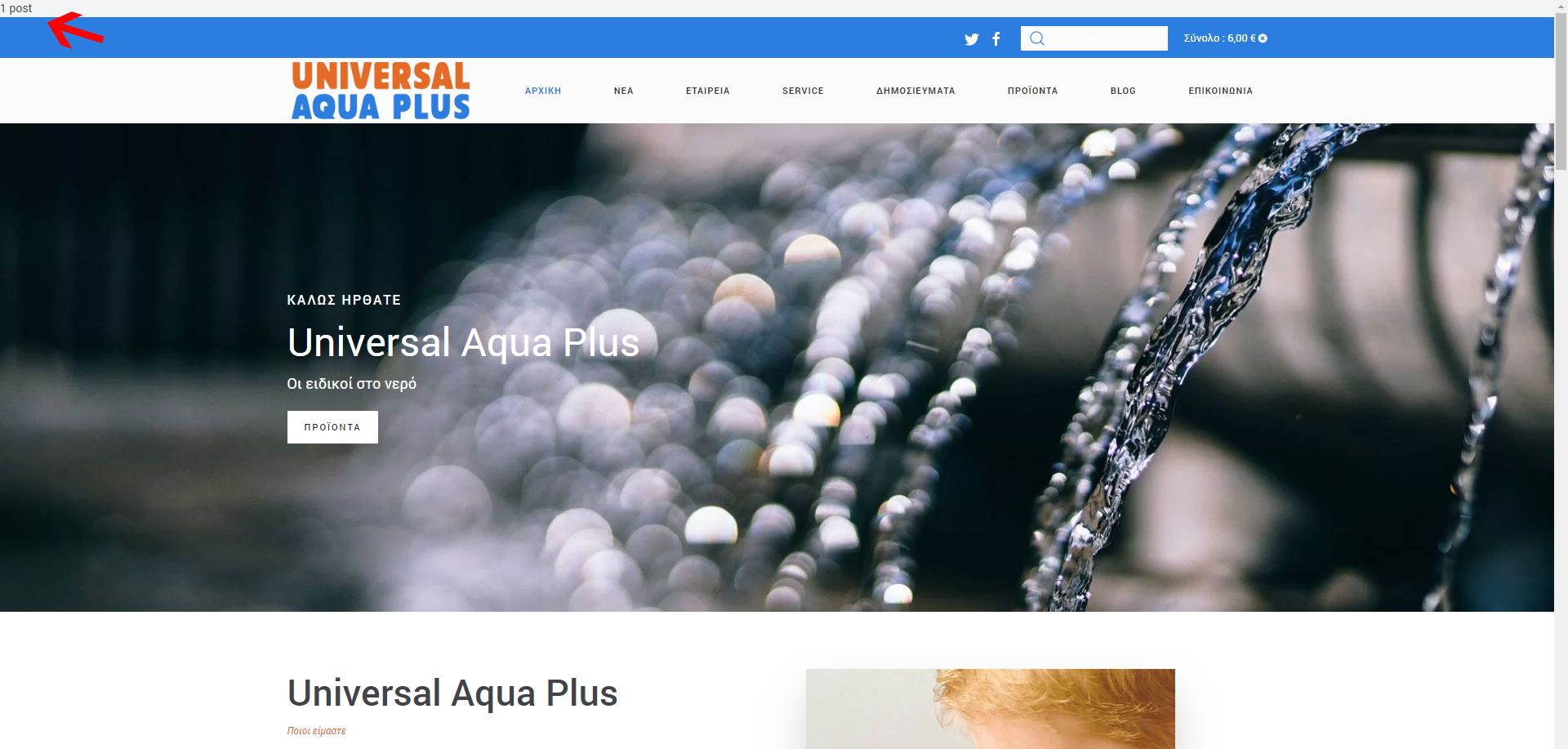

There's just one thing in all Yootheme pro pages, at the top of the page it says "1 post", what is that? It doesn't show up at Hikashop pages though.
I contacted Yootheme's support and they said this:
The string "1 Post" might possibly originate from your 3rd party extension "HikaShop". If the issue persists, try and fully disable "HikaShop" for a test. If the string is not displayed anymore, revise the settings and features of the extension.

Can you please tell me how I can find where this '1 post' at the top of the page is coming from? I disabled all modules to check but still there.
3 years 5 months ago #352137 by nicolas
Replied by nicolas on topic Joomla 4 migrated issue
Switch to the default template of Joomla. Do you still see this text ?
If no, there is a high chance it comes from the template. So check with your template provider.
If yes, there is a high chance it comes from one of the system plugins. So disable them one by one in order to find the culprit.

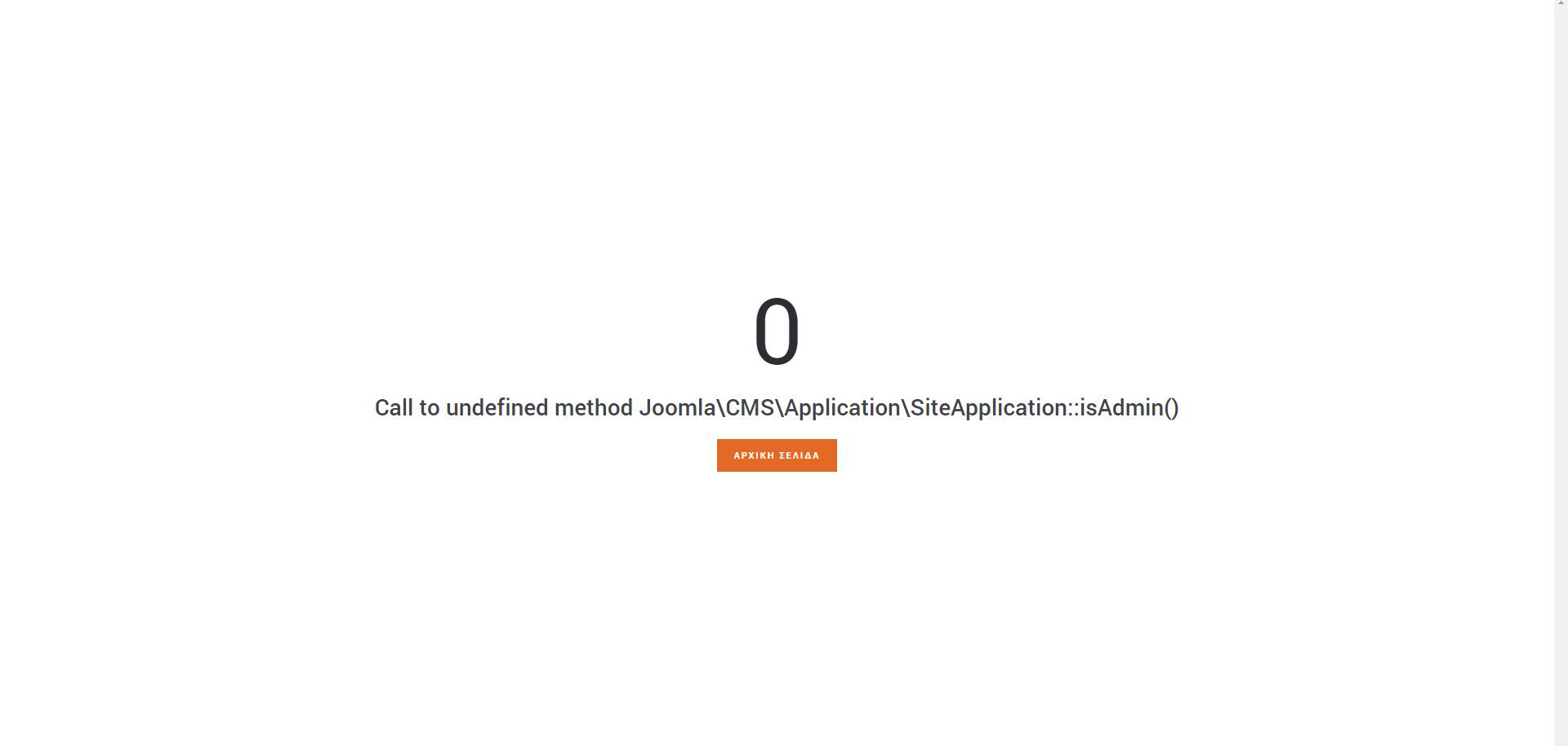

Now there is a problem at checkout complete page, after i click complete order i get this:
0
Call to undefined method Joomla\CMS\Application\SiteApplication::isAdmin()
Any thoughts?
Thank you!

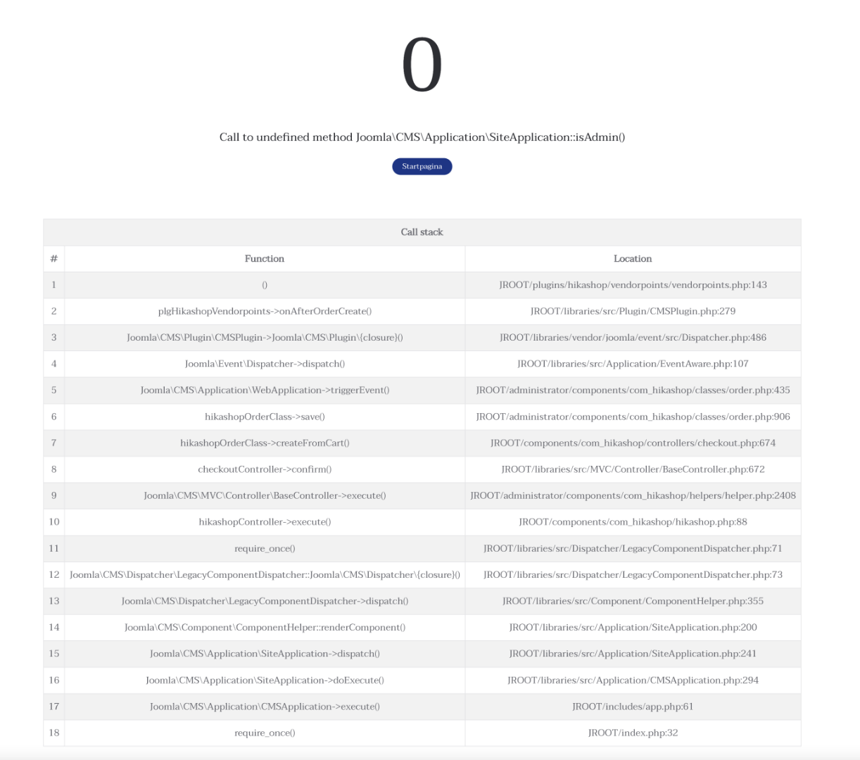

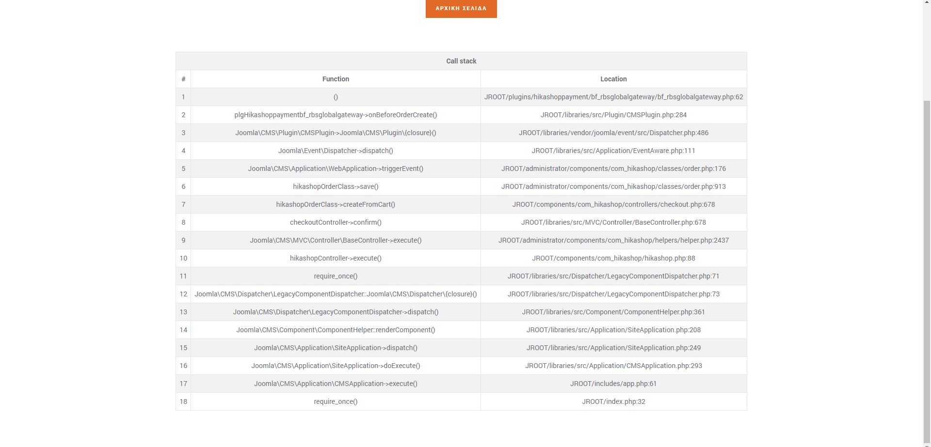

3 years 5 months ago #352558 by verzevoul
Replied by verzevoul on topic Joomla 4 migrated issue
Hi!
Ah okay!
Here is the debug screenshot:
Thank you
3 years 5 months ago #352559 by nicolas
This error means that you're using an old version of the Worldpay Global gateway plugin.
Download the latest version on our website and install it on yours and you won't get the error anymore:
www.hikashop.com/marketplace/product/123...-global-gateway.html
