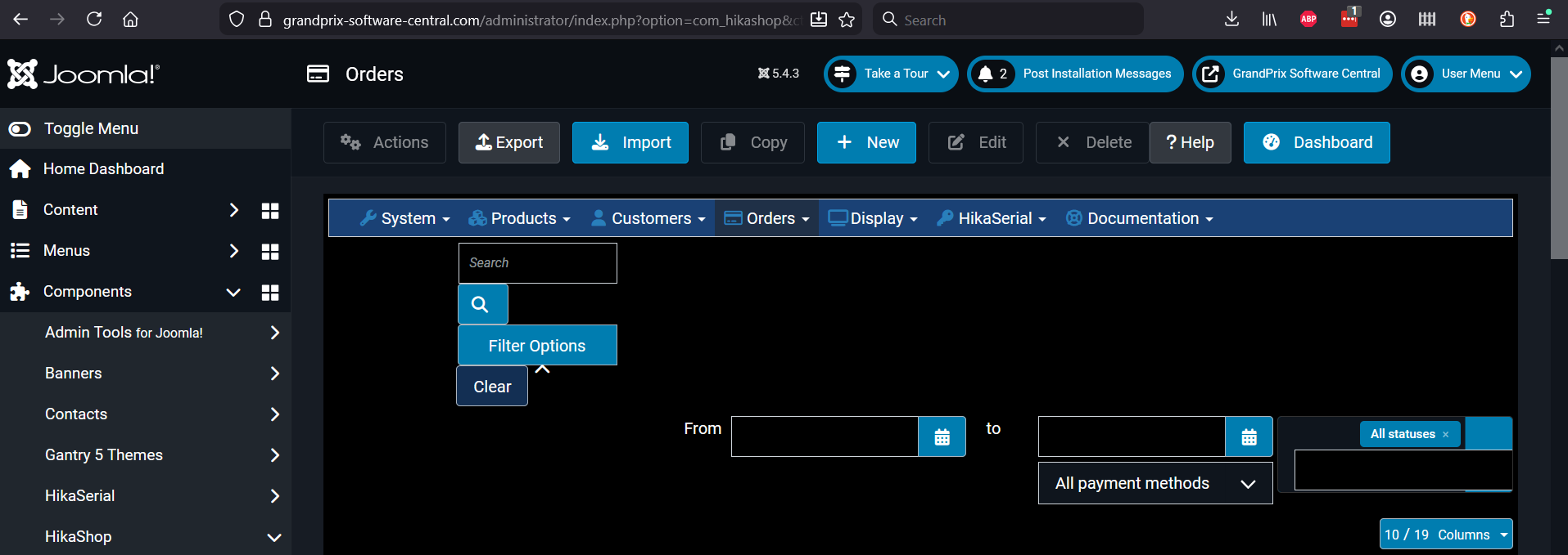

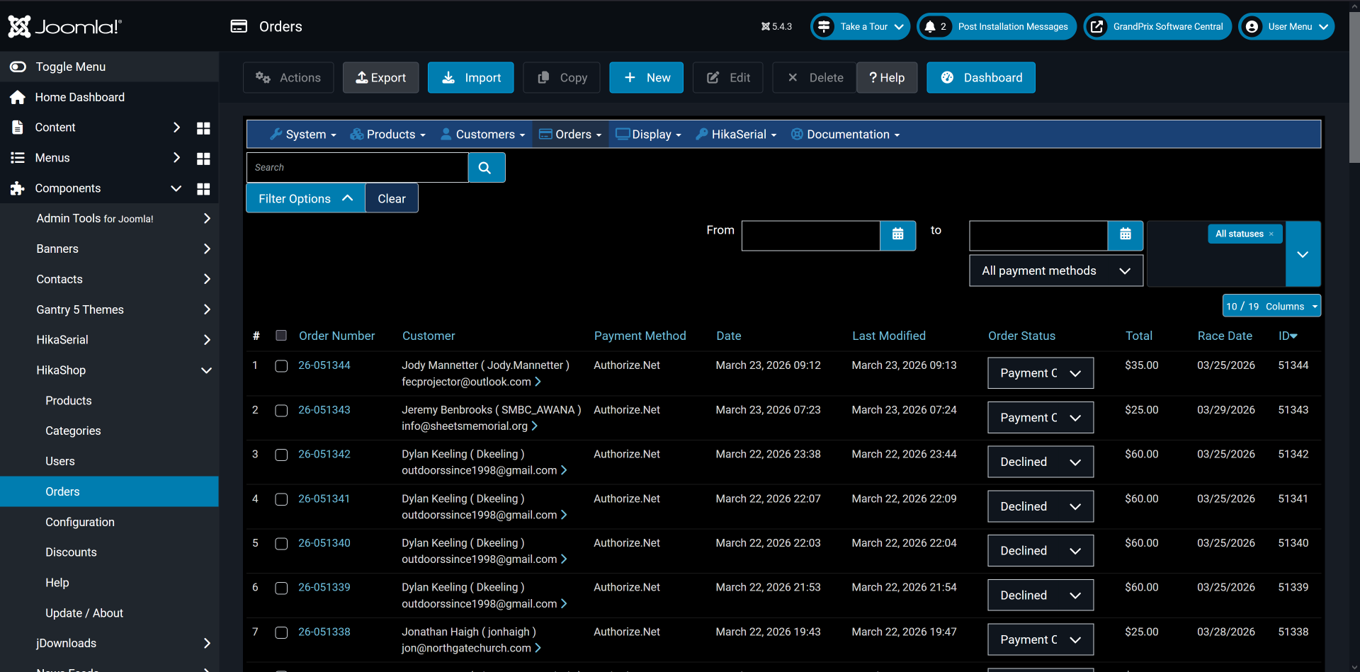

6.4.0 Backend Issues:
+ The filtering options on the Orders page are stacked. They used to be in line, taking up less vertical space. See screenshot.
+ Can the page layout features be disabled, like when editing a product? Even when I deactivate form customization, I still see some of those layout controls. I find that all to be visual clutter for normal use.

8 months 3 days ago #370924
by nicolas
Replied by nicolas on topic Custom Field Validation Issue
Check the "backend CSS" setting under the Display tab of the HikaShop configuration.
What you describe indicates that you're using an old version of that CSS, not the default one and thus you're missing the new CSS we've added for the filters, and the form customization.

8 months 3 days ago #370946
by gpraceman
Replied by gpraceman on topic Custom Field Validation Issue
I switched to default backend CSS. That improved it somewhat, but it's not all inline. See screenshot. That did clean up most of the visual clutter I was seeing when editing a product.
