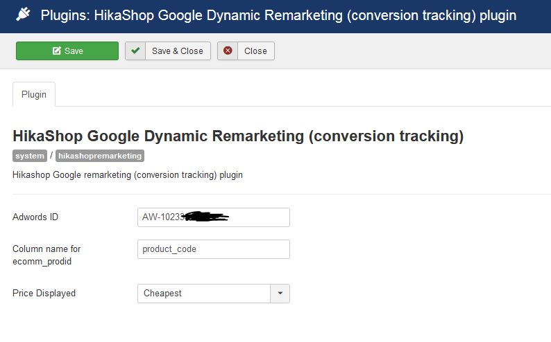

Hi, I'm struggling to find a working solution to this both in your documentation and on the forum. I've recently signed up to google ads and I'd like to track the number of conversions (sales).
I've edited the file after_end.php with the following code (ads account changed) as advised on google ads;
Plenty of sales have gone through but Google Ads is still seeing as unverified (which means it's not working).
a) Am I adding it to the correct file in Hikashop?
and b) what does the plugin - HikaShop Google Dynamic Remarketing (conversion tracking) actually do?

2. This plugin allows to link the adwords and the display of product details pages:
support.google.com/google-ads/answer/2476688?hl=en
It's different than linking sales to adwords like you're trying to do.
