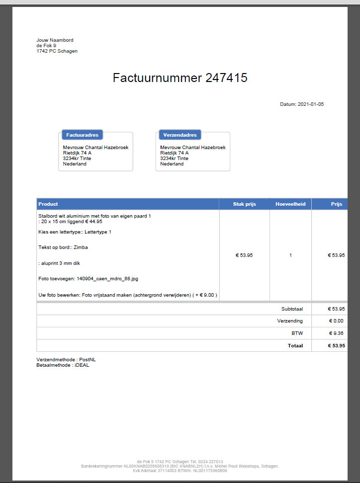

I just purchased the latest attach pdf invoice plugin. For some products (or options) the textline is longer. This breaks the pdf layout, see screenshot. In the "old" plugin I didn't have that problem. How can I solve this?

From what I can see, the issue comes from the name of the option which is too long.
There is already code to avoid that for the product name, but there is indeed no code to handle that for options.
However, that was never the case, so you must have had the same issue before but never noticed.
To fix that, change the code:
to:
in the file plugins/hikashop/attachinvoice/attachinvoice/invoice.php
Code:
echo $optionElement->order_product_name;
if($optionElement->order_product_price>0 && !$this->shipping_invoice){
if($config->get('price_with_tax')){
echo ' ( + '.$currencyHelper->format($optionElement->order_product_price+$optionElement->order_product_tax,$order->order_currency_id).' )';
}else{
echo ' ( + '.$currencyHelper->format($optionElement->order_product_price,$order->order_currency_id).' )';
Code:
$option_name = $optionElement->order_product_name;
$option_name .= ' ( + '.$currencyHelper->format($optionElement->order_product_price+$optionElement->order_product_tax,$order->order_currency_id).' )';
}else{
$option_name .= ' ( + '.$currencyHelper->format($optionElement->order_product_price,$order->order_currency_id).' )';
echo '<p>'.implode('<br/>', $this->str_split_unicode(strip_tags($option_name),50));

Thanks for your solution. There must be some small mistake in the code, after changing I get the errormessage: "1 Tags are closed in a wrong order for [td]"

Ah yes, the line :
should be:
echo '<p>'.implode('<br/>', $this->str_split_unicode(strip_tags($option_name),50)).'</p>';

Yes, thank you, this works fine!
