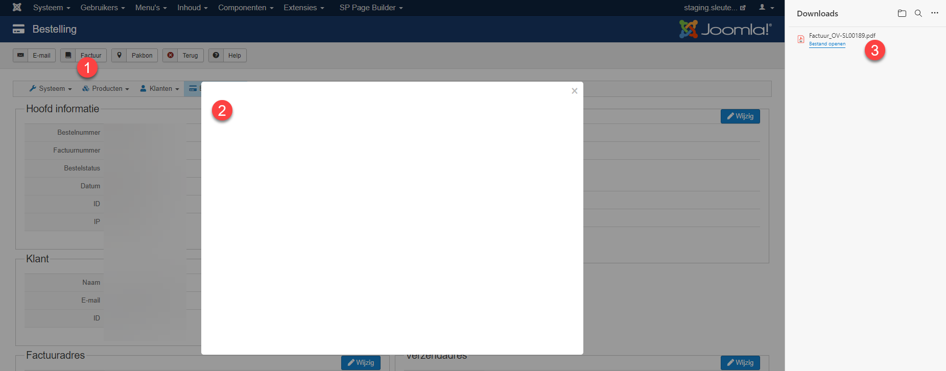

I use already a long thime the attach invpoice plugin that generate pdf invoives and addn them to an email. That is working fine.
One thing is a little strange. HWe I got to orders and want to generate an order manualy, it is genarting the invoice (it's downloading to my computer) wich in fine, but after download the popup screen stays empty. It would be nice if there was a message telling download went fine or the popup don't need to show up.
IS this the behavoir of the plugin or did I do something wrong?
See image for extra explanation.
1: Press on th button onvoce
2. The popup appears
3. file has been downloaded.
The screen stays empty.

I don't have that white popup with the PDF invoice plugin on my end.
I suppose you must be using an old version of the PDF invoice plugin and you don't have the patch we've added a year ago:
www.hikashop.com/forum/orders-management...opup-on-invoice.html
Download again the install package of the plugin via the link provided on your order details page on our website in order to get the latest version and install it on your website. It should fix the issue.
Note that if you've customized the PDF invoice without doing it with an override file, you'll loose your customizations so make sure you make them up before updating the plugin.
