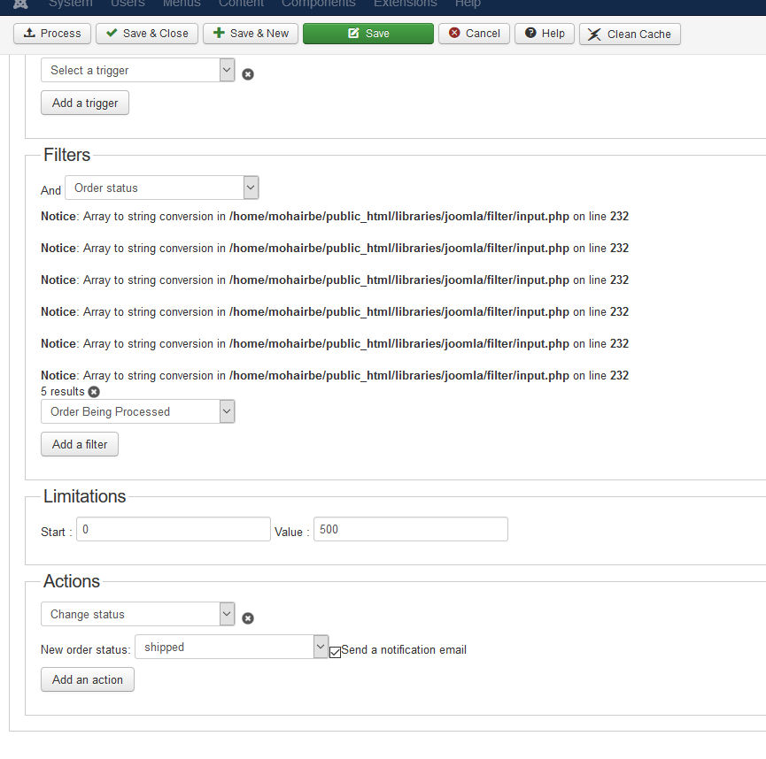

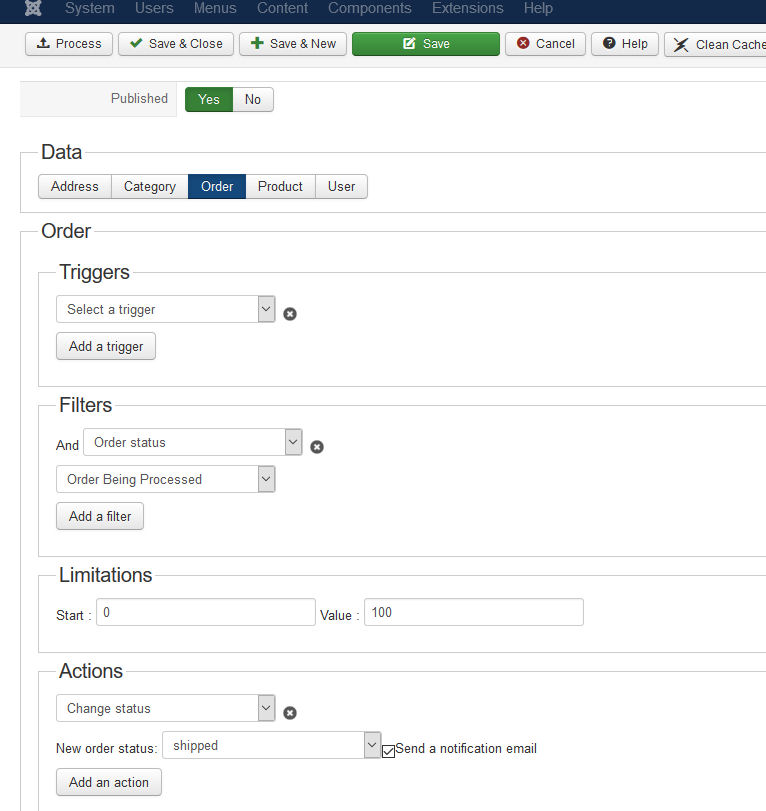

Hi I have been using a mass action for quite a while now and for the last 2 days it has stopped working? when applying the action the page just goes blank and hangs? see below my configuration

If you have a full blank page ; please check your PHP error log because you should have a PHP fatal error.
Just like that and regarding your screenshot, I could suppose that you have an override for the notification email and that override might contains an error.

Turn on the "error reporting" and "debug mode" setting of the Joomla configuration. That should display an error message on the blank page when you process the mass action. Please provide it and we"ll be able to tell you what's going on.
The issue is probably that the mass action system finds too many orders and sending emails can take a lot of work on the server, so above a few orders to process at the same time, it will crash if the server's restrictions on memory and execution time are too low. A simple solution in that case is to reduce the limit value of your mass action (the 100 value) to only a few orders (2 or 3 for example) and that should then work properly if the issue comes from that.

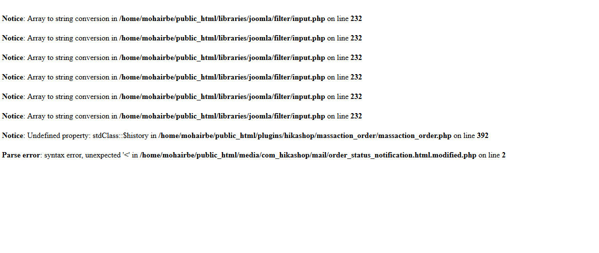

11 years 1 week ago #215441
by mohairbears
Replied by mohairbears on topic Mass Action stopped working
11 years 1 week ago #215448
by nicolas
Replied by nicolas on topic Mass Action stopped working
The error message says that you've modified the html version of the order status notification email incorrectly and broke it. So when the system tries to send the email, it crashes.
Fix your modifications there or remove the customization of that email and it will work.

Hi, Ok then, I found this in a post form you stating to put it in that email in HTML (with the correct email address of course)
<?php if($data->order_status=="confirmed"){ $mail->bcc_email = 'xyz@xyz'; } ?>
So where in the HTML should it be placed for it to work correctly?
thanks
thanks
11 years 1 week ago #215536
by Jerome
Replied by Jerome on topic Mass Action stopped working
You should not place the code in another "<?php ?>" block.
Otherwise you have to remove the "<?php" and the "?>" in your code line ; which delimit the PHP code content.

Thanks Jerome, I really should have known that, bit of a school boy error on my part.
