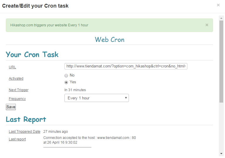

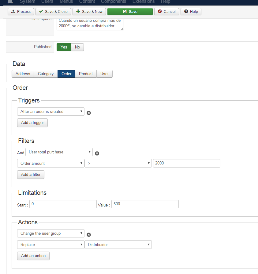

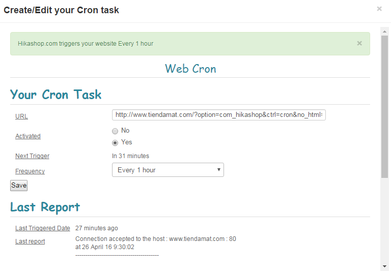

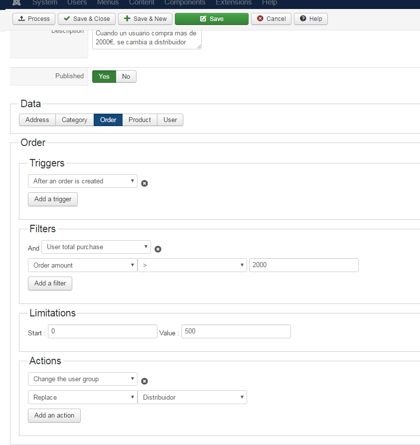

hi Nicolas,
I did what you said, and got a notification email saying that:
HikaShop Activado a 2016-04-26 07:15
Tasas de cambio actualizadas satisfactoriamente (that is change value €-$)
Here are the screenshots of the configuration:

Well, it's normal looking at your mass action settings.
You've configured the trigger to be "after an order is created" so the mass action will run each time an order is created and only for that order.
If you want your mass action to run periodically using the cron system, you need to change the trigger to use one of the choices: every minute, every hour, every day, every week, every month or every year.

now works perfect. Thank you very much, Nicolas!
