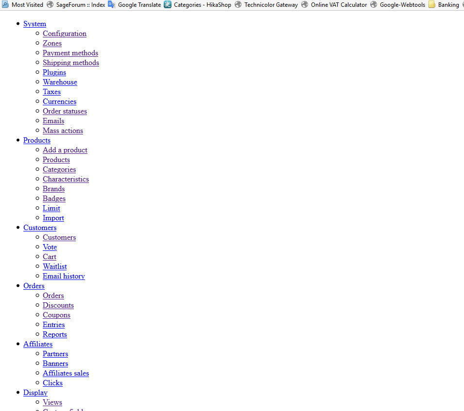

Hi, I use Mass Action on a daily basis and now this morning I cannot get in to any of my saved actions? when I click on the links to get in to the actions it just goes to what is shown in jpg 2?

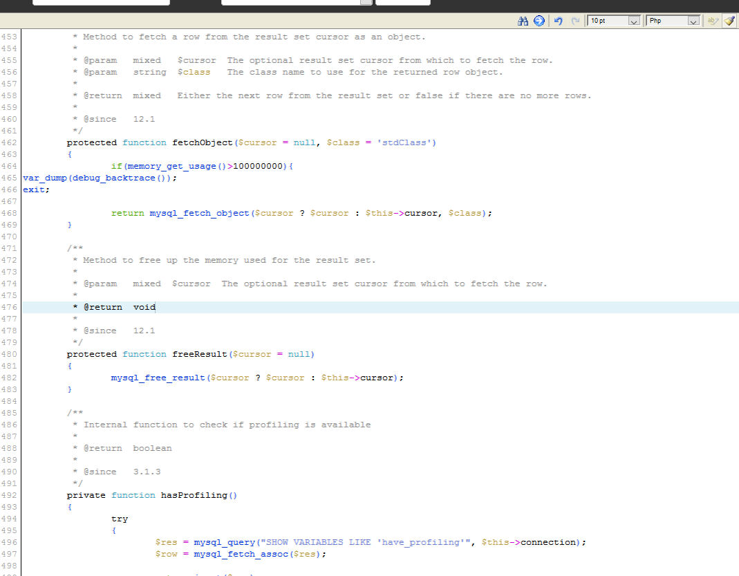

10 years 2 months ago #250583 by mohairbears
Replied by mohairbears on topic Mass Action error
I have solved the Global error I had made a copy of the original sql file and it appears not to like having a copy in the same folder.
Right see the2 screen dumps sql_1 shows the last code you supplied entered on line 464, this just give a blank screen but as you can see in sql_2 I removed the } and it now give this error;
Parse error: syntax error, unexpected 'protected' (T_PROTECTED) in /home/mohairbe/public_html/libraries/joomla/database/driver/mysql.php on line 480
Line 480 is visible in sql_2
thanks

10 years 2 months ago #250621 by mohairbears
As I said above the Global issue has been resolved and was caused by creating a 'copy' of mysql.php and calling it 'mysql_copy.php' by deleting this file the global is ok again, now the only issue I have is with mass actions and the 'orders plugin'
The closing bracket was there but it looks like I have used the same screen dump twice, with he closing bracket there all I get is a 'blank page'
The only way to get an error message is to remove the closing bracket.
I have not linked anything to the data and I can only assume as I have a high volume of orders that this si somehow causing the problem? I cannot really delete and orders and they are there for customers history.
