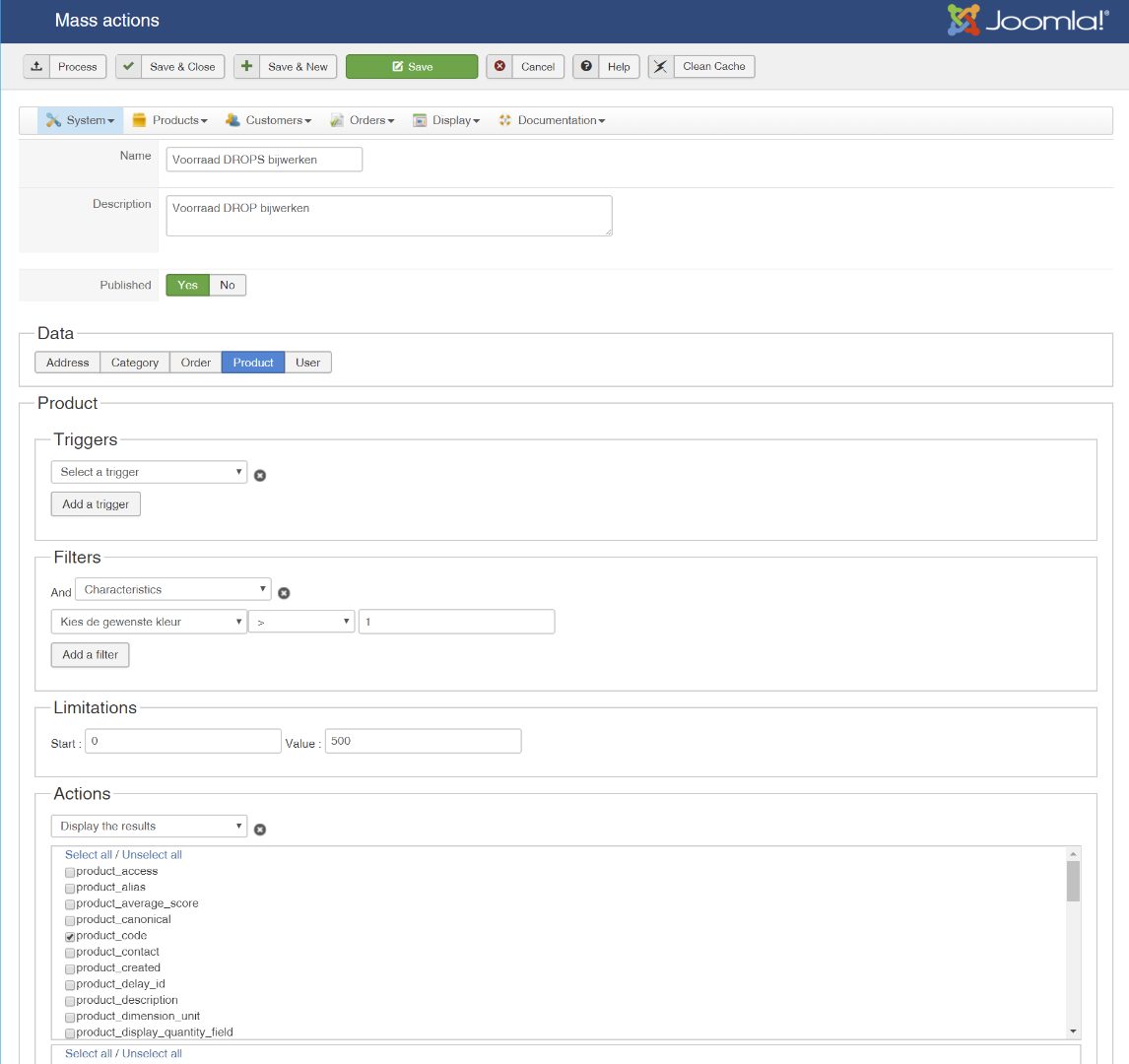

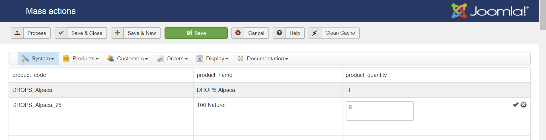

Hi Hikashop team,
My customer like to update the stock with the option to display results on the screen and edit the fields.
But there are so many products that it would be handy if the products are ordered.
Now it's ordered chronological so the last new product is all the way at the bottom.
But when you have different categories for product it's a lot of work to go up and down to find the right product to update the stock.
So the question is.
Is there a way to sort the results? For example alphabetically or in another way. Everything would be helpful
Hope you can help us with this issue.
Kind regards,
Lumiga

In your mass action filters area, you can add a filter "ordering" and a filter "ordering direction" in order to configure the sorting of the results.
