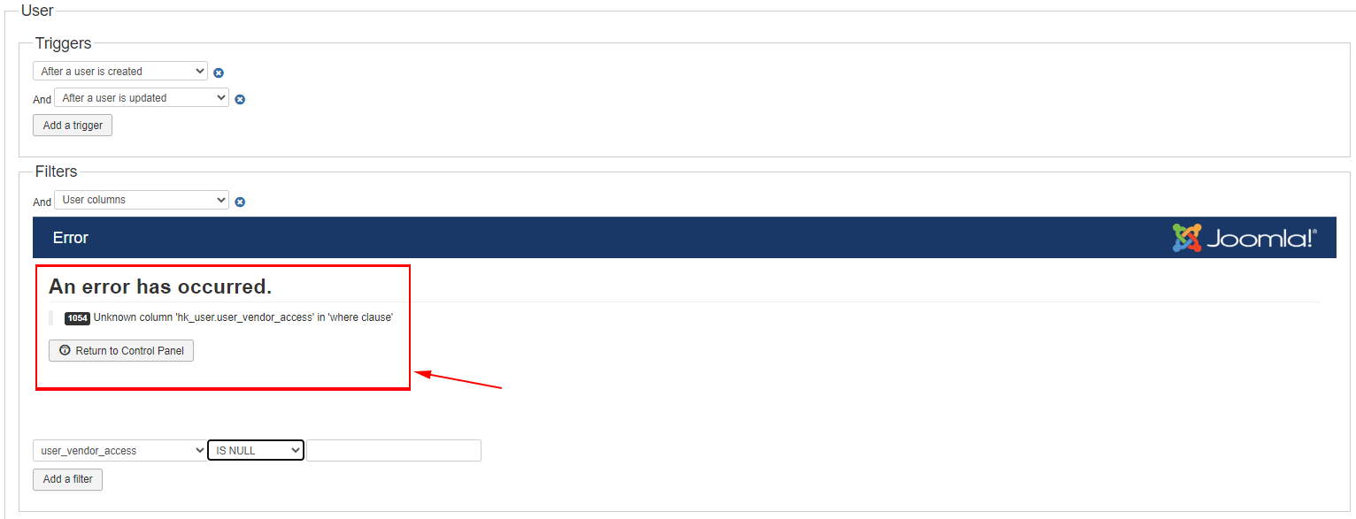

While searching to find a way to solve the issue of HikaMarket vendor ACL not being updated when the joomla is updated, we run on to a new issue with the Mass Actions when setting filters.
Please check screenshot to see the problem

6 years 4 months ago - 6 years 4 months ago #318850 by liaskas
Here is what it shows now...
i CHANGED the database table prefix to " xxx "
An error has occurred.
1054 Unknown column 'hk_user.user_cms_id' in 'where clause' SELECT COUNT(DISTINCT hk_user.user_id) FROM xxx_hikashop_user as hk_user LEFT JOIN xxx_users as joomla_user ON joomla_user.id = hk_user.user_cms_id WHERE (`hk_user.user_cms_id` IS NOT NULL)

6 years 4 months ago #318886 by Jerome
The query do not correspond to the previous screenshot of your mass-action configuration.
More than that, it is nearly impossible to not have the "user_cms_id" column in your database, otherwise your HikaShop store won't work at all (and the "left join" wouldn't work too).
I don't know what is your Mysql version but right now, the only potential issue I can see is the fact that the column in the "where" clause is quoted..
But we can't guarantee anything since we have a SQL query which is not related to a mass-action configuration and the issue is different than your first post.
So please provide a full and homogeneous example.
You can also copy your SQL query and process it in "phpmyadmin" ; but please be sure to right copy/paste it (there and here too).

6 years 4 months ago #319010 by liaskas
This is possible because i am not able to save anything so maybe i i have chosen something else in my Mass action filter. But the error is there! Maybe another error, but this needs fixing too.

6 years 4 months ago #319022 by nicolas
What Jerome means is that since it's a new error message it would be great that you tell us how do you get that error (on which page and by doing what ?) so that we can better understand the situation.
Also, this error you posted "Unknown column 'hk_user.user_cms_id'" means that the whole store should be broken. Is that the case ?

6 years 4 months ago #319046 by nicolas
Thank you for the access. I was able to reproduce the issue and found where the problem is coming from.
I've added a patch on our end to fix the problem. Download again the install package of the 4.3.0 on our website and install it on yours and it should work properly after that.
