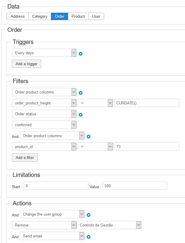

-- Error-message(debug-mod must be tuned on) -- : Mass action is not executed
I'm trying to create a mass action that runs every day and checks if the field order_product_height is today.
If it is, then it checks if the product_id = 73.
With these conditions, I want to remove the user from a user group.
This action isn't happening.
I've built the action as per attachment, and just to check if the filters were working I've set an additional email message. This email is sent, but not the removal of the user group.
Also, I have another mass action that adds users to groups that is working, so why isn't this one?
Thanks!

Well, first you need to check that your cron task is running:
www.hikashop.com/support/documentation/5...cron-task.html#check
Otherwise, the "every day" trigger won't work.
Then, you need to check that the value you have in order_product_height has the same format as what is returned by the curdate mysql function.
Also, note that the access level modification might have been done, but the user might have to logout / login to see the change as the access levels of the current user are cached in the user session data by Joomla.

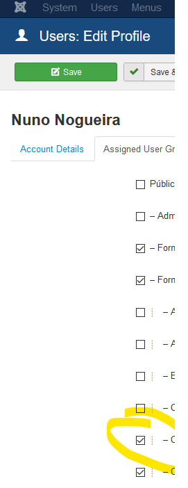

Hello Nicolas,
The crons are working no doubt, we have other mass actions.
In the attachment, you may see an example:
1- The value of order_product_height is today: 20210208.000
2- The product_id is 73
3- The user has not been removed from the group we want to remove him.

Your problem is with the order_product_height condition.
The value returned by the curdate function is with the format "YYYY-MM-DD" :
www.w3schools.com/sql/func_mysql_curdate.asp
So it's not compatible with what it stored in that custom field.
You need to use date_format in order to generate a date in the same format as stored in that column :
www.tutorialspoint.com/change-the-curdat...0use%20date_format() .

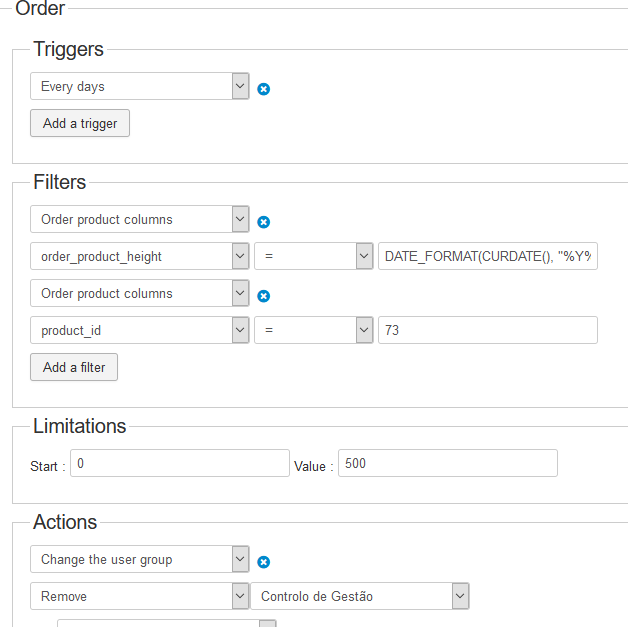

Now I have 2 mass actions:
1- To add users to a group when they buy product 73 and when the order is confirmed. This adds 62 days to the current date to order_product_height with:
DATE_FORMAT(DATE_ADD(CURDATE() , INTERVAL 62 DAY), "%Y%m%d")
In order_product_heigh I have:
20210412.000
And it adds the user to the product group.
So this one is working fine.
2- To remove the users from the group 62 days later. For this I check if order_product_height is today with:
DATE_FORMAT(CURDATE(), "%Y%m%d")
You may see the details in the attachment.
HERE IS THE PROBLEM: This cron removes the WRONG users to the group. So I'm guessing it is not considering BOTH conditions: product = 73 AND order_product_height is today.
Is this a bug or am I doing anything wrong?

It is an "AND". However, note that the elements searched on are orders, not order products.
So as long as an order has a product with the id 73 and a product with the correct order_product_height, it will match, even if the conditions are only met for different products of the same order.

That cannot be correct, because I only have one order with order_product_height and the trigger is removing users from other orders.
Also, in the "Filters" section it says: "order product columns".

We have find the issue in your MassAction, unfortunatelly in your Filter you have this :
order_product_height = DATE_FORMAT(CURDATE(), "%Y%m%d")
The design of a MassAction can't process an "operation" in your searching value, here, DATE_FORMAT(CURDATE(), "%Y%m%d"), this will only search and compare found value in your DataBase.
So far we didn't see how you can search a dynamic value without some development or use HikaSubscription.
