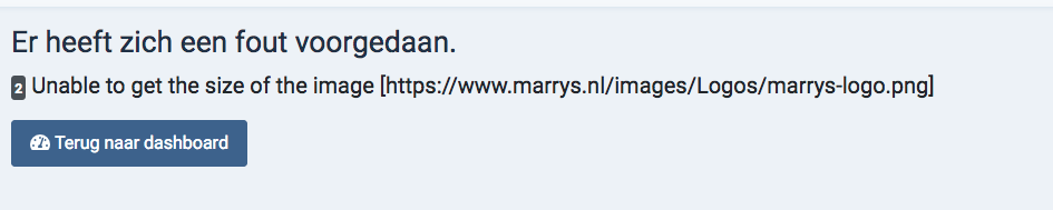

-- Error-message(debug-mod must be tuned on) -- : Er heeft zich een fout voorgedaan
2 Unable to get the size of the image [ www.marrys.nl/images/Logos/marrys-logo.png ]

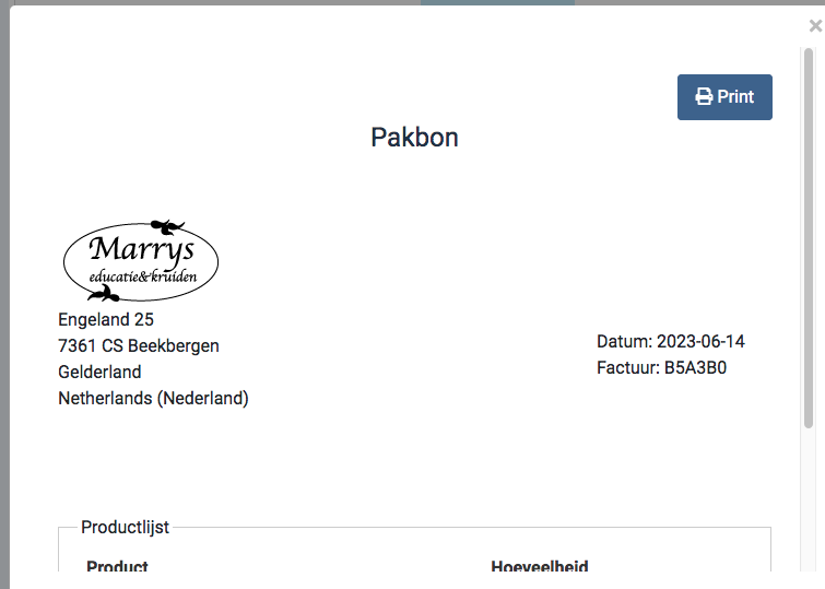

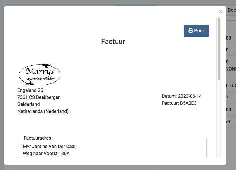

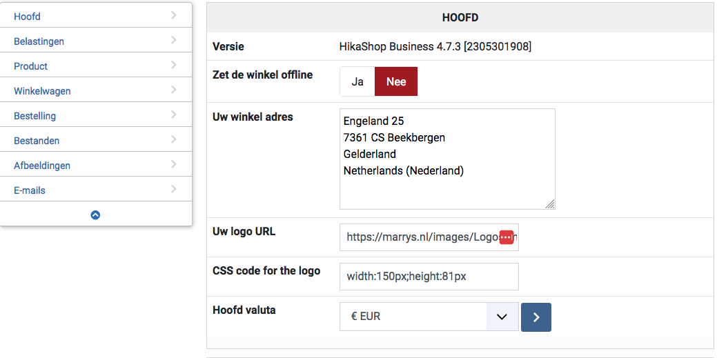

I have installed a logo on the main page of Hikashop. When I skip the plugin Attach Invoice (PDF) 2.0 everything is OK. Or turn it off = OK
But when I put ON I get a error:
Er heeft zich een fout voorgedaan.

This error means that the library the plugin uses to retrieve the image to include it in the PDF is not able to download it.
So it's a server configuration issue.
It could be that file_get_contents or cURL is not available on the hosting, or allow_url_fopen or allow_url_include are turned off:
stackoverflow.com/a/28007106
It seems you're saying allow_url_include is turned off on your hosting so that might be the reason. It could also be that ini_get is not available or not returning the correct value for some reason.
I would recommend checking with your hosting support what can be done. Unfortunately, since it's a server configuration issue, there is not much we can do on our end.

It is best to change the URL to the relative URL. If the script containing the URL is in the folder www.marrys.nl , you need to change the URL to images/Logos/marrys-logo.png.
I have tried to change the URL but have the same error. I have the URL deleted in the configuration.
Is it possible to change the source of the plugin lay-out of Attach Invoice 2.0? Than I will try to put the logo inside the html source of the PDF. Is that possible?
