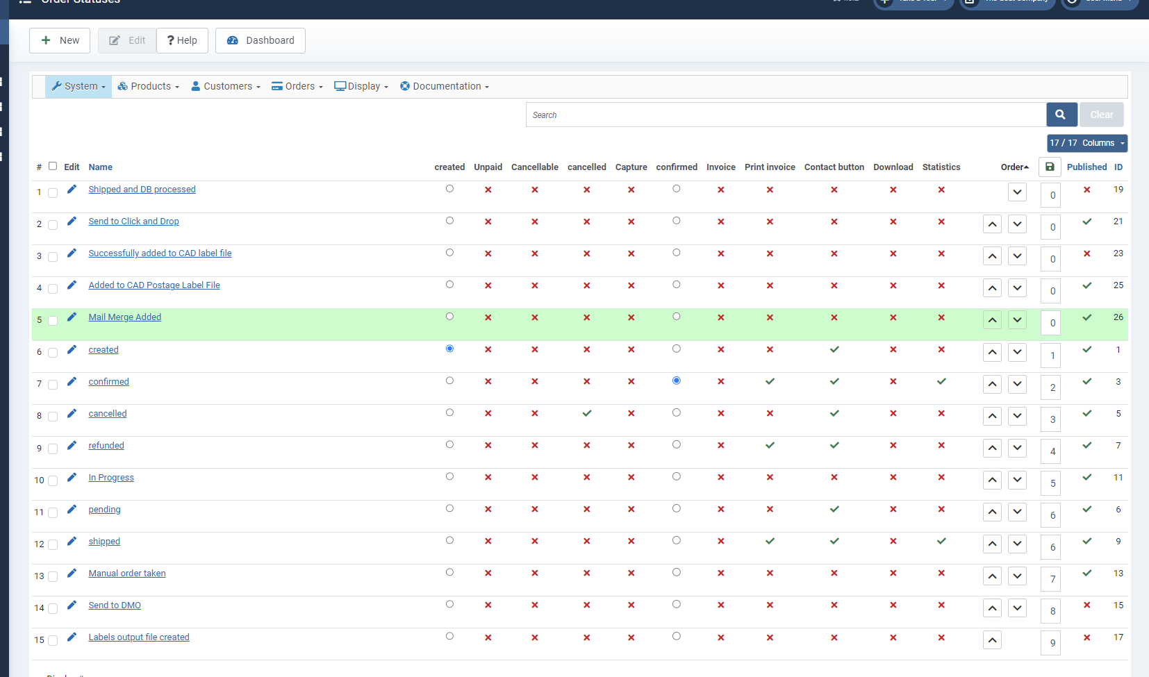

Everything looks fine on the frontend side of things. I can see that the user is first redirected to the standard HikaShop cancel order URL, which should first cancel the order and then redirects to the URL you specified in the payment method.
So if the order is not being cancelled, It's not a problem with the plugin, but an order status configuration issue I think.
Could you provide a screenshot of what you have in the System>Order statuses menu ?

3 years 3 months ago #353339
by ianspeed
Replied by ianspeed on topic PayPal Checkout - problems with cancel return and purchase
3 years 3 months ago #353340
by nicolas
Replied by nicolas on topic PayPal Checkout - problems with cancel return and purchase
That's the issue. The "created" status needs to be enabled either in the "unpaid" column or in the "cancellable" column (or both).
Since it is disabled in both, the status is not changed to cancelled by HikaShop and it just redirects to the checkout.
Note that by default "created" is enabled under the "unpaid" column.

3 years 3 months ago #353343
by ianspeed
Thanks Nicolas,
Not sure how that ever got changed as it wasn't something I ever did anything with? That's why it isn't working in live either, it just stopped one day.
I think the owner of the website was probably fiddling with stuff!!
