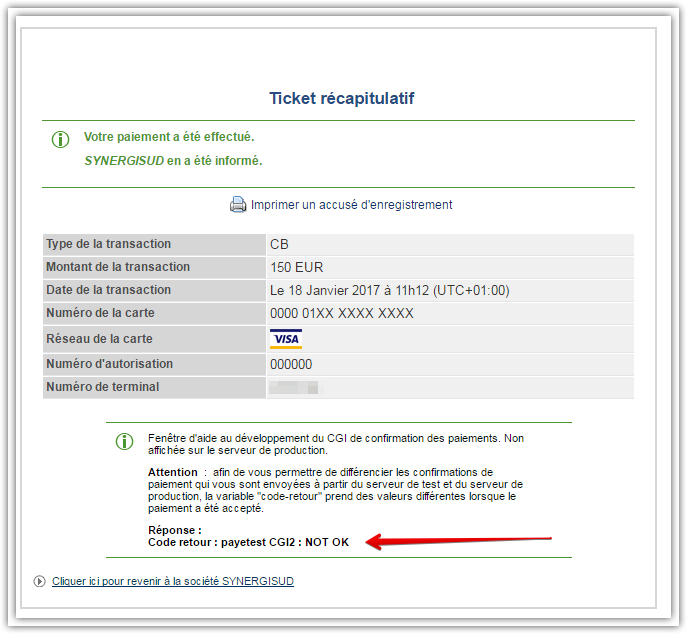

Once we place an order and go to the test platform, the payment process goes fine until the end where we get an error (see attached screenshot):
CGI2 : NOT OK and all our orders are canceled, payment not valid...But our bank say that the payment has been accepted, just the "acccusé de réception" is not valid form the bank I get this "REQUETE EMISE PAR NOTRE SERVEUR : http://:80?"
Can you please tell what's wrong ?

Regarding the payment with the CM-CIC HikaShop either sends back:
version=2
cdr=0
or:
version=2
cdr=1
if the order is confirmed or not.
Both are valid responses.
Turn on the debug setting of the payment method and do a test payment again. Then, look at the payment log file in the HikaShop configuration. It should contain valuable debug information in order to understand what's wrong.
PS: The latest stable version is the 3.0.0 since this morning
www.hikashop.com/blog/367-hikashop-3-0-out.html
