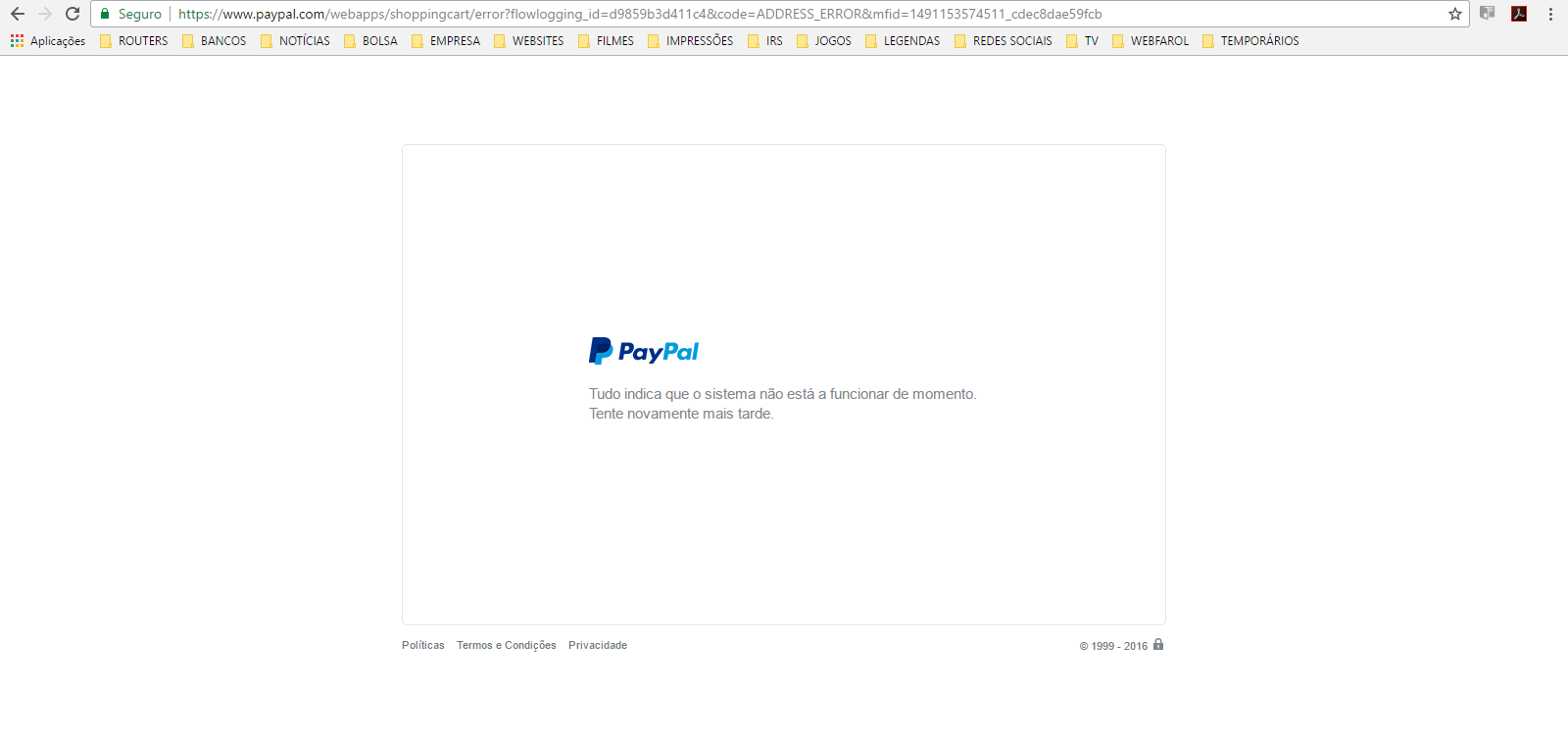

9 years 6 months ago #266376 by webfarol
Paypal payment dont work.
After confirm payment and redirect to paypal page it goes to the url
www.paypal.com/webapps/shoppingcart/erro...574511_cdec8dae59fcb

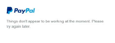

Same with me !!!!
Joom 3.6.5
Hka 3.0.1
Suddenly no one can pay.. just happened today.
Paypal error is "Things don't appear to be working at the moment. Please try again later."
Paypal URL is
www.paypal.com/webapps/shoppingcart/erro...923990_f13b1c88c799e
My site is http only ... has this anything to do with it? (I have other older sites and they work fine, but are https)
url for site is www.tarb.com.au/assessment-book-orders/personal-order.html
But i have closed the site til this is fixed.
Contacted Paypal and they said "shopping cart button needs update"...I dont
know what this means.
