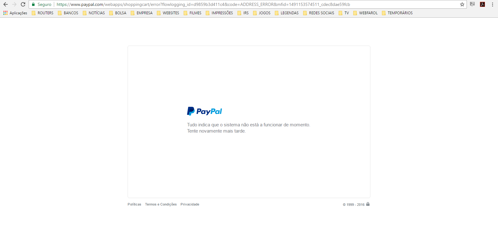

Paypal payment dont work.
After confirm payment and redirect to paypal page it goes to the url
www.paypal.com/webapps/shoppingcart/erro...574511_cdec8dae59fcb

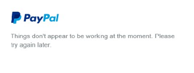

Hka 3.0.1
Suddenly no one can pay.. just happened today.
Paypal error is "Things don't appear to be working at the moment. Please try again later."

I am encountering the very same problem! What is strange is that it affects some, but not all customers. So far it has affected ~ 50% of the customers who tried to purchase my products. Below is a screen-shot sent to me by a customer.
As I mentioned, it seems to affect certain customers, not certain purchase buttons: some people purchased product X from my site without any problems, while other people were unable to buy it.
I asked the customer who sent me this screen-shot, to try to purchase other products from my site. He faced the same problem, no matter the product he tried to buy.
Also, this doesn't seem to be related to certain countries.

I forgot to add this piece of information: I asked the customer who sent me the screen-shot, to try and login directly to his PayPal account (by typing www.paypal.com in the browser's address bar): he logged in without any problems. So, the issue occurs when Hikashop transfers the customer to Paypal.

We got an access from emmdee and did a test on his website and got the error message from PayPal.
However, the data sent to PayPal is all but normal as far as I can see, so I don't see any reason for that error:
monosnap.com/file/GTG5exMap8tI3qJGTIJyUXHVICoCdB
So I looked further into it and found this page:
www.paypal-knowledge.com/infocenter/inde...lse&viewlocale=en_US
Which explains that the checks on the variables passed to PayPal have been improved since the beginning of April.
All the examples mentioned in that page are already OK for HikaShop though.
I went further and look here www.paypal-community.com/t5/PayPal-HTML-...?profile.language=en but again, most of the things mentioned there are already done in HikaShop by default since years.
In there though, I stumbled upon a post which mentioned providing prices with two decimals and which could explained why it still works for most people and why on the same website, it might work for some products and not for others. While nothing is mentioned about that in thePayPal documentation ( developer.paypal.com/docs/classic/paypal...dual-items-variables ), I've done the modification for that in the PayPal plugin.
