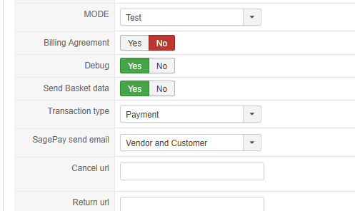

  • Posts: 34
8 years 2 months ago #295629
The field only shows the option as yes/no
Are you saying to swap it to no?
See screen shot attached
thank you
Caroline
Last edit: 8 years 2 months ago by cmoorhouse.
  • Posts: 26389
  • Thank you received: 4078
8 years 2 months ago #295631
Please set the value to "no".
PS : Please be careful with your screenshot to not share personal credentials (even if it's test credentials).
