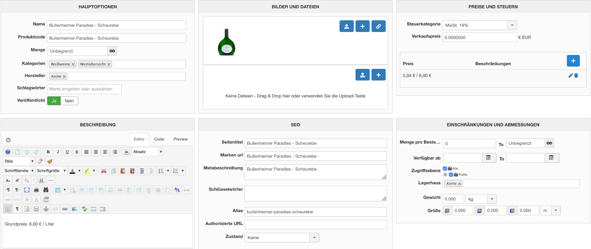

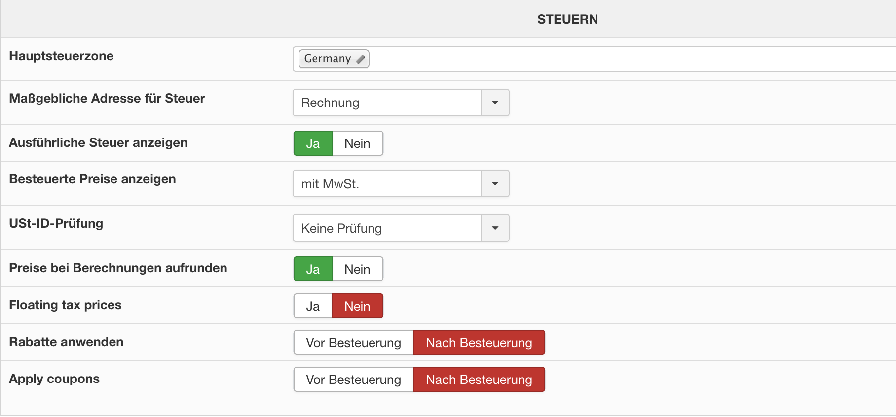

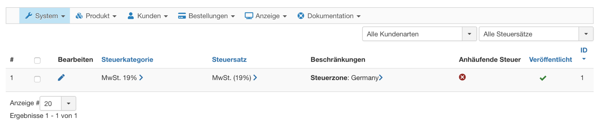

If changing that setting doesn't help, we would need more information on your exact setup to be able to help:
- screenshot of the taxes listing in the System>Taxes menu.
- screenshot of the settings of your product settings.

Hey Nicolas,
thank you for your reply.
As an attachement I send you the screenshots.

Hi and thank you for your ideas,
I tried first without rounding prices and it didn't work, so I turned it on. Now I turned it off again and the problem is still present.
The price in the product configuration is already 5.04202 and when I put 10 in the cart it's shown 59.98.
