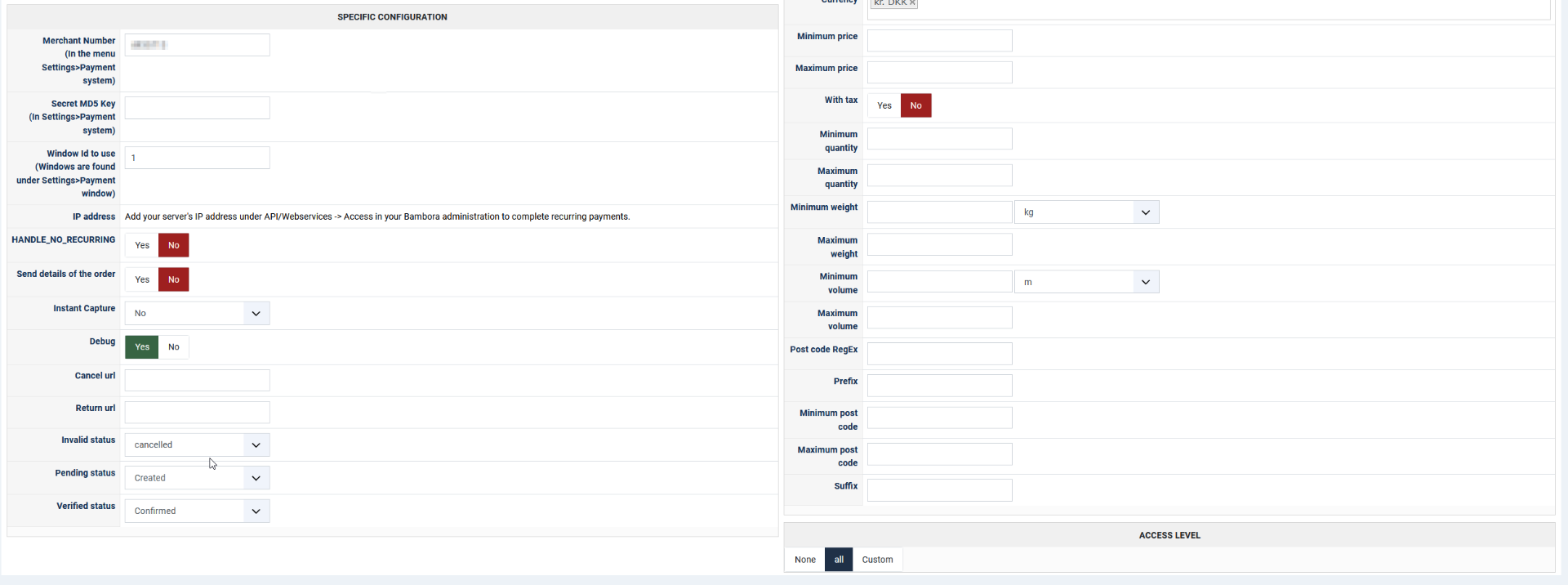

I cannot get the shop to display both my payment options. I have the following options:
Hikashop Bambora Payment
Hikashop bank transfer payment plugin
It only shows the bank transfer and not the Bambora option (Credit card). Both are enabled, I am not sure what goes wrong.
Both pluins are enabled and set up the same
  • Posts: 86080
  • Thank you received: 14186
2 years 6 months ago #359124
The Bambora payment method has an option "HANDLE NO RECURRING". If that option is turned off, then it will only appear when the products in the cart are subscription products (linked to a subscription plan from the HikaSubscription extension) with the recurring payment mode activated (so that payment for the renewal of the subscription is automated).
I can see you don't have HikaSubscription, so your products is normal products. If you want this payment method to appear during the checkout, this "HANDLE NO RECURRING" setting needs to be turned on.
The following user(s) said Thank You: WebmasterRD
  • Posts: 26
2 years 6 months ago #359139
Fantastic - that was so simple and I did not see that - thx a lot
