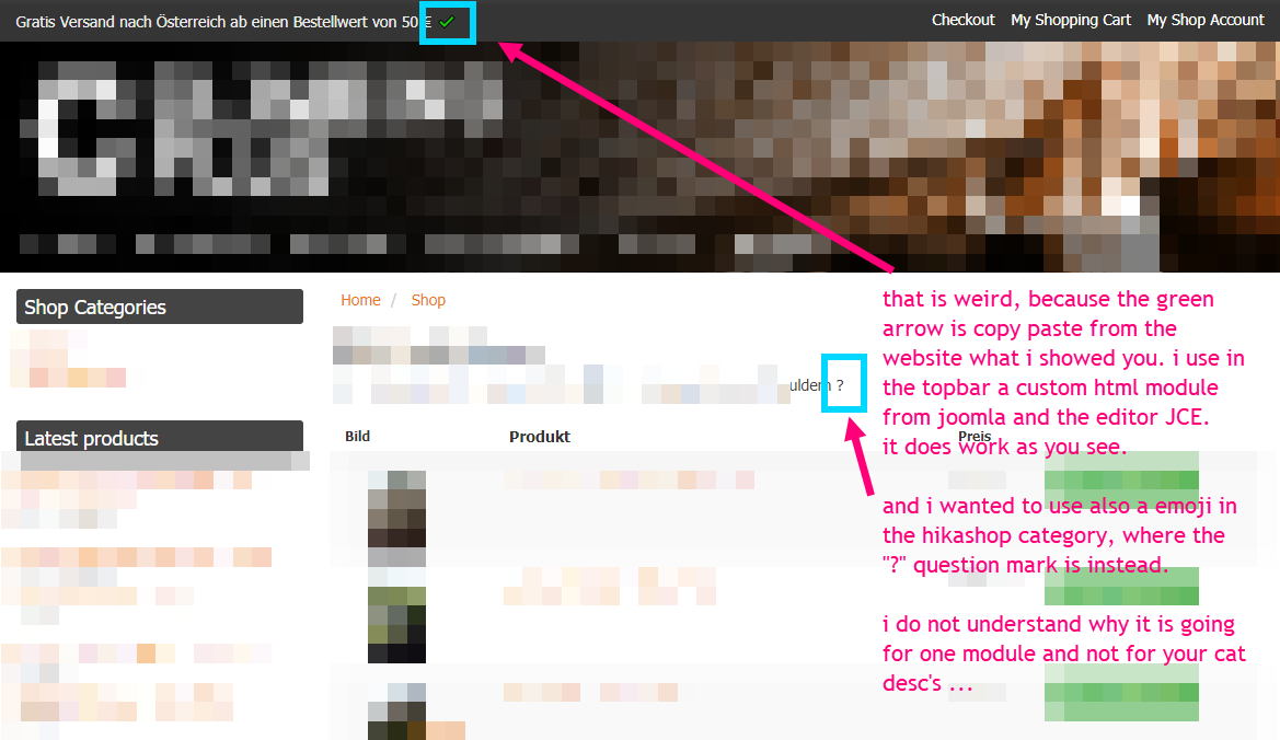

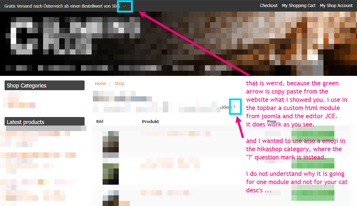

please look in my screenshot:
that is weird, because the green arrow is copy paste from the website what i showed you. i use in the topbar a custom html module from joomla and the editor JCE.
it does work as you see.
and i wanted to use also a emoji in the hikashop category, where the "?" question mark is instead.
i do not understand why it is going for one module and not for your cat desc's ...
