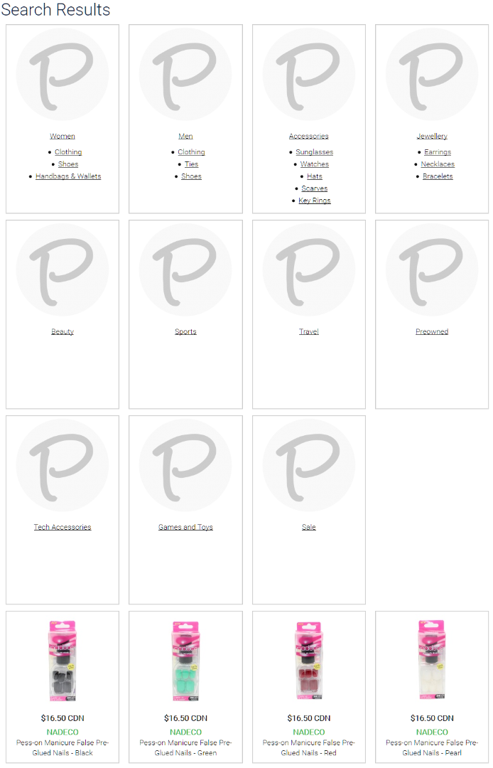

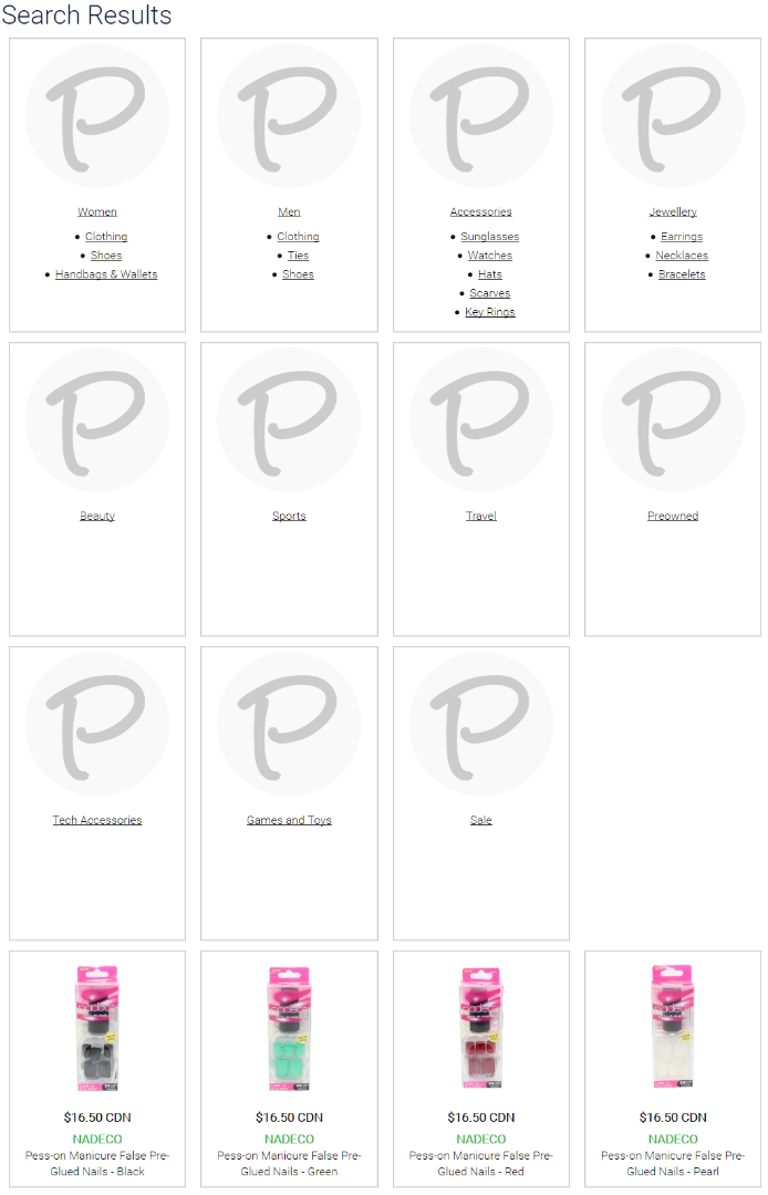

This is so weird - yesterday when I tested the search page it did not show all the categories at the top of the page before showing the search results. Now it's showing all the categories then showing the search results.
How do I remove the categories please? I tried a lot of different settings in the search menu but none seems to fix it. Please see attached.
Thanks!
Thanks!

7 years 8 months ago #304261
by nicolas
Replied by nicolas on topic Change Search Results Page Header From "product category"
That's because the type of the menu item for which you use its id in the menu item id setting of the filter module is "hikashop category listing" instead of "products category listing". Change that in the settings of your menu item via the Joomla menu manager and that should work like you want.
