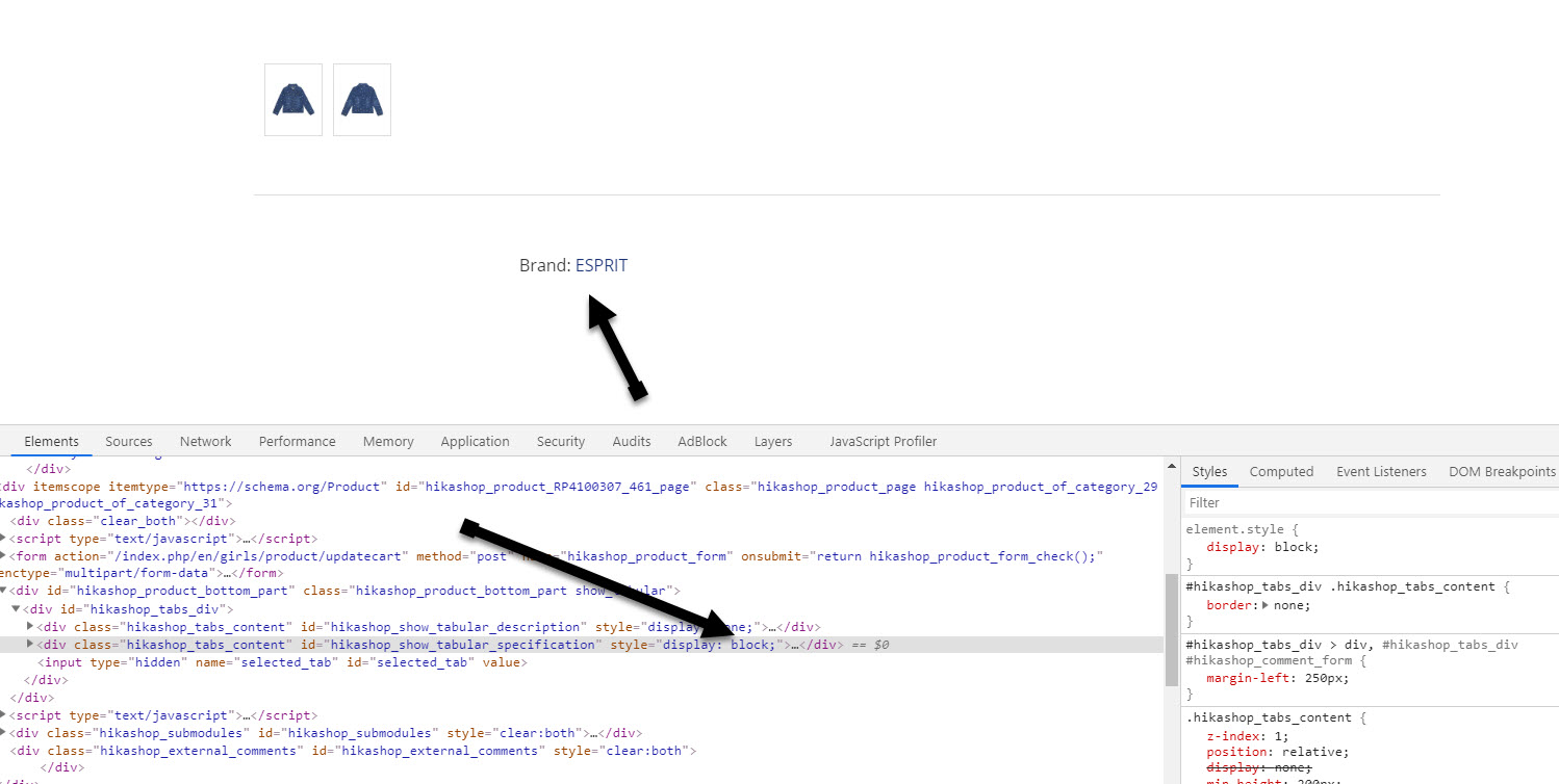

7 years 3 months ago #309420 by Crashbandi
Replied by Crashbandi on topic Not showing Brands
Here is the image they sent me.

7 years 2 months ago #309428 by nicolas
Replied by nicolas on topic Not showing Brands
Well, from what I can understand it should come from the file templates/YOUR_TEMPLATE/html/com_hikashop/product/show_tabular.php which modifies the tabs system incorrectly.
What you can do is to add such CSS on your website to prevent that:
#hikashop_show_tabular_specification{ display:block !important; }

7 years 2 months ago #309435 by Crashbandi
Thanks Nicolas, the css worked.

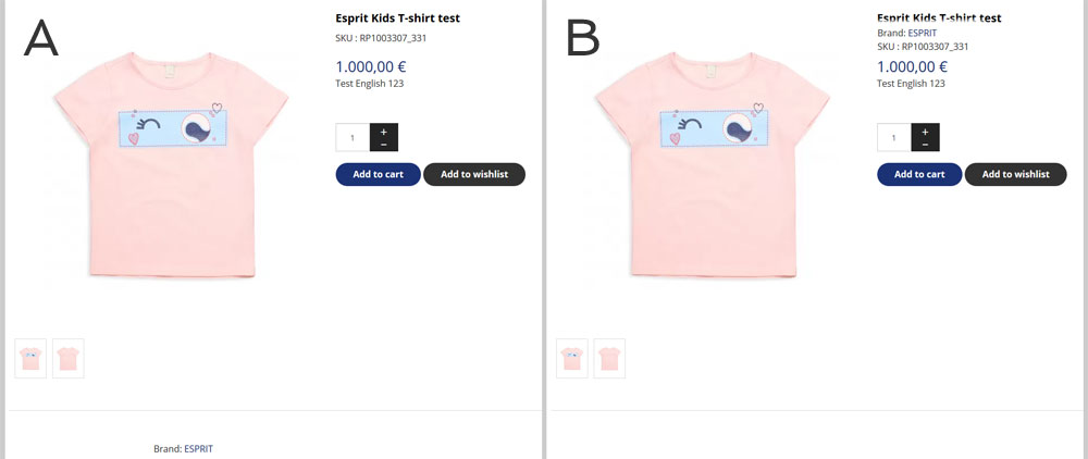

7 years 2 months ago #309472 by Crashbandi
For info an example is HERE
I have attached a screenshot.
'A' is the current view with the Brand at the bottom of the page.
'B' is how I would like it to look with the brand just above the SKU.
Thanks.
Colin.
More
7 years 2 months ago #309476 by Mohamed Thelji
Replied by Mohamed Thelji on topic Not showing Brands
In that case the solution will be to directly edit the "show_default" file of the "product" view of your front-end template via "Hikashop->Display->Views", and move that code where you want it to be displayed :
Code:
<span id="hikashop_product_url_main" class="hikashop_product_url_main"><?php if(!empty($this->element->product_url)) { // DISPLAY the manufacturer echo JText::sprintf('MANUFACTURER_URL', '<a href="' . $this->element->product_url . '" target="_blank">' . $this->element->product_url . '</a>'); } ?> </span>
