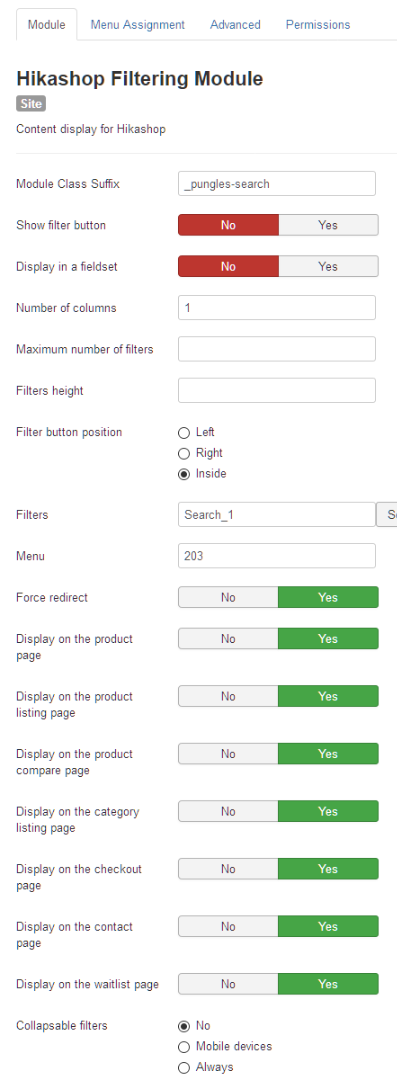

6 years 11 months ago #313835 by nicolas
Please provide a link to a page with the issue along with a screenshot of the settings of your search module.

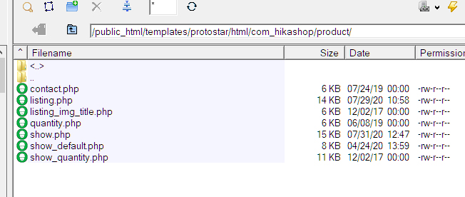

There are two things I can recommend:
- check if you have the file templates/YOUR_TEMPLATE/html/com_hikashop/product/filter.php
If you do, try renaming it in order to deactivate the view override on the filter module.
- update to HikaShop 4.2.2 as it contains several fixes on the filter system which will help with your issue.
6 years 11 months ago #314000 by MyWorld
I do not have a filter.php file here: templates/YOUR_TEMPLATE/html/com_hikashop/product/

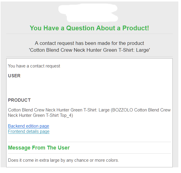

6 years 2 months ago #323939 by MyWorld
So the issue is coming up when the following happens.
I got a contact request email and when I click to view the product on the Front End, it takes me to the product, if I try to use the search it does not work - it's doing the same thing that I indicated in my initial post.
Thanks!

6 years 1 month ago #323966 by nicolas
Can you check if you have the file templates/YOUR_TEMPLATE/html/com_hikashop/product/filter.php ?
If you do, try renaming it and it should help. If you don't, we would need a backend and a FTP access to check on the situation further.
6 years 1 month ago #323978 by MyWorld
I don't have a filter.php. Will send the access info shortly.
