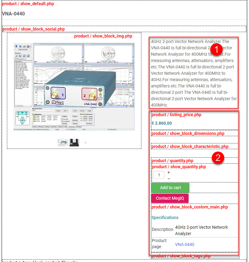

I want to adjust the layout of the product page. See print screens below. For clarity, I also sent a print screen with the php files.
I want to swap the text and possibly the photos from block 2 with those from block 1. So move the description that now is at block 2 upwards and the information from block 1 downwards.
How can I do that the easiest way?

As you can see in your screenshot, the view file which encompass both areas is the "show_default" one. So that's the one you want to edit via the menu Display>Views to do that change.
There, you'll actually see four blocks: top, left, right and bottom :
monosnap.com/file/PLhSfyKYGmiXOhy2Q0xFWuHAHf86bh
So what you want is to locate the divs hikashop_product_right_part and hikashop_product_bottom_part there and swap all the HTML/PHP code inside from one to the other and vice-versa.

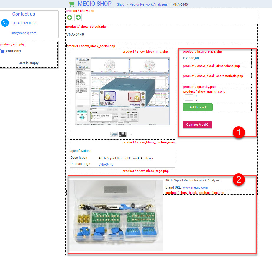

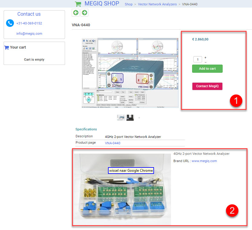

6 years 8 months ago #314554 by mlehr
Replied by mlehr on topic Lay-out product page Hikashop
Thanks.
I did what you recommended, but it's still not quite right. See print screen.
1. This section (description) is going well and is now in the right place.
2. I want to place this part below the image, but it still remains on the right. How can I solve this?
More
6 years 8 months ago #314558 by nicolas
1. Looking at your screenshot, it would look like you moved the description area inside the right area but not the content of the right area to the bottom area.
I tried to look at the situation on your link but it displays differently than what I can see on your screenshot and there is no description displayed anymore so I'm not sure what to say to help you.
2. If you move the code of that piece inside the "bottom" area in show_default, you should be good to go.

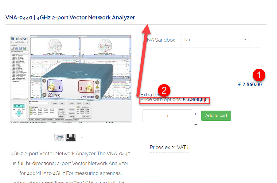

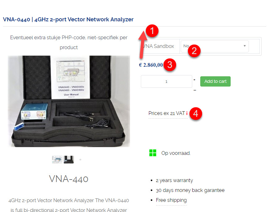

I want to make some changes to the product page.
See print screen. See also nieuw.megiq.com/shop/vector-network-analyzers/vna-0440
1. Number 3 shows the price with options. I would like to put it above the options (at number 2), so at position at number 1. How should I do that?
2. I want to put a piece of text next to the price, including a tool tip with additional explanation. The part that is currently at number 4.
Is that possible? How do I do that?

6 years 8 months ago #314978 by nicolas
1. You'll want to edit the product / show_default.php view file via the menu Display>Views and move the blocks of code involved around:
monosnap.com/file/nB9xxDIKP7rhCdTepg1w2umLHVyTpf
2. To add some text after the price, just edit the file product / listing_price.php as philippe proposed and add your text at the end.

6 years 8 months ago - 6 years 8 months ago #315024 by Philip
The price with option is in the product/show-default view (html class "hikashop_product_price_with_options_main"), you have to move it immediately below the "show_block_social".
Last edit: 6 years 8 months ago by Philip.
