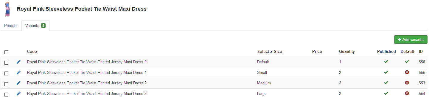

I'm in a bit of a pickle and I'm not sure how to fix it.
Say I have a Small, Medium and Large item.
If the Small is SOLD OUT, when the customer goes to the page, they see the SOLD OUT message without clicking on "Small". This is deceiving as it appears that all of that product is sold out. Please see the URL added in this post.
So what I usually do is create a default variant and add it as the first one, then use CSS to hide it to get rid of the issue stated above. See example attach.
If the user goes to the page and click "Add to Cart" without selecting a size, the DEFAULT variant is added to the cart.
How can I avoid getting the DEFAULT/(Hidden) variant added to the cart?
Thanks!

6 years 2 months ago - 6 years 2 months ago #323070 by Philip
Everything is worked as expected, products that pre-selected a variant are just product which you didn't create a "select size/default" variants and define it as the default HikaShop default variant.
image missing https://i.imgur.com/B6dcr0J.png
Note : Click to see picture details.
See the result in your product page, here
You have just to reproduce this idea for all your product.
Last edit: 6 years 2 months ago by Philip.

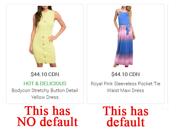

6 years 2 months ago #323136 by MyWorld
I disagree. Unless I'm misunderstanding what you are saying.
If you look again at the 2 URLs that I sent in the email I explained that one has a default, like the example you provided above, and one does not. Yet the button is hidden for both of them on the details page.
I attached a photo of the two products for your information. Their URLs were sent in the email.
I would much prefer the option to NOT have to add a default.
Thanks!

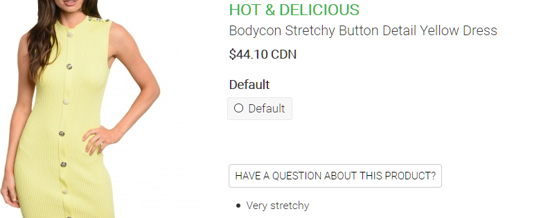

6 years 2 months ago #323197 by MyWorld
Sorry I created another characteristic and name it "Default" so that it's obvious as to what it's for. The other one that I was using was just to test.
Regarding Nicolas' solution below, how do I get the default characteristic to be selected automatically, so that the 2nd characteristic will show? As you can see, as per the attached image, it's not selected.
www.hikashop.com/forum/feature-request/9...-variant.html#322632
