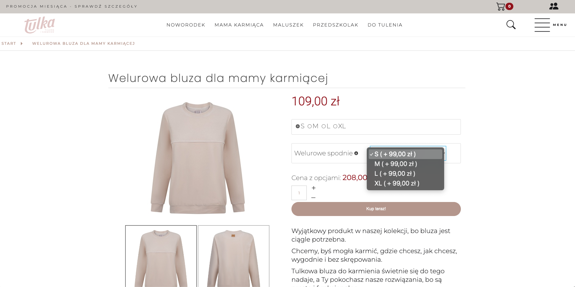

I have a product that has a different product option, but this product has different sizes.
I have the option to choose an optional product, but there is no option to opt out. There is no position no.
How to configure it so that it is possible to buy only the main product without options.
Tomek
-- Joomla version -- : 4.2.6
-- PHP version -- : 7.4
Tomek
