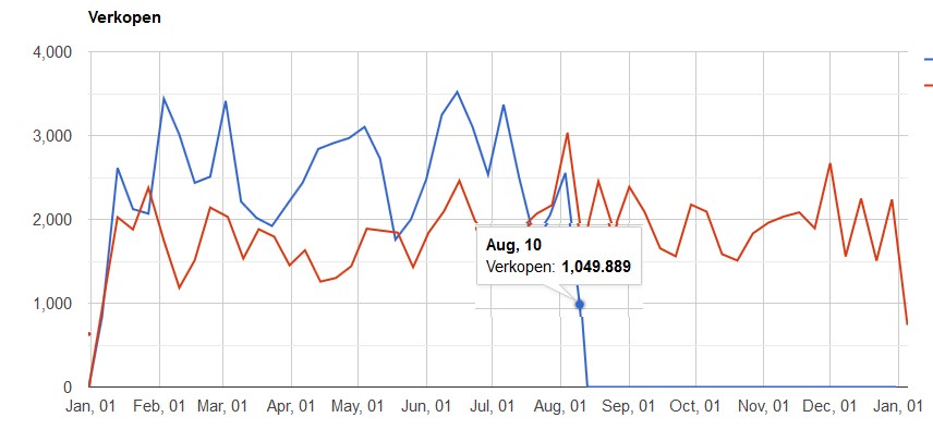

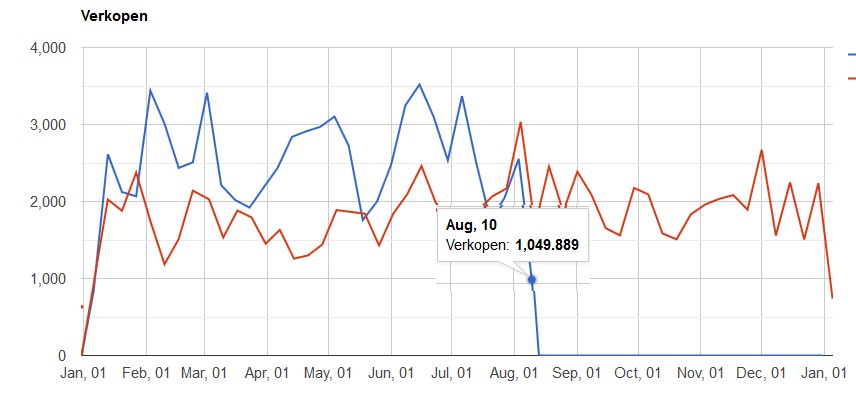

In screenshot 1 the items are grouped per week.
The X-axis displays the correct dates: Jan 01 unto Jan 01.
An example of the statistics: on Aug. 10 the sales of the previous week are displayed.

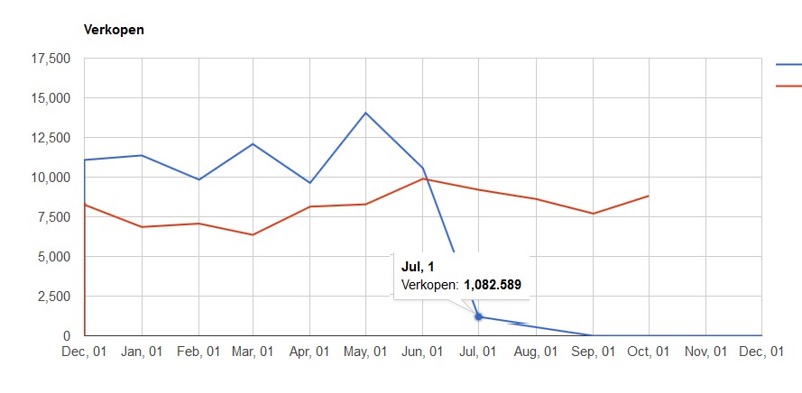

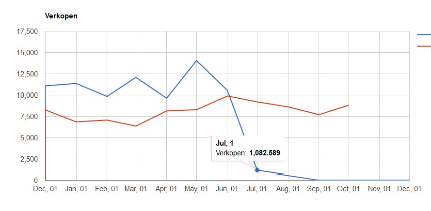

In screenshot 2 the items are grouped per month Start date and end date are unchanged.
Now the dates on the X-axis haven been moved forward a month: Dec. 01 untill Dec. 01
Remarkable: on Jul. 1 the sales of August are displayed., on Jun. 1 the sales of July and so on.
This is very confusing and incorrect.

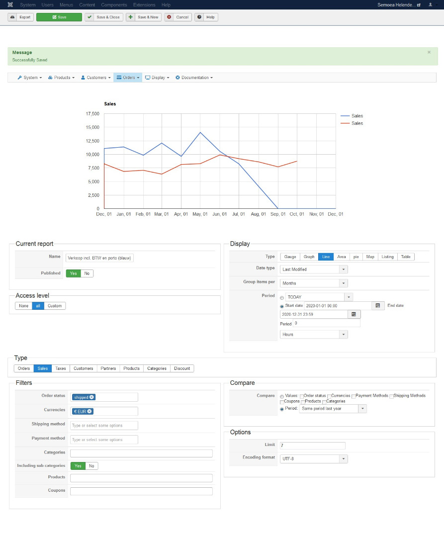

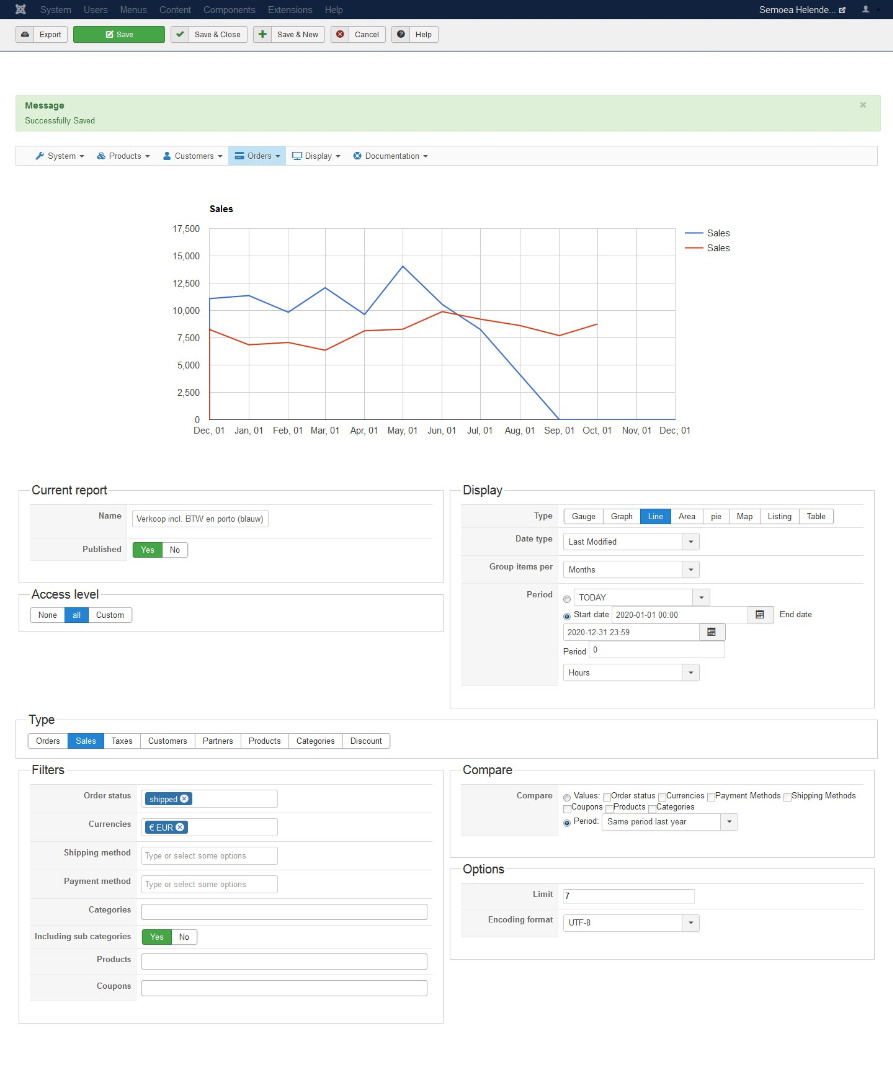

6 years 1 month ago #323358 by Udo
Attached is a screenshot of the configuration of the monthly sales report.
Before updating to Hikashop 4.3.0 I used the columns display type. That was working fine.
Alas that display type is removed.
Udo
