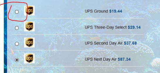

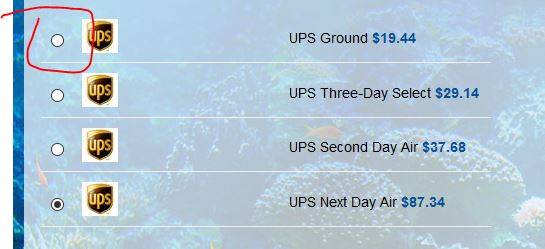

Hi Mohamed,
Trying to accomplish the same thing as p3.chuck but the file shipping.php no longer has the lines that indicate where to put the code changes. How can I sort the UPS services and have the lowest price selected as default?
