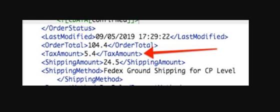

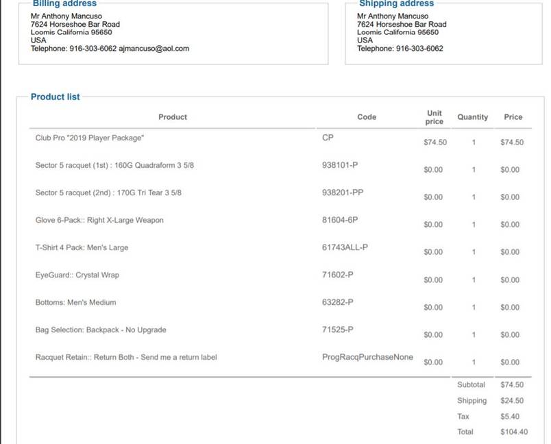

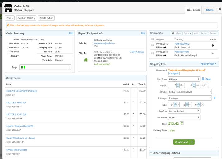

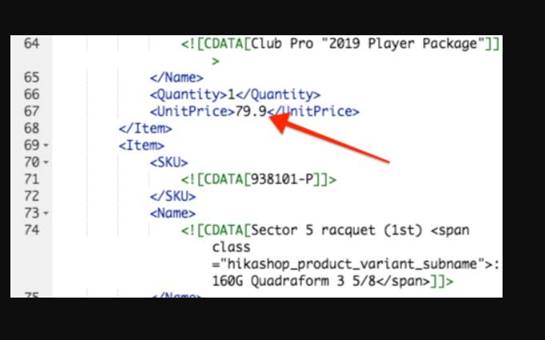

7 years 2 months ago - 7 years 2 months ago #310828
by andrewHS
Replied by andrewHS on topic shipstation plugin causes order details page to go blank
Hi Nicholas,
I did leave a nice review for you.
This just came in so I'm not sure if its the pluging code or Shipstation themselves. Local state tax is used for products shipped in state.
It seems tax is being added to a product then exported to Shipstation as the product cost then tax is exported again in effect causing double taxation for each order. The attached Shipstation page was for an order that was $74.50 and you can see how the price is exported as $79.90 and then tax is added again The other attachments are code grabs from the guys at Shipstation pointing out where they think the issue is.
Last edit: 7 years 2 months ago by andrewHS. Reason: added extra code snippets
7 years 2 months ago #310841
by nicolas
Replied by nicolas on topic shipstation plugin causes order details page to go blank
Well, the documentation on their end doesn't specify if the price sent should be taxed or not:
shipstation.docs.apiary.io/#reference/model-order
Now, if you want to change that, change the line:
<UnitPrice>' .((float) $product_price + (float)$product_tax) . '</UnitPrice>
to:
<UnitPrice>' .((float) $product_price) . '</UnitPrice>
and the line:
<OrderTotal>' . round($order->order_full_price, 2) . '</OrderTotal>'.
to:
<OrderTotal>' . round($order->order_full_price-$taxes_calculation, 2) . '</OrderTotal>'.
in the file plugins/system/shipstation/shipstation.php
Let us know how it goes so that we can add these changes for future versions of the plugin.
