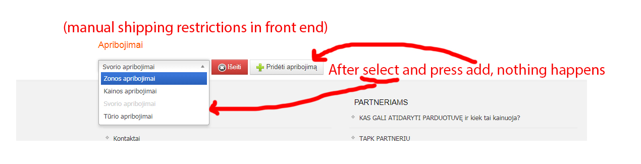

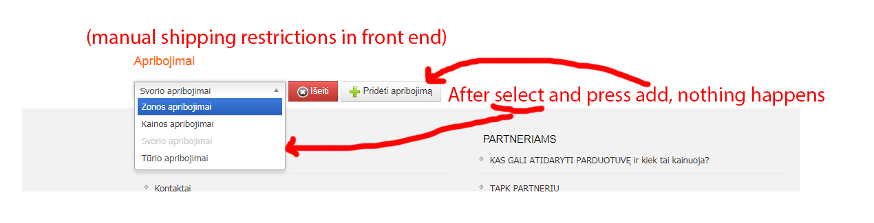

-- HikaShop version -- : 4.1.0
-- Joomla version -- : 3.9.12
-- PHP version -- : 7.2
Something changed after hikashop update to 4.1.0 version(before that was the last version of hikashop and all was ok).
In front end vendor can add manual shipping methods with restrictions (weight, price, country). Now when press add restriction and choose from drop-down list (sample weight) --> press add --> and get nothing (but should get extra fields where you enter restrictions) -Nothing appear. So vendor in front end can not add restrictions.
Could you please help me with this.

6 years 11 months ago #312878
by Jerome
Replied by Jerome on topic Hikashop manual shipping method d'not allow to add restrictions in front end
Since the shipping edition in the front-end is handle by HikaMarket, it is very strange that the HikaShop update touch something in HikaMarket view.
But you can still take a look at your browser console to see if you do have some javascript errors.
And you can also provide the details about your HikaMarket version number.

5 years 11 months ago #326671
by SEKME
Replied by SEKME on topic Hikashop manual shipping method d'not allow to add restrictions in front end
Hi Jerome,
I did testing on demo....demo is all good, it allow to add restrictions.
I just know, that I did not make any changes on my site to this function, ...or related to manual shipping.
Please take a look here how it looks -- www.youtube.com/watch?v=hEV97DZZDOw
how could I fix this
Thank you
Thank you
5 years 10 months ago #326742
by Jerome
Please check that you do not have a view override for that HikaMarket view (pluginmarket / form)
Please also check that you're up to date.
The icons we can see are the old ones (we can see the green "+").
In the demo website, which is using the latest version without overrides, the icons in the buttons are from "fontawsome", like the new designed from HikaShop 4.
