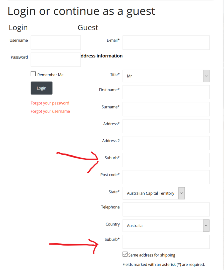

Testing it by logging in as a guest. With the address details that you need to fill out, at the very bottom after Country field, it puts the Suburb field in again. Would this be the custom field that this plugin has or are you talking about that custom field being in the admin site.
I am wondering then why the suburb field is appearing twice on the guest login form?

I'm not sure what you mean. There should only be one address_suburb field of the table "address". And the registration / guest form will display the address fields only twice each: one for the billing address and one for the shipping address (if shipping is necessary).

EDIT: Disregard the additional suburb field - was a custom field - but not sure why I had one in for a second suburb.
Removing it didn't help the Sendle plugin work. And not heard back from developer yet.

I think that the issue is that you change the name of the address_street custom field to "Suburb" instead of "Street" in the Display>Custom fields menu.
Now maybe you don't need that field. In that case, you could disable it.
