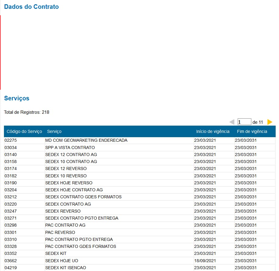

4 years 4 months ago - 4 years 4 months ago #341507
by carnette
Replied by carnette on topic correios shipping plugin
Attached are the NEW Brazilian Postal Codes.
Go to the folder where the PLUGIN(/plugins/hikashopshipping/correios) is installed, edit the files "correios.php" and "correios_configuration.php" and REMOVE the CODES that are no longer valid.
KEEP only the PAC(41106) and SEDEX(40010) code, as they are still valid.
And put the new CONTRACT codes.
Updating PLUGIN
Updating PLUGIN
